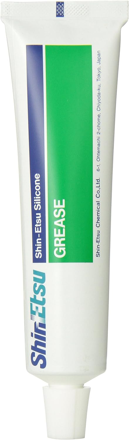

I have Shin etsu grease, but the application takes forever. Im thinking of buying the easier Gummi Pflegde, Sonax, or 303 rubber protectant. Probably going to be applying them yearly. Is shin etsu substantially longer lasting?

Had not seen the Honda/ShinEtsu grease before. Just ordered a tube! My sunroof is getting pretty loud and I've otherwise been at a loss as to how to rejuvenate the seal, outside of spending $500-600 on new glass with a seal. Hopefully the grease and some wire or another bike tube shoved in the seal will work.

I use the Gummi Pflegde and application is pretty darn easy as long as there is clearance for the bottle/applicator sponge. This thread reminds me I should do another round on all the vehicles and camper.
