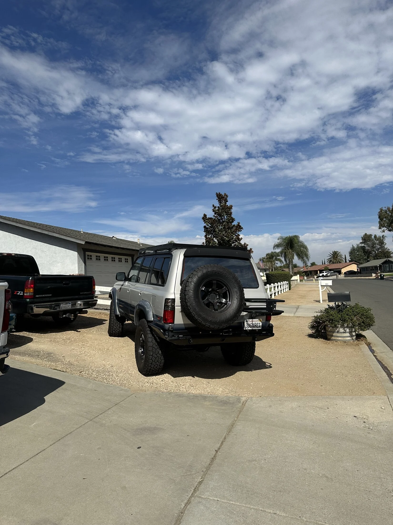

Pics of my rig.

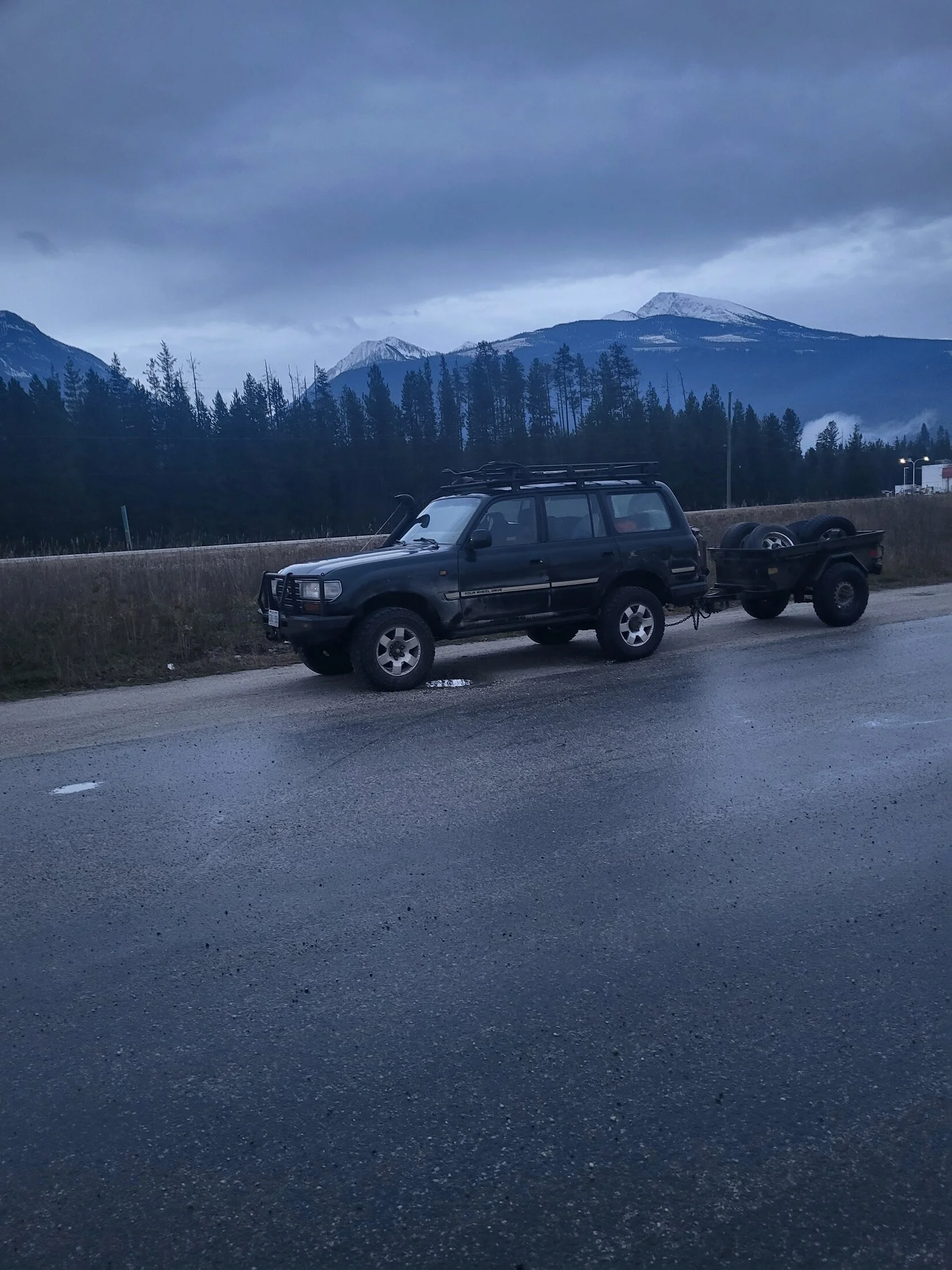

Just drove my hdj80 Sudbury Ontario to Whistler BC towing my M101 trailer.
Unless you have beat and or neglected maintenance I wouldn't worry.
Only difference is mine is a diesel 5speed.
