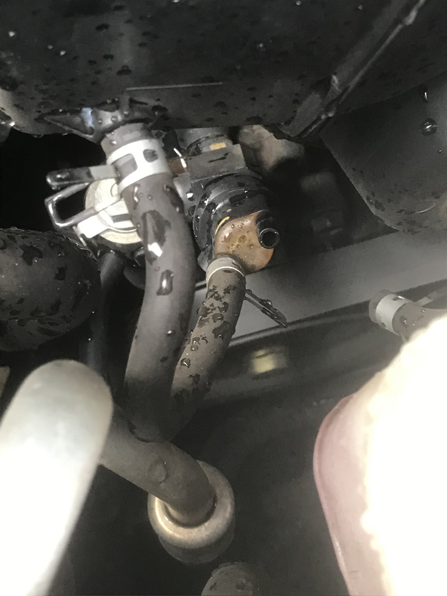

I took the MAF out of my wife’s 2008 and put it in my 2006 (which is the one with the CEL) and been letting it idle for about 20 minutes and so far no CEL…so hoping the MAF is the issue.
Well, this probably wasn’t helping. 😂
