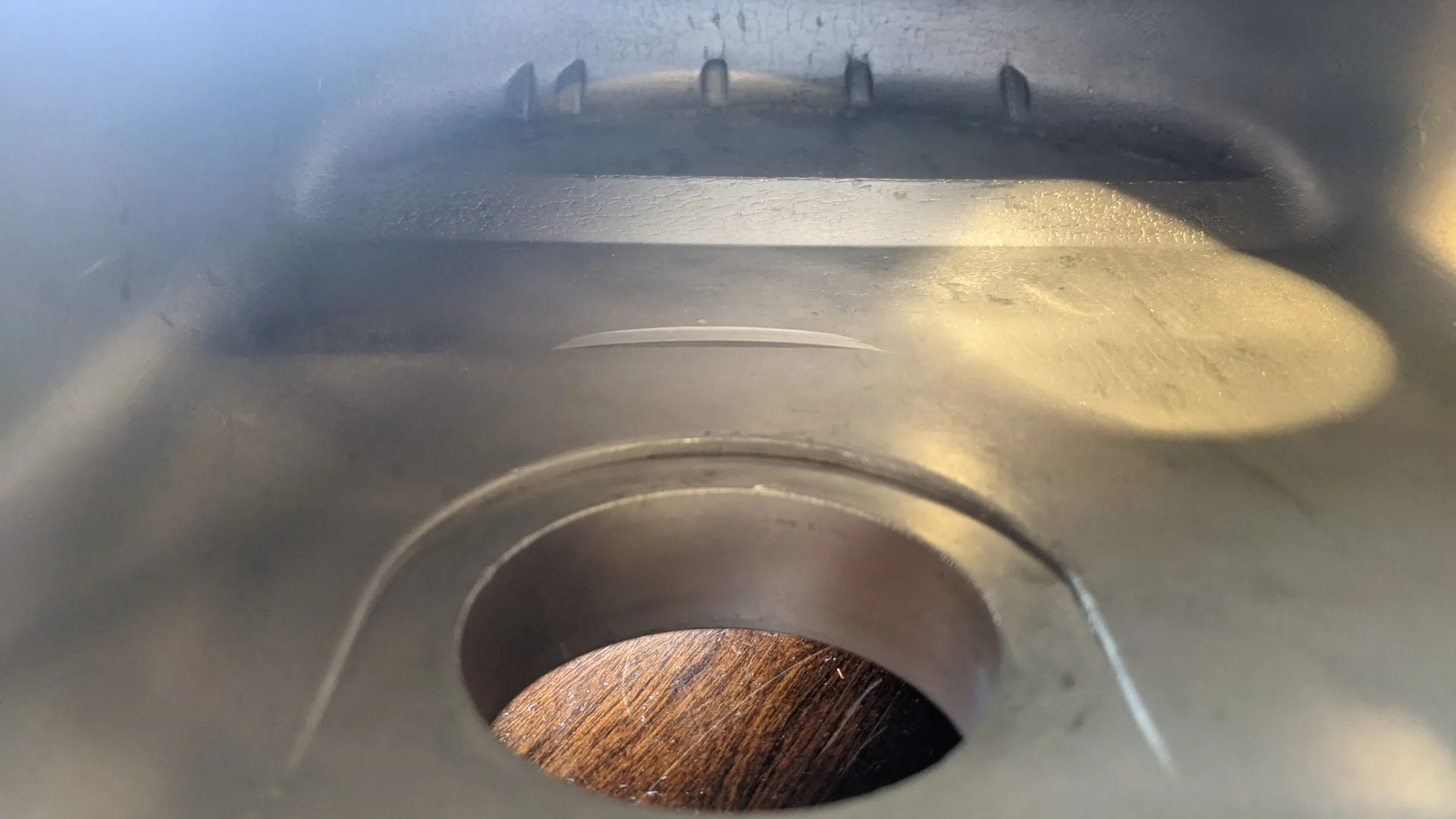

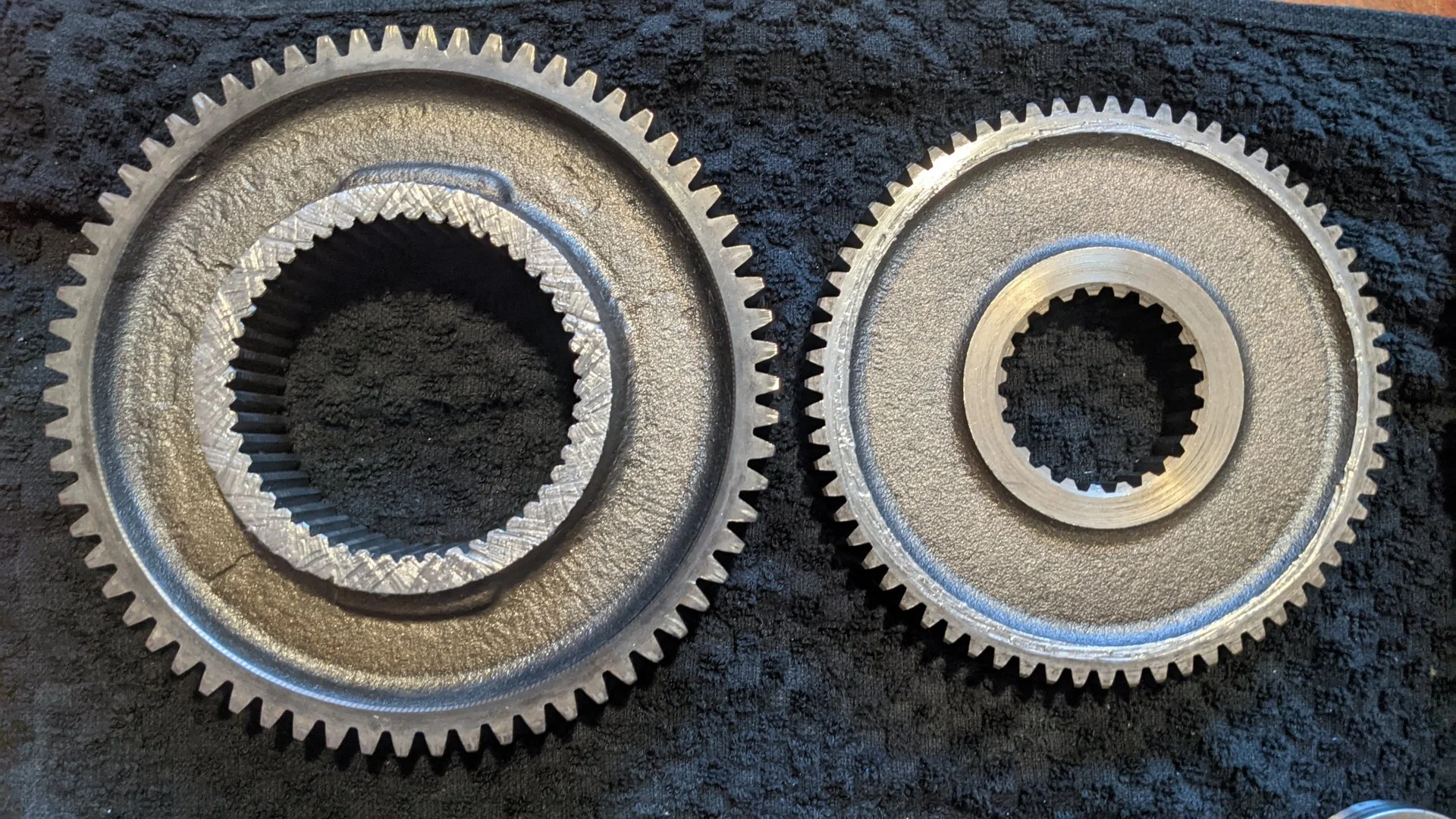

I'm in the middle of rebuilding an M8274, definitely an older one but it appears to be in great shape overall.
However, on the main and intermediate gears, I noticed some unusual wear and marring. I'm wondering if maybe a spacer was missing previously, or if anyone has seen anything like this. I don't see anything broken off on any of the internal parts.
Additionally, the intermediate gear has worn a bit into the casing as seen in my initial post.
I'm thinking I may smooth out the damage on the edge of the gears and call it a day, but still curious what the group would think.
It's been some years since I rebuilt mine, but as I recall there is supposed to be a thrust washer there. You can still buy parts for these from a Warn dealer; if I were you I would get the "Lower housing service kit", Warn part # 8680 which should include the thrust washer.
These things are rugged and not rocket science/brain surgery; I would re-run your gears and case without a second thought, after replacing the bushings and the thrust washer.

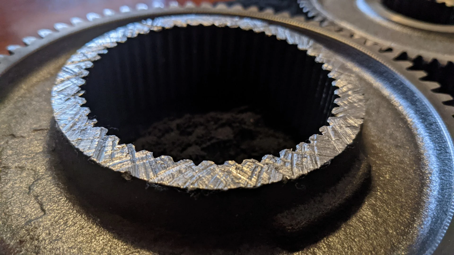

That last pic, the big gear with crosspatch wear looks to be a factory blunder and should have never been installed but tossed...I cant see how forward and reverse motion could cause this type of wear..

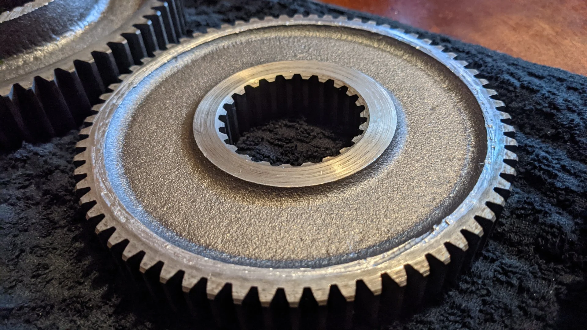

@woodsman 44, I think you aren't far from the truth. I actually think the smaller gear has the factory defect, and when they bump against each other, if the defect is in play, the small gear takes a bite out of the big one. Hence the spiral crosshatch pattern on the big gear. You can see the track cut into the small gear on the bottom right corner of the photo of the it.
The funny thing is, the winch very clearly hasn't even been run very much. All the bearings and surfaces show only minimal wear and basically no damage. I really think it was a manufacturing defect on the small gear. Lucky for me, the PO didn't keep running it.
I ended up taking the gears to a machine shop to clean those two surfaces up. I get the feeling the track on that small gear would just keep chewing the big gear forever. It probably wouldn't create much trouble, but I figure it'll probably last forever if I clean the gears up a bit.

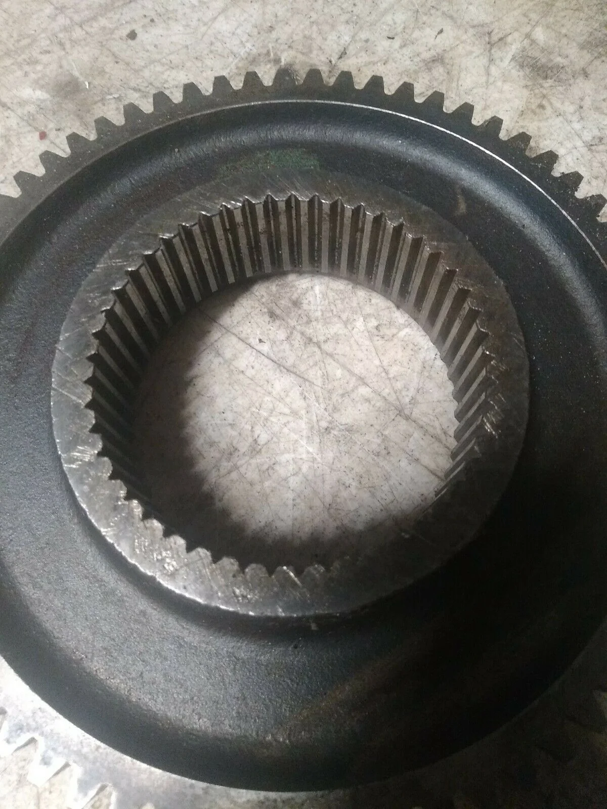

I found this pic of someone else's main gear. You can see the same crosshatch pattern, just not nearly as pronounced. It seems to me that any defect in the contacting area on the small gear would result in my situation.
