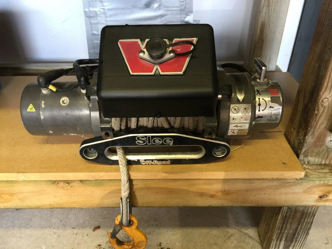

I acquired this winch in non working condition. It didn't come with a controller so I purchased one online through a Warn parts place. The problem is it doesn't work. I've been online, tried some informative YouTube videos but it still doesn't work. Any thought?

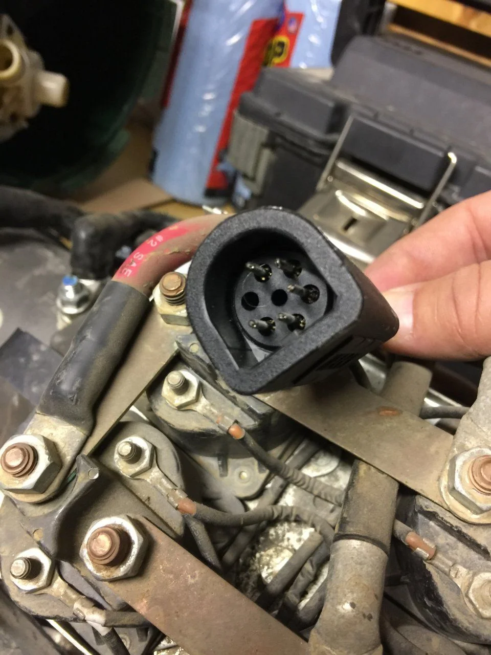

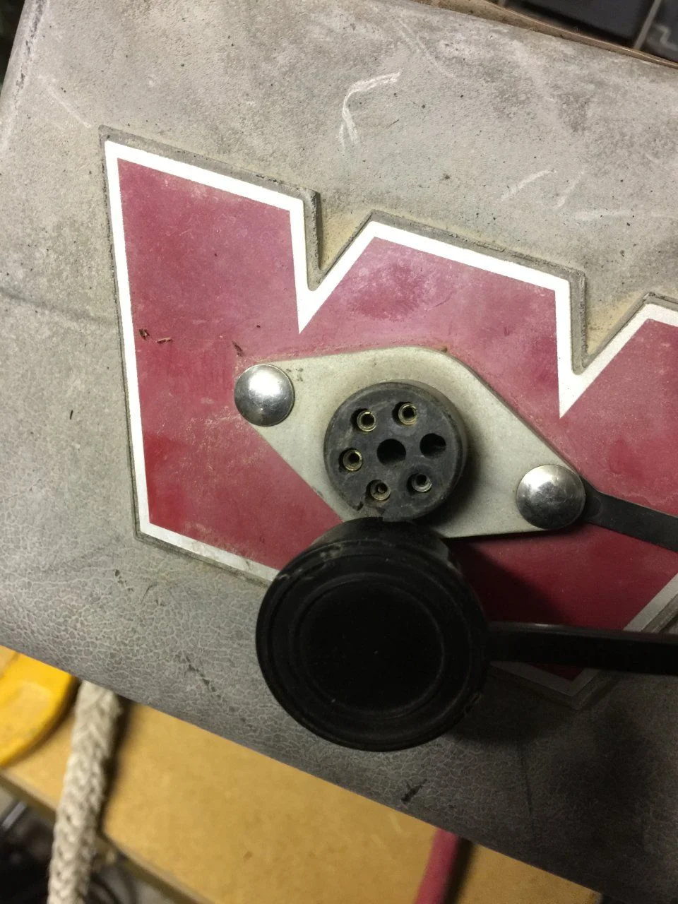

That controller connector looks like it has 5 pins? I think the M8000 should
only use 4 pins. Go to Warn.com and get a wiring diagram for the controller. Is the
controller a 5 pin controller? Different generations have different controllers. Quick look,
that's where I would start.
