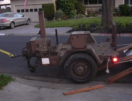

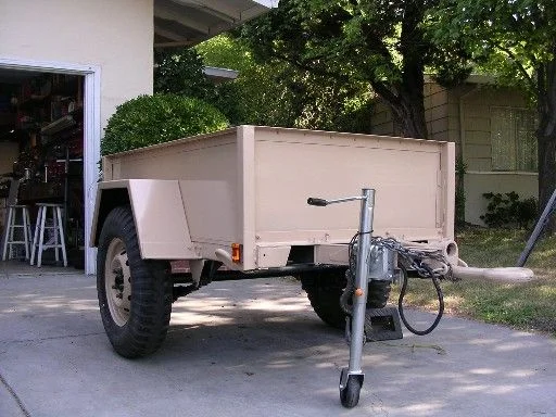

Pics of the original trailer on day 1 and our initial configuration for cargo carry approx 5 years ago

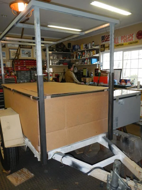

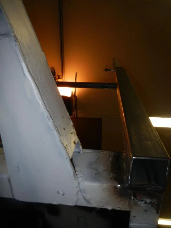

First step was to remove current cargo box and determine new cargo requirements. Height of container was dictated by refrigerator and kitchen designs.

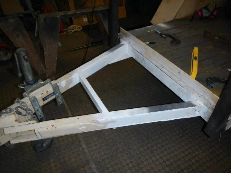

Tongue to wheel length was also increased to provide better handling, especially backing.
I disconnected the tongue from the frame, mitered the ends to square and added 2x3 box steel. I then gusseted the assembly to strengthen.

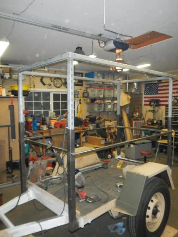

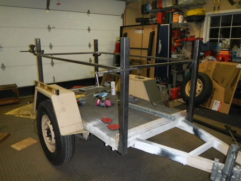

Once the box height was decided I framed in the box with 2" square tube on corners and 1" sq tube for rails
My military tube type tires were dry rotting, so replaced them with e rated all season light truck tires.
The fun continues

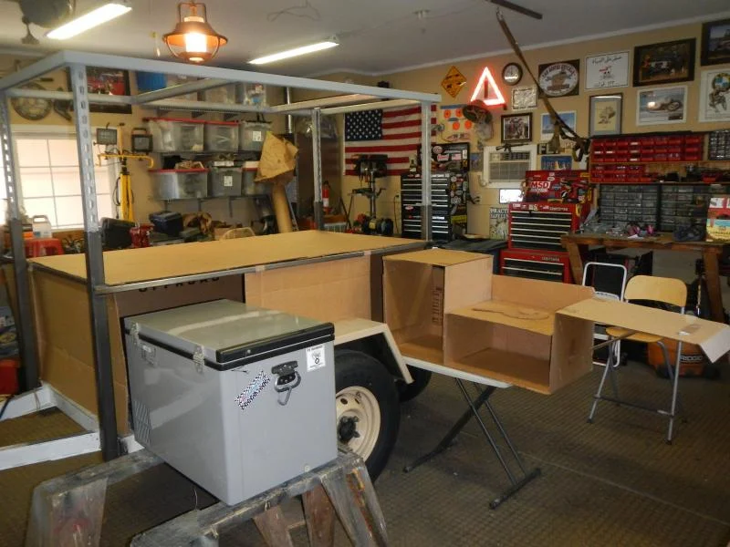

Next we continued the framing, and mocked up a kitchen/shelter setup. I built the shelter frame of uni-strut that moved freely inside the 2" tube. Based on the Aussie design, I wanted the shelter to be elevated for camping and lower for travel.
More testing

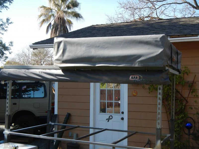

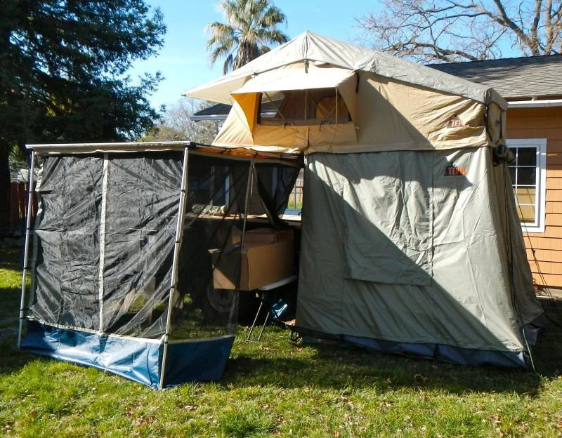

We purchased an ARB awning and a Tepui Autana tent. Both fantastic products. The awning will provide shelter over the kitchen and the tent will provide living/sleeping space for 4+.

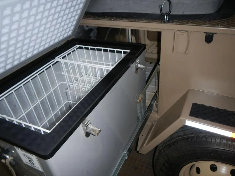

Kitchen and Refrigerator

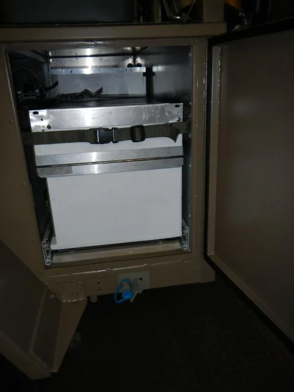

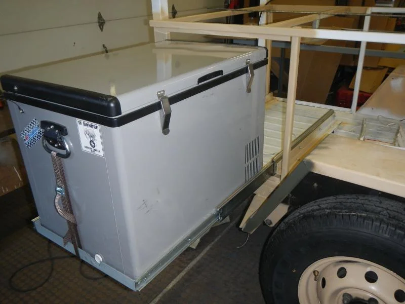

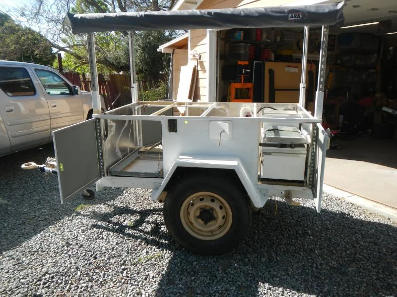

We built custom slides for both the refrigerator and kitchen and fitted into the trailer. I then used 16 ga. aluminum for paneling the cargo box.

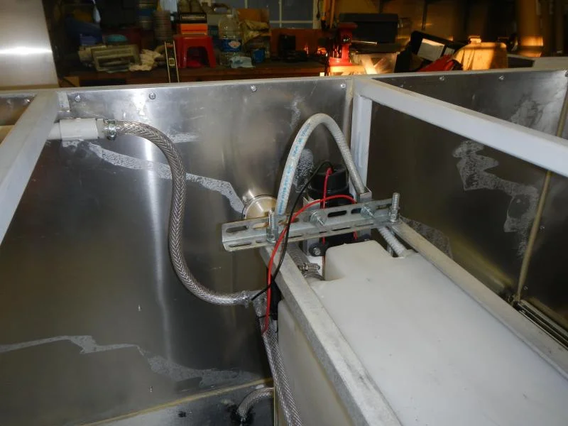

I installed a 20 gallon water tank with pump for fresh water.
Getting closer

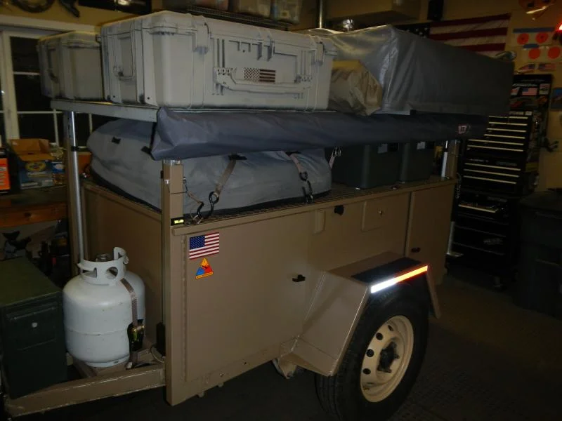

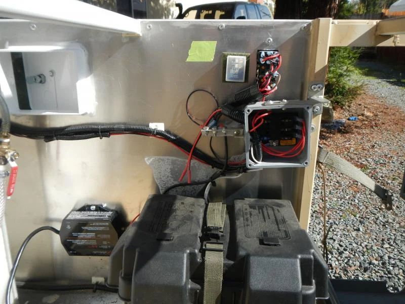

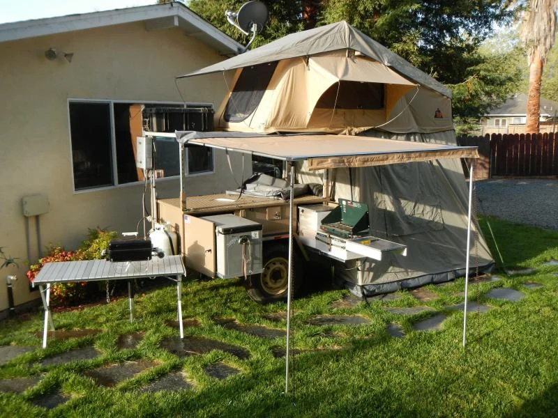

Here are the kitchen and refrigerator in final configuration. The kitchen is plywood and designed to fold into its storage space. I also added a deep cycle battery for water and power. I framed doors with 3/4" tube and covered with same aluminum sheet.
I found standard RV access door and water fill and used exterior grade electrical cover for switches.

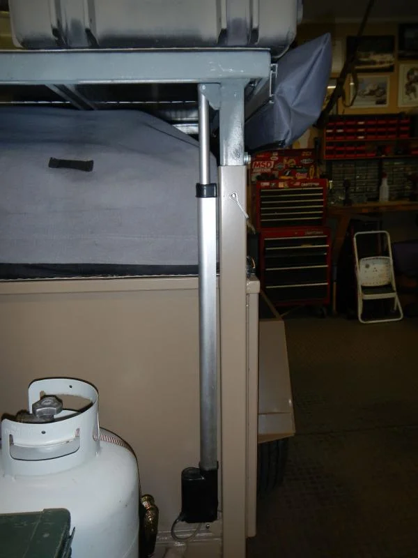

Also you can see the electric actuators installed. These handle 200# each and are controlled from one switch. They raise the shelter 24" once we are at camp.

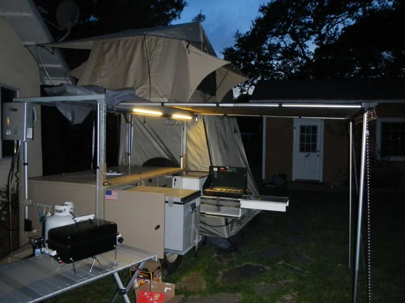

Test set up

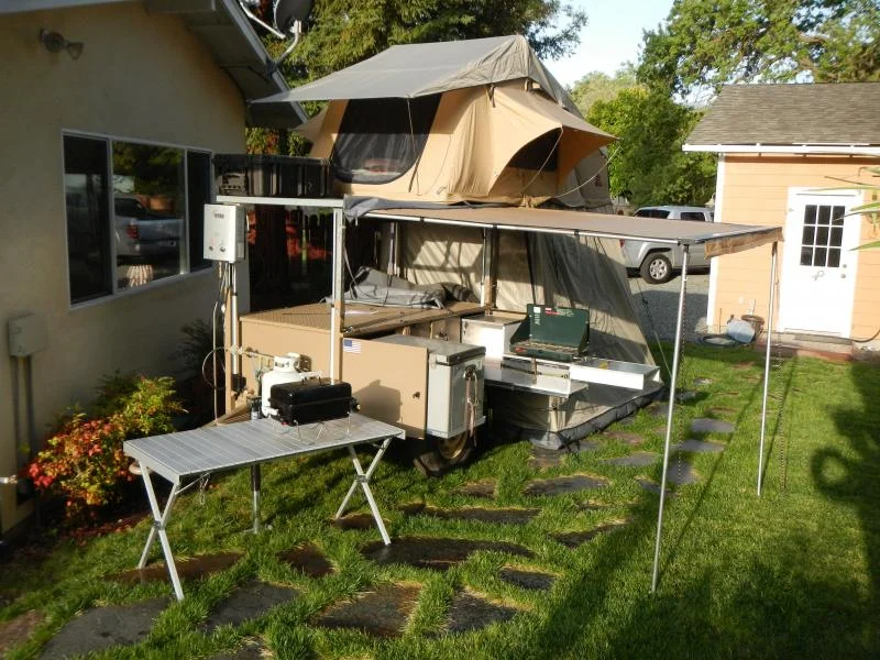

Once in a moderately finished state we set up the trailer to see how it works. Details include LED lighting under awning and inside tent; stability jacks on tongue and rear corners; kitchen sprayer for cooking area; LP gas quick disconnects at kitchen for stove and at front for bbq and hot water.

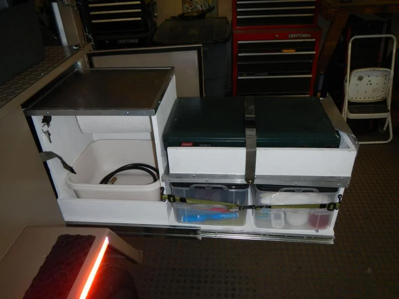

This is the kitchen. Made of 1/2" ply with 40" drawer slides and sheet aluminum counter tops. The stove nests inside the wing and straps for security. The kitchen straps into the trailer as well.
Detail Pictures, cont.

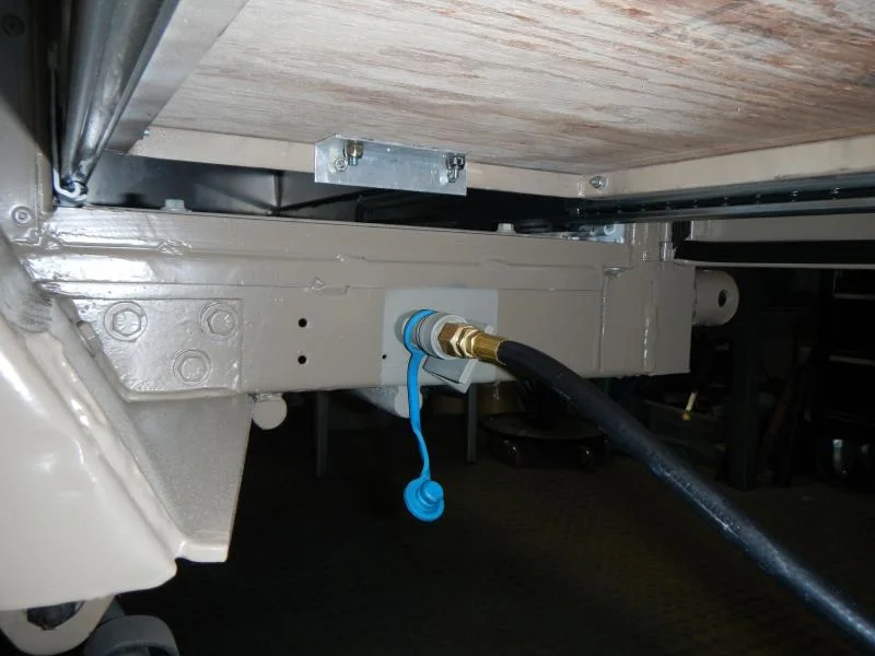

Here is the LP gas quick disconnect. Need to use high pressure as stove/bbq don't like a low pressure regulator.

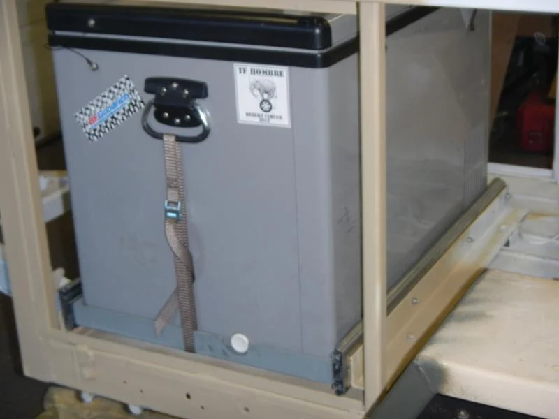

Also details of refrigerator with pin/strap restraint. Used a 32" drawer slide for this.
Details...

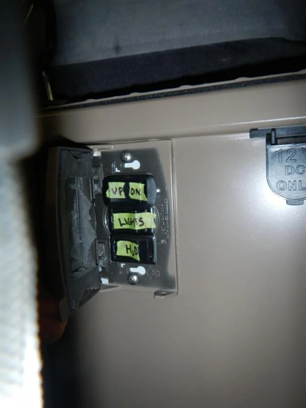

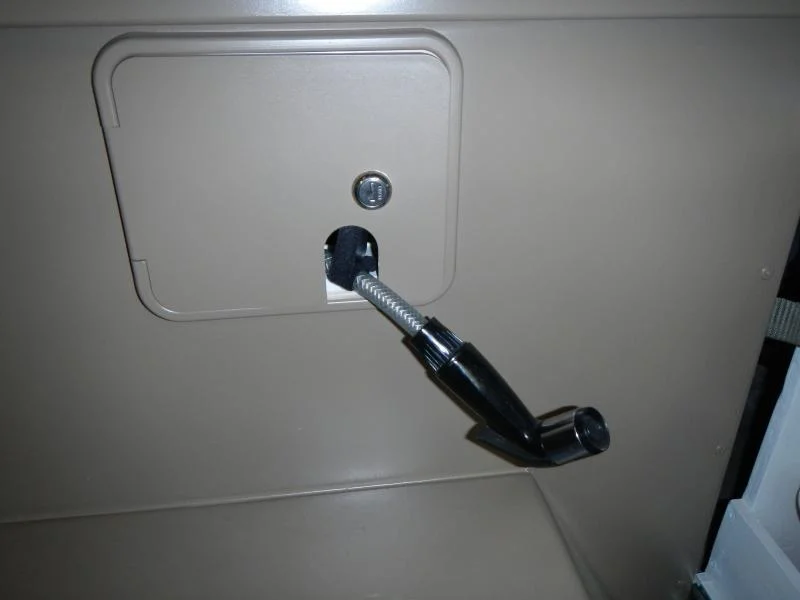

I used a kitchen sprayer fed from the water pump. Provides fresh water to the kitchen. Also, switch panel is weather proof residential cover. It works with 3 rocker switches with a bit of dremel work. The switches control the actuators for the tent platform, LED lighting under awning for kitchen and the water pump.
Finally is a shot of one of the actuators. Rated at 200# each, they have no problem raising/lowering the platform, even if we had people up top.

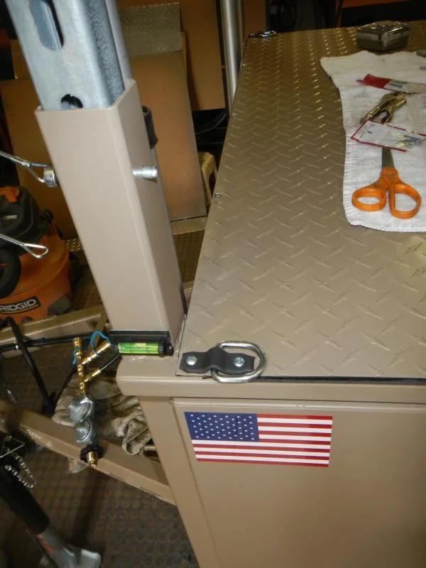

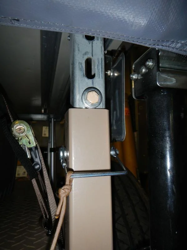

I used safety pins for legs of platform, they lock legs in up or down position (figured it would reduce stress on actuators off road or while camped). The unistrut slides smoothly inside the 2" square tube. I used paraffin to lube the unistrut.

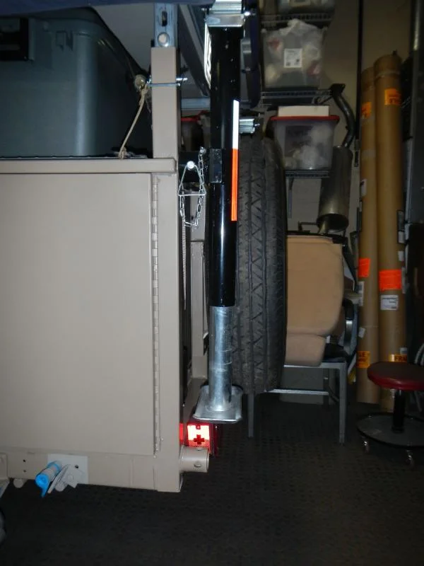

Trailer jacks in rear are pinned so I can put them up out of the way for transport. Note mounting point below foot of jack.

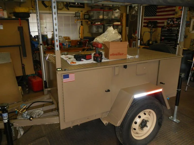

I also covered the tent platform with diamond plate aluminum for a little shelter and mounted old pelican cases for storage. Under platform I mounted a roof top cargo bag to hold cots, chairs, etc. and two Plano gear boxes to hold the rest of the kitchen gear. The mandatory ammo can on tongue holds chocks, jack handles, locks, hitch, etc.
