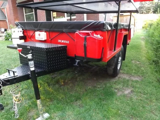

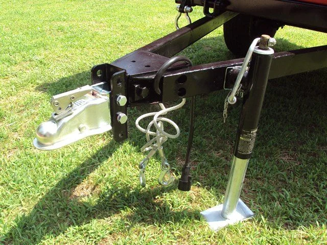

Just get a crank up jack from a trailer store or Harbor Freight.
Weld on the mounting ring and you are good to go.
It is much easier than the original folding landing leg.
This is how I did mine.

Thanks for the pics. I will probably go that way, I dont care if it's military or not, just functional as I am tired of manually lifting it. I do have the bows/top so its pretty cool.
