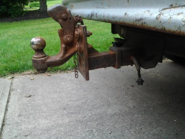

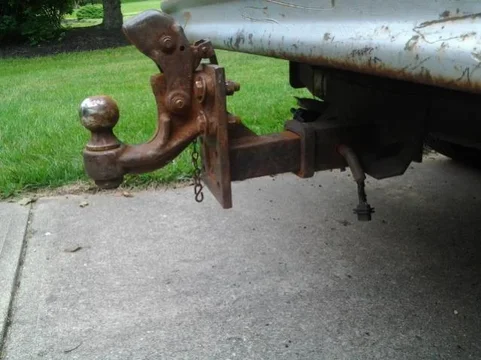

I love this trailer. I loaded it up with firewood (likely more than I should have) and it handled it without a problem. The surge brakes worked perfectly and I also pulled all of the wiring out and redid it to a 4 way. My biggest issue is the safety chains are too short. Do they have to go back to the frame hitch or can I make a mount off of my receiver?
It should go to the piece bolted to the frame, just in case the pintle hitch fails. That's a problem everybody has, the chains are too short. They are good chain and hooks, so some like to leave and add to it. Some remove and put on new chain or cable. :meh:
Sounds like you're not using the 4-bolt mount in the bumper? There's something called a "chain plate" that is mounted sandwiched between the mounting point and the pintle hitch that is used to hook-up the chains when using the pintle to tow. You could get one of those and bolt it by itself to the bumper as a quick way to get chain-up points.
