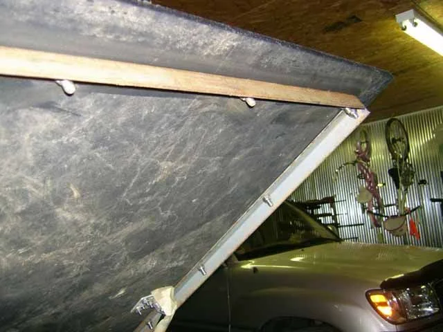

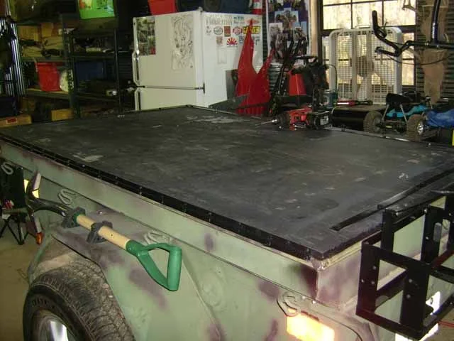

The plastic roof is easy to work with, but it has some flaws. One suck flaw is that it is not as rigid as aluminum or steel.
What I did to stiffen it up on the 3 non-supported sides was to sandwich the plastic between some 1X1 angle iron on the bottom and 1" strap on the top. This really was nice and it was much easier than welding a metal frame together.
I have plenty of room for weather stripping and plan on using it for sure.

As for warpage, the angle iron should keep that from happening. If not, I will just need to add another row of angle lenghtwise between the shock mounts.

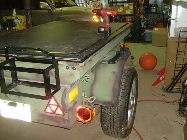

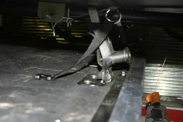

Small tip: the angle of the gas shock install can make a real difference in the lifting
Sure, every degree off vertical and they are less effective, just like a shock on a car.
That said if I can just get the shocks I have to hold up the load when it is open and help me with picking up the top with the tent on it, that will be fine.
I like the way the shocks are out of the way on mine, that is why I put them there.
I may have to move them.

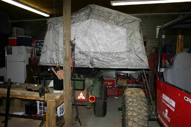

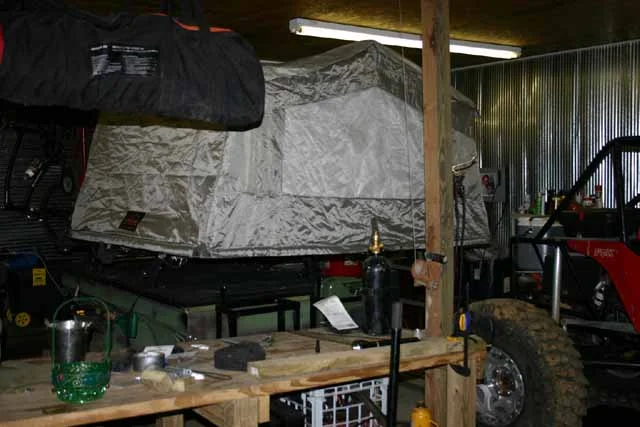

I got the tent installed.
I used Yakima Topload brackets to mount the rack and then centered the tent on the trailer.
I am amazed at how sturdy this setup is sitting on the trailer stand. I had my whole family romping around in it and it was rock solid.

I think you will have great luck moving those shocks about 6" from the outside of the tub.
Are you saying instead of being up on the lip, move the bottoms in 6" from the hinge side into the tub and mount? If so, that is what I have in mind....
I finally got the shocks mounted right so they will lift the top and hold it up. Sadly it took 5 tries :( Luckily I was only testing the stroke on one side. I only had to drill one hole in the rear once I figured out the right placement.
I have the tent and the lid with some other items up there and the tow 150# shocks do great in lifting and holding the top up.
