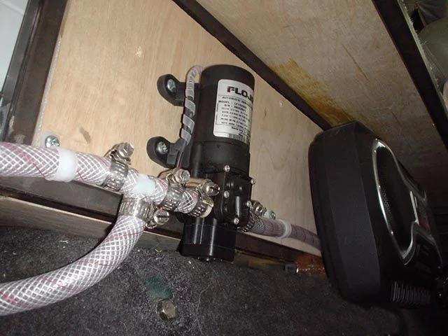

I too have a Shurflo 2.8 gpm pump and was looking into a fawcett option until I found out their prices! Wow!! So, I went cheap with a simple garden fawcett on/off valve at the end of a short garden hose as my fawcett. Pic Cheesy but it works!

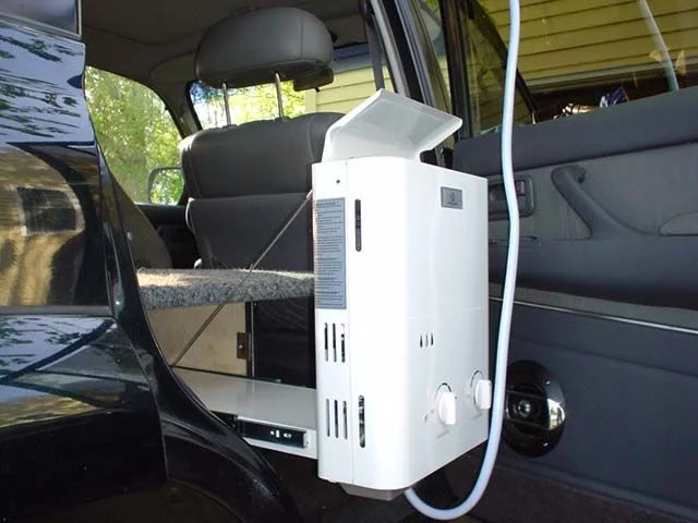

Our local TLCA chapter, CottonLand Cruisers, bought 2 of those showers and built cheap 2x4 and tarp enclosures for out event in October. The showers worked great and were easy to set-up. If I were building an expedition trailer, it would definitely have one of these. Good luck.
Those of you who have the Eccotemp shower units. do you use the switch at the shower head to turn it on/off while you're showering? If so, is the water temp pretty consistent, as in no scalding on startup?

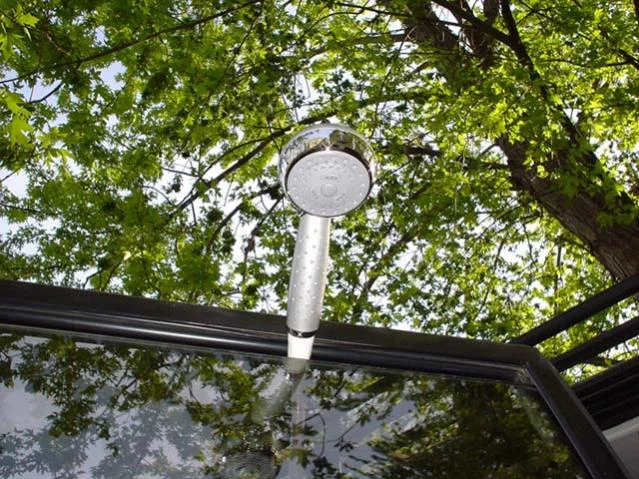

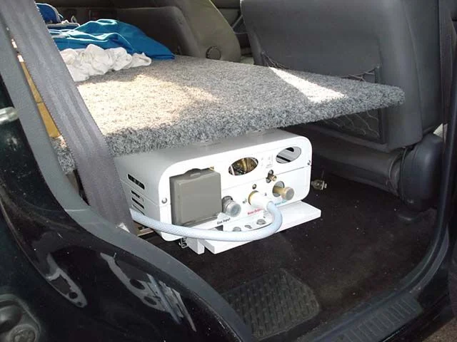

The switch turns the unit on and off but the water flow turns the heat on and off. Turn the switch on and the gas fires up when the water is turned on and shuts off when the water stops so it won't over heat the exchanger. I have found that if you use it in a short period of time the temp stays very consistent. I have not let it sit for a time and turned it on again. I use it to shower and turn the water off between lather and rinse. Once you get the temp and water pressure set you have a great hot shower. The shower head has three or four settings for flow so you have pretty good control of the water usage. Here is my set up.
