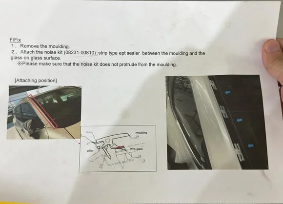

Is anyone experiencing a wind noise or "plastic crackling" type noise coming from the front passenger side A pillar area when reaching freeway speeds of 60 mph+? Word on the street over on Club Lexus is that Lexus is aware and has a fix coming but no timeframe at all. There were 3-4 LX locally that had the same complaint. I have the minor issue as well, and it’s fixed with a little piece of packing tape over the molding where it meets the windshield. Just wondering if anyone else on MUD has this.
To get the molding up, it seems you just have to push it towards the sunroof but I’m afraid to pull up. I can see under it but can’t figure out what’s causing the rattling (besides the wind) I tired small pieces of foam in there and it didn’t work. I’m going to work on it later again.
Hmmm the crowd over at clublexus were saying their dealerships had to order parts and they have been waiting for weeks. Do you have the service receipt stating what they did?
Yes, it literally said something like "pulled up gutter, added insulation, replaced gutter."
Copied and pasted from club Lexus
My 2023 F Sport had the same issue, I also posted in Club Lexus.
They found a loose clip and readjusted the moulding, the noise is now gone. Since the noise was fixed, I noticed that the driver side is making a slight wind noise now.
Just an update, parts have been ordered, once fixed I’ll post up results.
Took mine in for 15k service yesterday and they fixed this too per a TSE bulletin (think that is what the guy said).
Just had mine in where they corrected the molding work perTSB Lexus has out. Plus they had to readjust the mounding on my sunroof.
