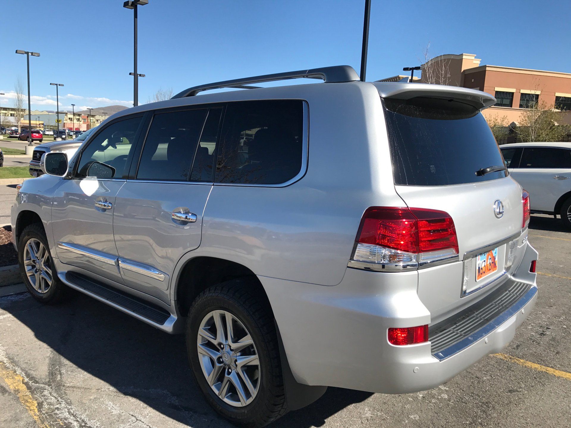

I have a 2013 LX and was in your position about 6 months ago. I was between BFG KO2 and Yokohamas and ended up getting Yokohamas Geolander G015 LT 285/55/20. It's a 32.6" tire and I love them. Looks great on the LX and I haven't noticed any changes in ride quality. I do notice the truck will downshift a little earlier than before but only when climbing. Once these wear down a bit I'll probably go for a more aggressive wheel and tire combo.

I have the tire in my signature: Wildpeak A/T3W in 305/55/20s. These are on the aggressive end in both size, and tread style. More like K02's in aggressiveness. I picked the Falken's as they were very well reviewed by some tire insiders, and quieter than the K02's. With less aggressive (albiet still aggressive) side lugs that fit more with the LX. It also got excellent marks for snow performance.
These are 33.2" tires so require some massaging of the liner to fit without rub. The width also requires a spacer, of which I use 1" all around. Cornering and braking performance are a priority for me. So tire width is an attempt to keep that balance intact, given the tire lift and A/T tread. While also protecting the wheel as it's relatively more inset of the tire sidewalls.

Looks great. Do the wheels stuff into the wheel wells when flexing the suspension or do they rub on the fenders? What about just going down a curb when the wheel is turned? Any rubbing?
