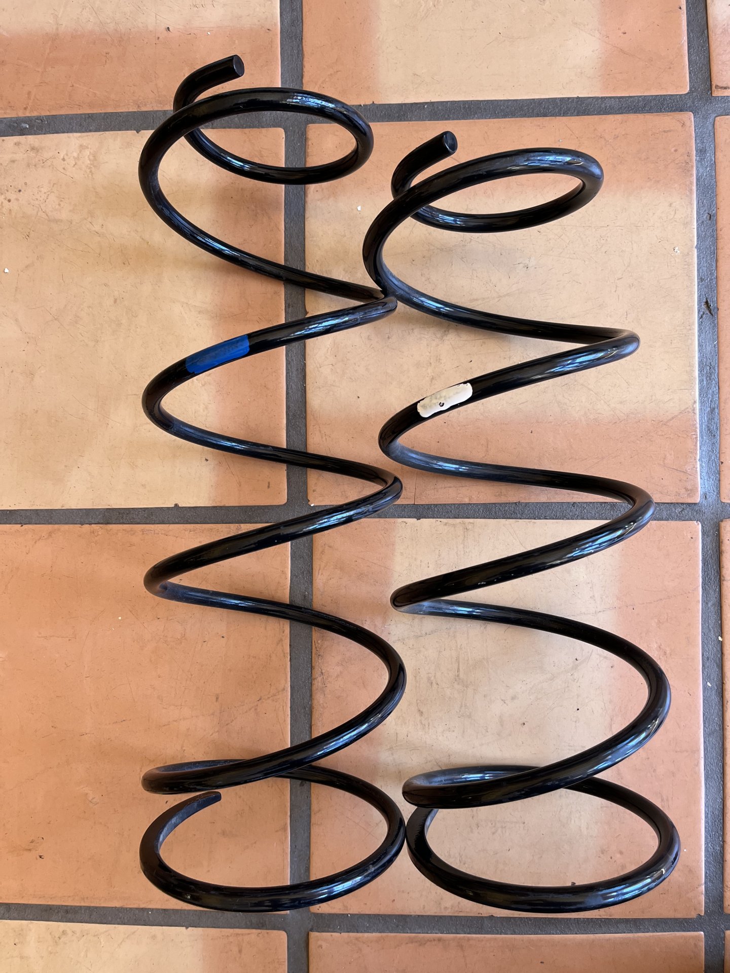

With my Gamiviti rack coming soon and an expected weight increase to follow I’ve been thinking about coil springs. I’ve decided to test out some LX570 coils to see if this is a viable alternative to Kings as they aren’t exactly cheap and there is often a wait to get your hands on a pair. I’m also the type that prefers OEM Toyota stuff as much as possible.
Some rudimentary googling shows my 2007 LC weighs in at 5425lbs and the front/rear weight distribution is 51/49. I have my third row removed and drawers installed so I’m fairly confident that my actual weight isn’t too far off from that figure. I’ve been able to travel pretty light so far.
By comparison a 2021 LX tips the scales at 6000lbs with the same f/r weight distribution.
The only thing I don’t know for sure is exactly how much weight is supported by the springs and how much is on the AHC for the 100 vs 200 series.
I found this pair on eBay for $120 shipped. They claim to be off of a 2021 LX and look virtually brand new.
The drivers side (left) spring has a blue marking, comes in at about 19” tall and has 5 1/4 wraps.
The passenger side (right) spring has a white marking, comes in at about 17” tall and also has 5 1/4 wraps.
I’ll see if I can get my mitts on a dial indicator to measure wire diameter.
I currently don’t have access to a proper garage and tools right now so I apologize that this won’t be the most scientific experiment mud has seen. I will run Techstream before and after the swap as well as take height measurements. I currently have 35mm of spacers on my original AHC LC rear coils and I will transfer them over to these springs to have an apples to apples comparison, at least to start.
Hoping to get these installed this coming weekend. I’m wide open to any other suggestions the mud brain trust has.
