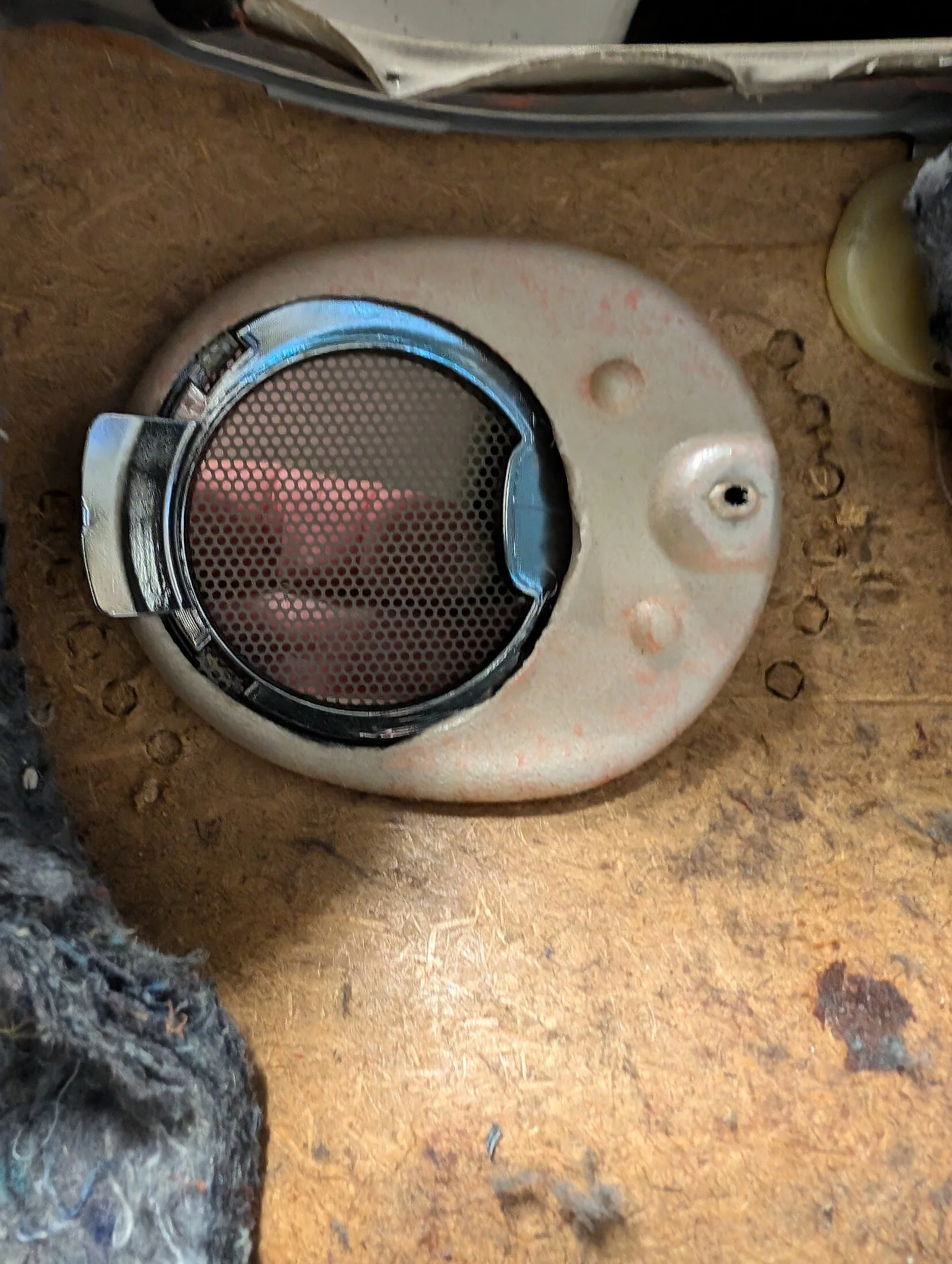

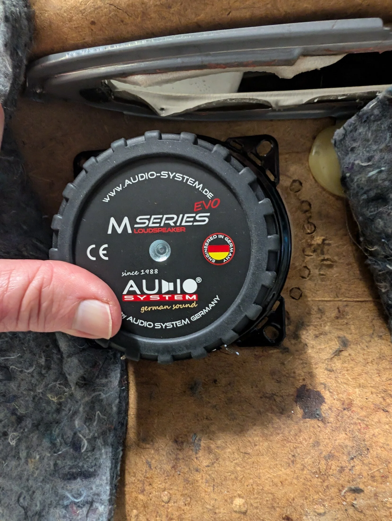

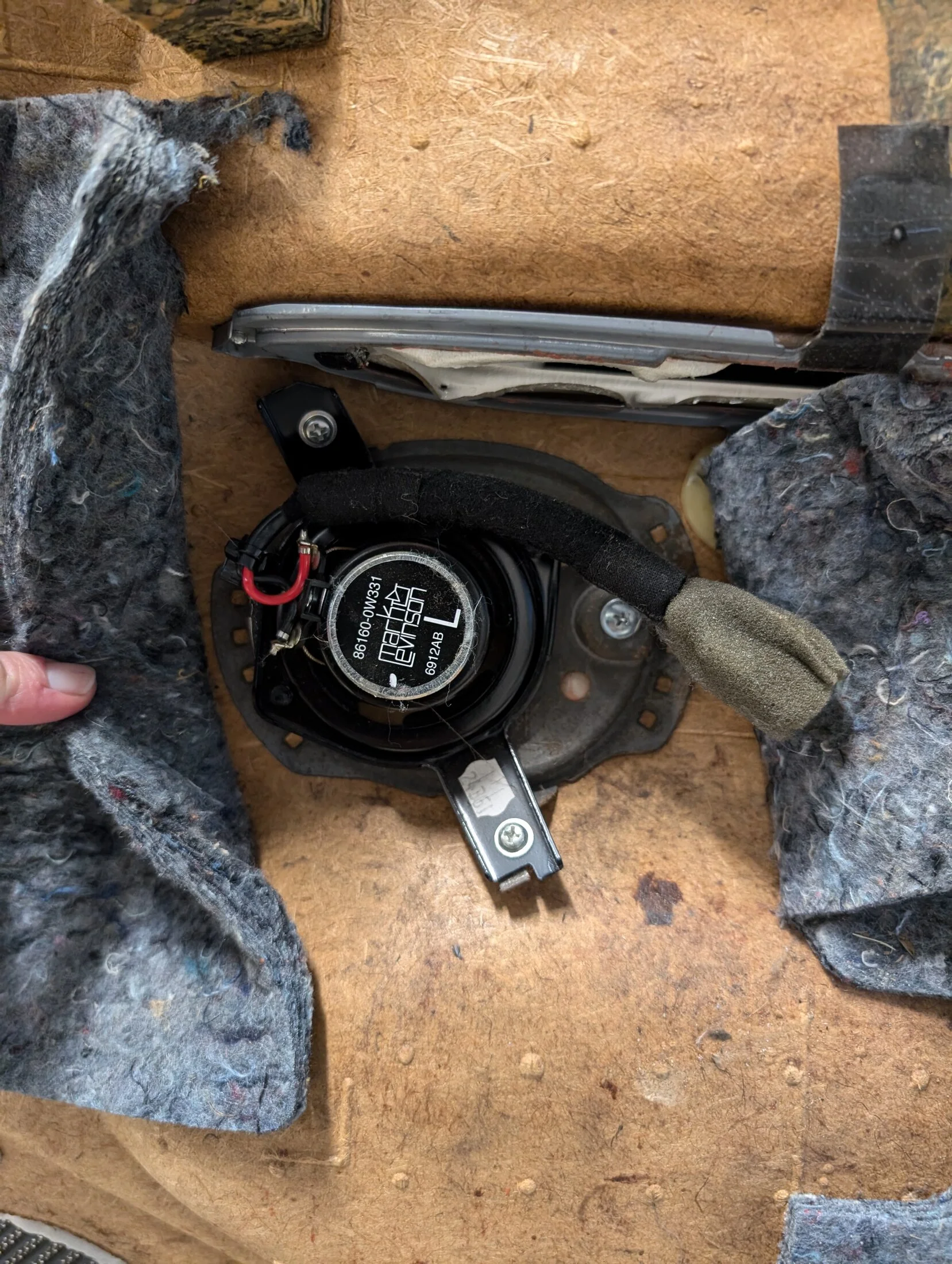

ML mid front door speaker?
I've started planning my upgrade. Got some Audio System M165/3 Evo 2s (on clearance) which are 3 way, was planning to run 2 channel active via an Alpine Optim8 DSP/Amp.
Luckily the M165/2 has the same drivers in a 2 way, so I can drop the 4" midrange if needed.
TL;DR? don't bother - virtually no room in there!
Just above the speaker is the cutout for the power window controls, and the harness drops in behind the speaker. The other issue is the mid is on the same wiring harness as the tweeter, a "crossover" of sorts seems to be a diode just below the tweeter.
I suggest a good 2 channel system with a low Fs tweeter would be a big improvement. And it's easy to go 2 channel active with separate wiring for the woofer and tweeter.
