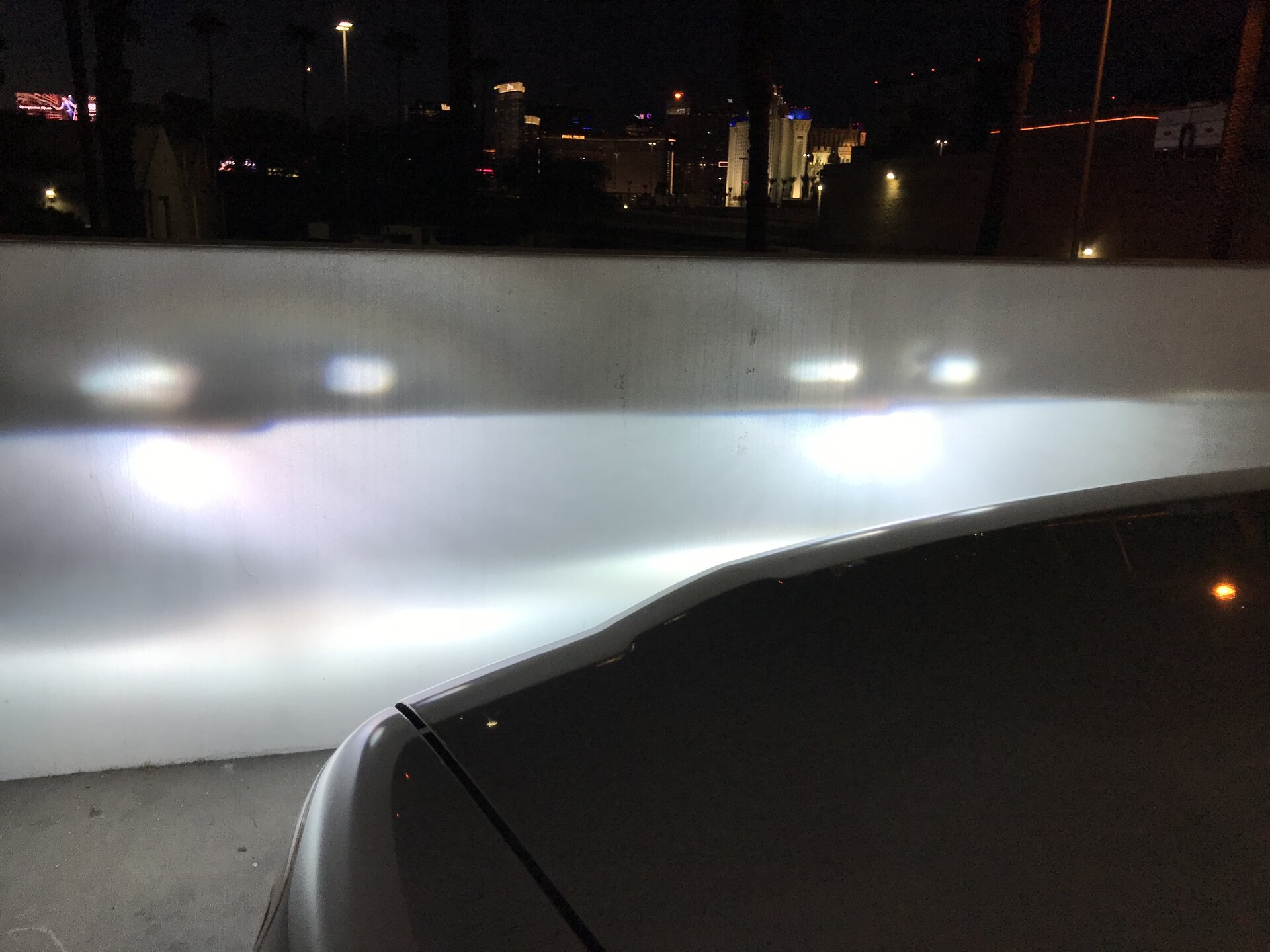

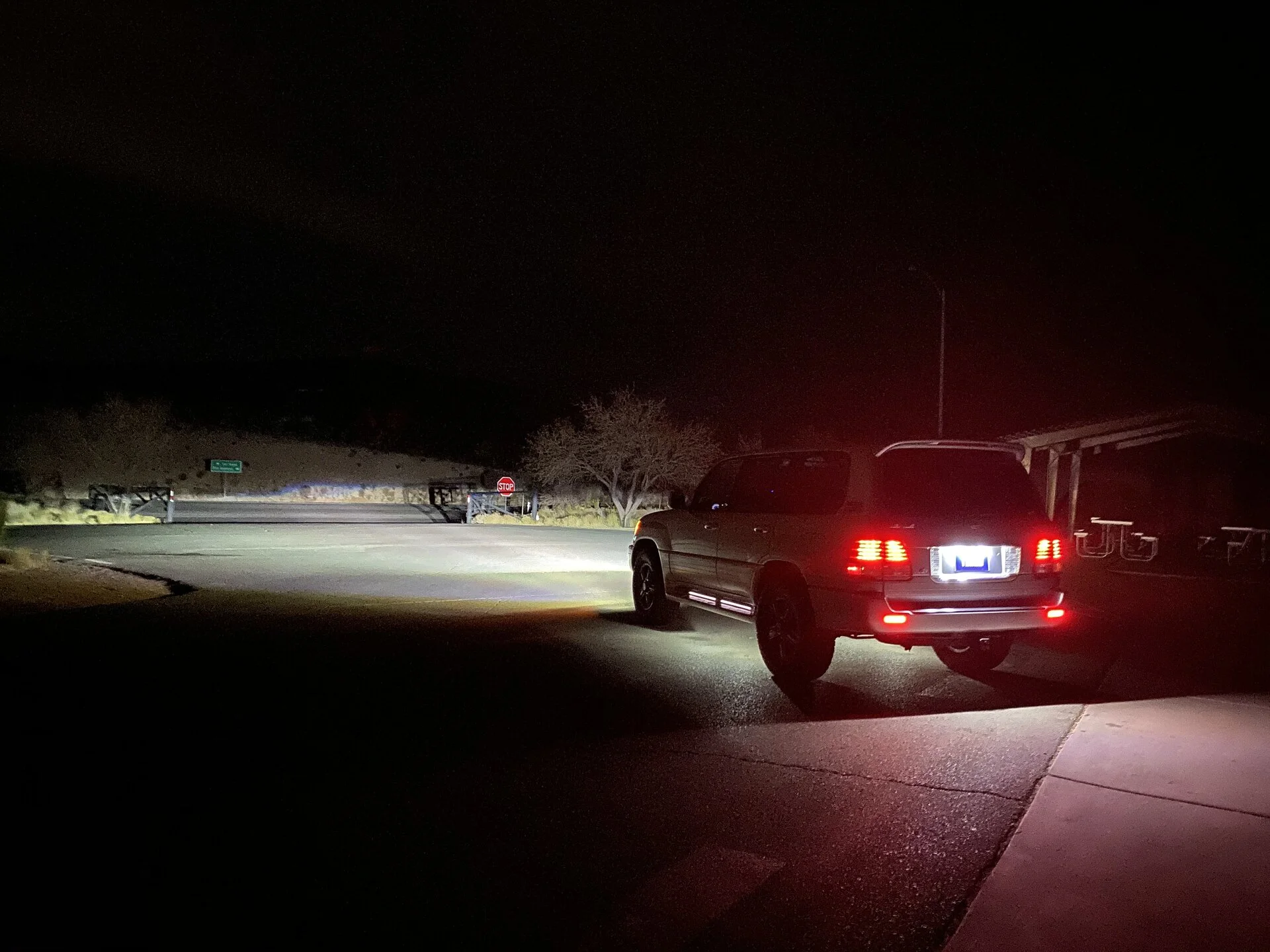

If you have the bracket from LB, I believe it’s design is for Mini H1 projectors only (2.5 inch diameter lens). I know this because this was my previous setup, I used the LB bracket, Morimoto 50W ballasts, Morimoto 6000 Kelvin HID bulbs and Morimoto Mini H1 8.0 projector lens - for me it was a decent setup, it was actually good. Did all the work myself, here’s an output photo:

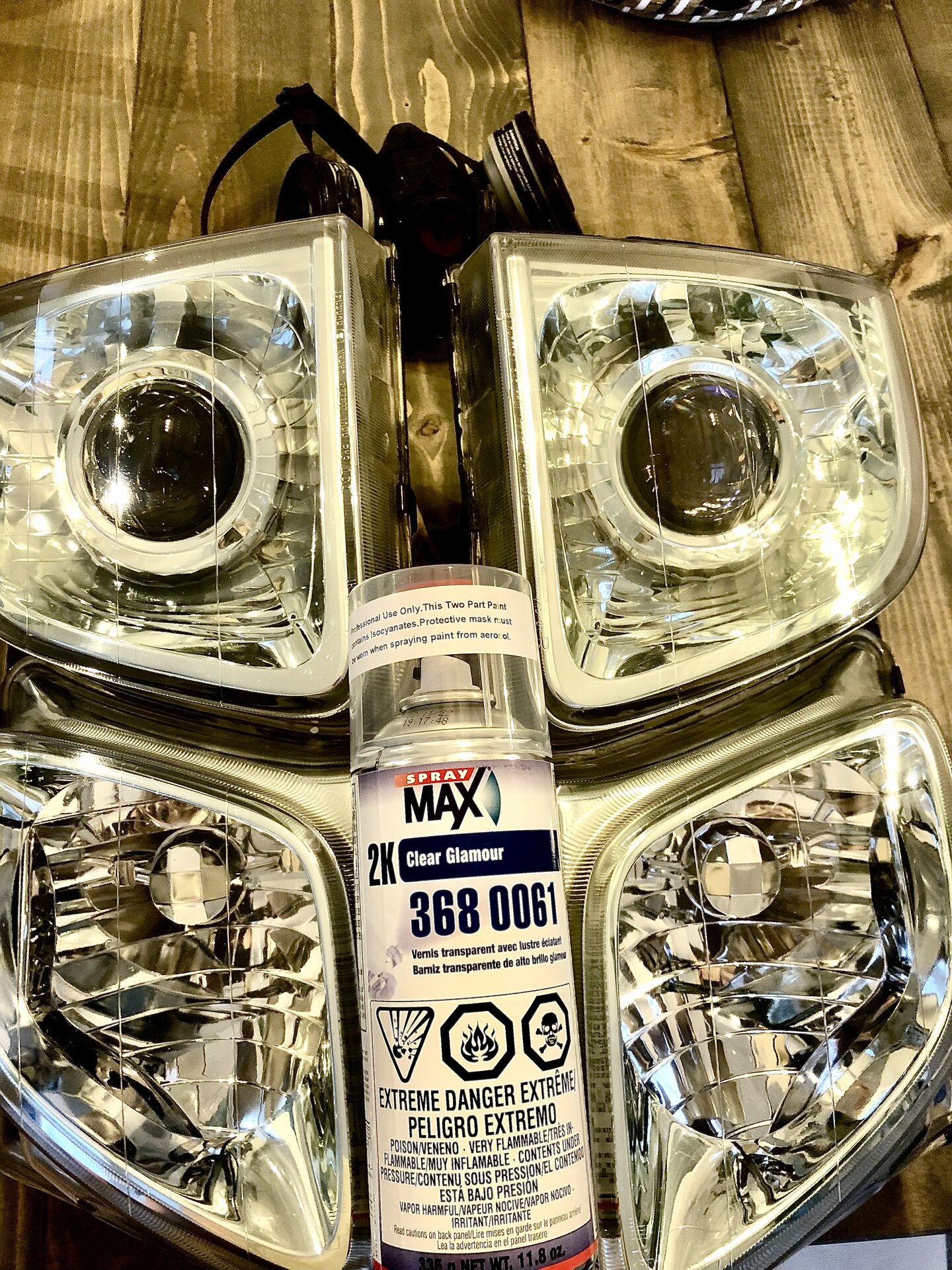

• if the polycarbonate lens have pitting, which is not as deep as the glass because PC flexes on rock impacts, it can be repaired by wet-sanding 600, 800, 1200 and 1500 grit finished with a fresh coat of 2k clear.

It’s a day and night difference going to an HID + projector setup. The morimoto H1s + HID system can closely compete with your Tesla LED headlights. Wide coverage, light output is intense and you have a controlled light cut off these are the things I immediately liked about that setup. I eventually looked for “more” so after about a year, I sold it and a buddy took ownership of that HL build.

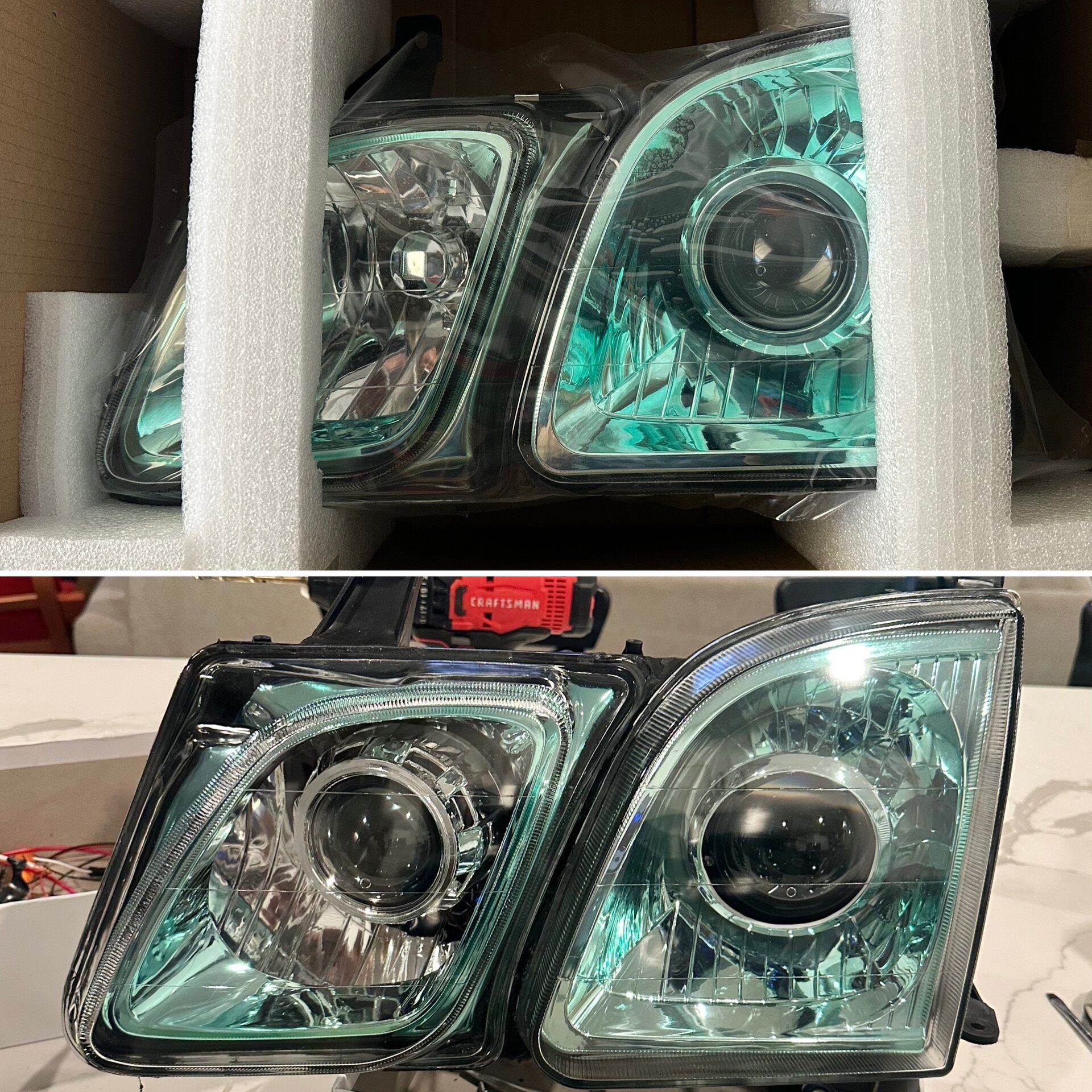

I recently finished my personal custom quad-LED projectors (around 45,000+ effective lumens) set. Built it ground up all brand new components including the housing.
Before & After:
Only trade off with this setup is that it’s very bright, too bright that if the car in front of me during a stop is a color white or silver and it’s shiny, and spacing is about 6-ft away close, that intense light bounces back to me, so I now have to give more space to avoid the intense light ricocheting. But a what a beast this is in the freeway, covers upto 5 lanes and just has tons of foregrounding light. The HL housing that I have btw has glass lens, for additional protection I applied PPF on the lens.

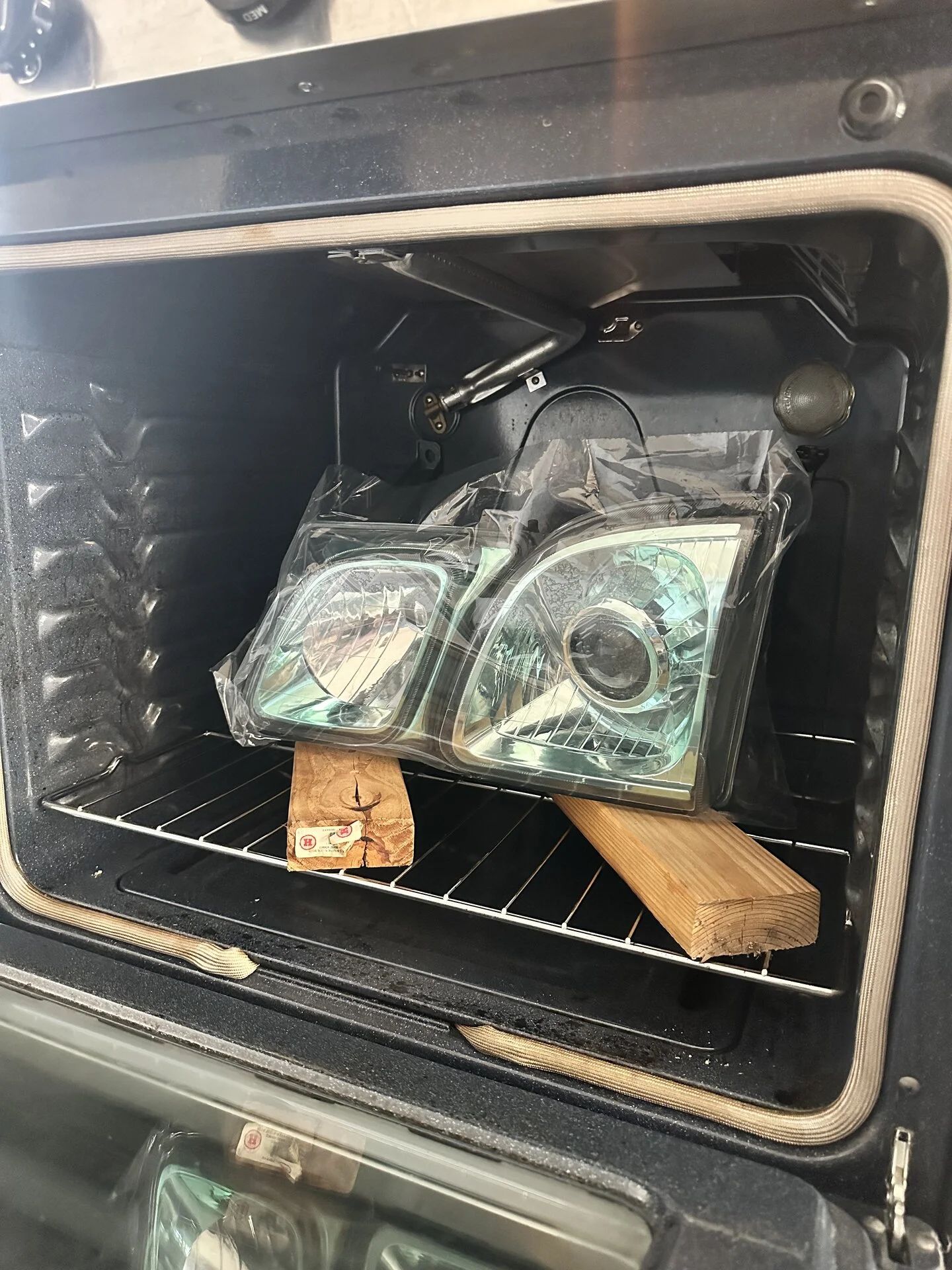

I assume this is that whole process of baking the lamps open, modifying the reflectors, etc.?
Yes it is. Preheat the oven to 235°F, put a block of wood between the oven grill and HLs to avoid melting the bottom of the housing, bake on the same 235°F temp for 9 minutes, remove from oven and slowly pry out the lens from the housing. Use gloves, that thing is hot.

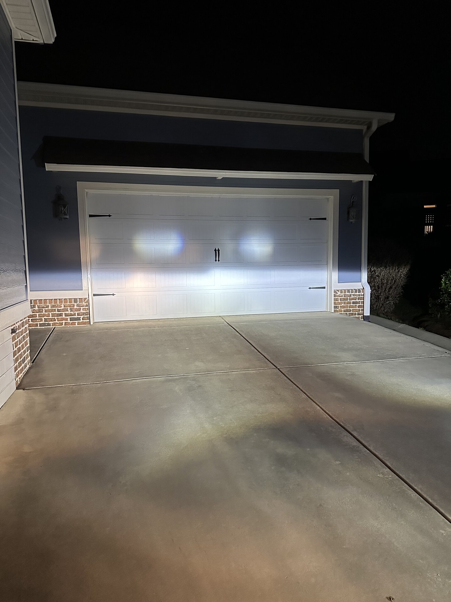

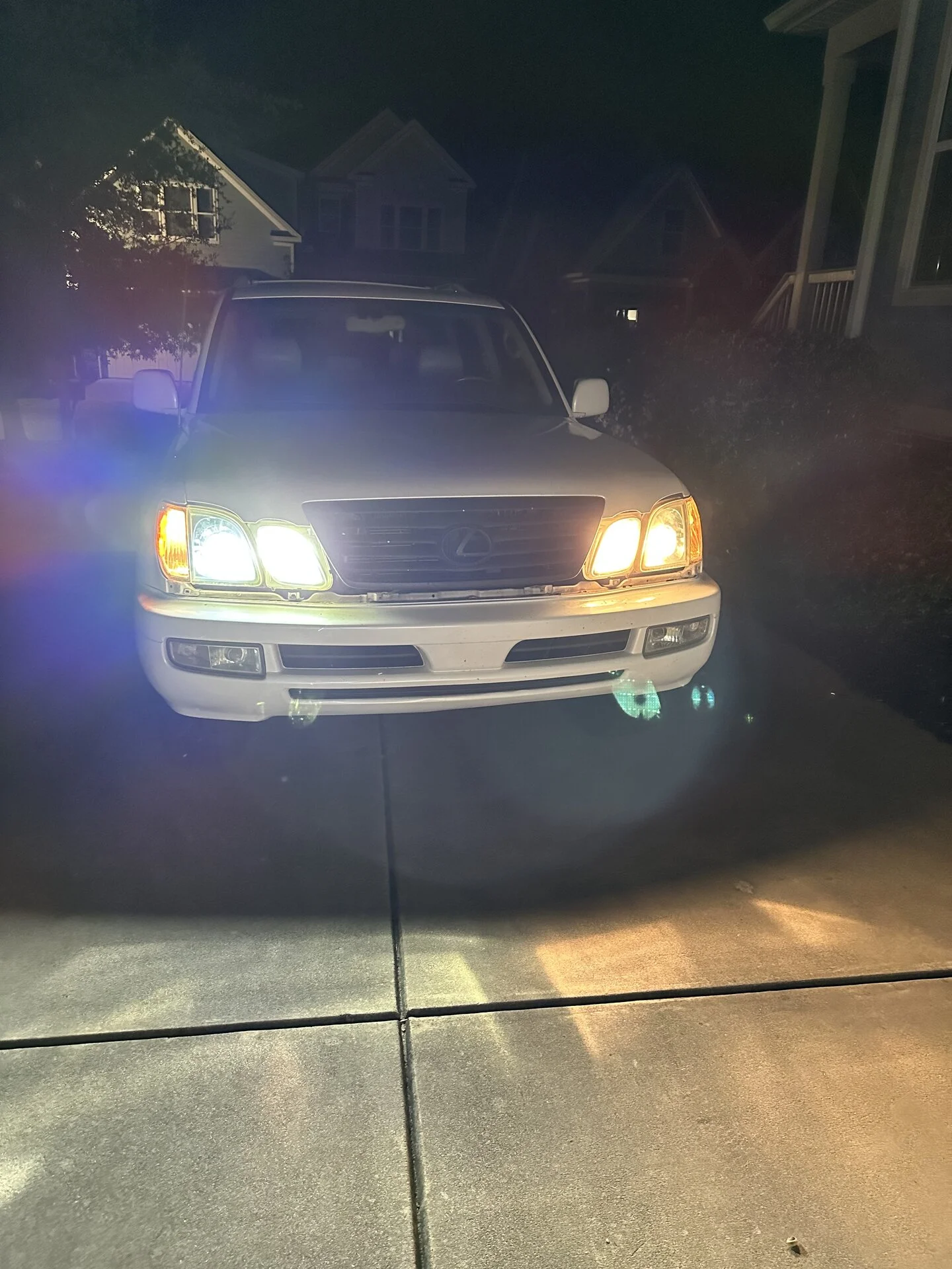

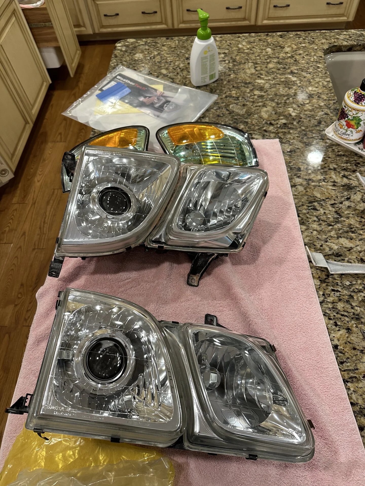

I talked to a bunch of sales reps and watched a ton of YouTube videos. The common theme I got was the led technology has gotten a lot better recently and it was a better option than HID. I ordered some OEM glass headlights off eBay and will be putting led bulbs in. I'm waiting on my PPF film so not done yet but I went with Hikari 2023 H1 bulbs and was going to go with morimoto 2 stroke 3.0 for the 9005 but tried out some Fahren Kregis 2023. The reviews said they work with DRL and they were cheap. Here is a picture of the light output from my right side headlights vs stock setup.
I think the reason why people are leaning towards the hid projector retrofit is for the sharp cutoff and clean bright light that doesn’t blind oncoming drivers.

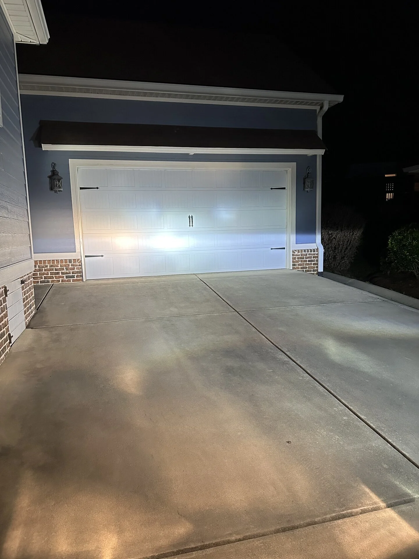

Not bad, for reference this was when I had oem projectors with 35w generic HID kit.
Those 4x elongated dots are what we call squirrel finders (for reflectorized road signs) but can be blinding for low sitting vehicles like sedans.

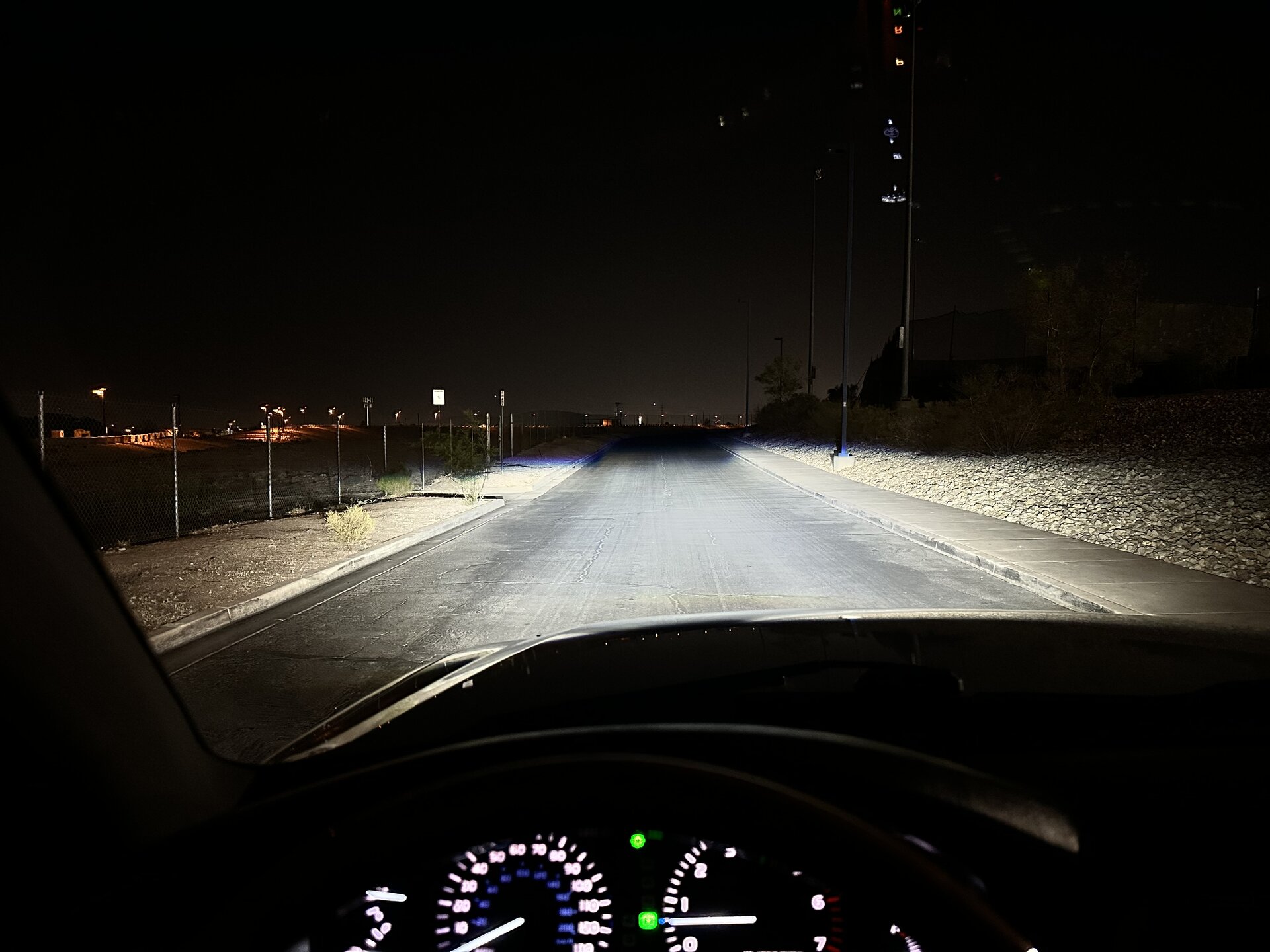

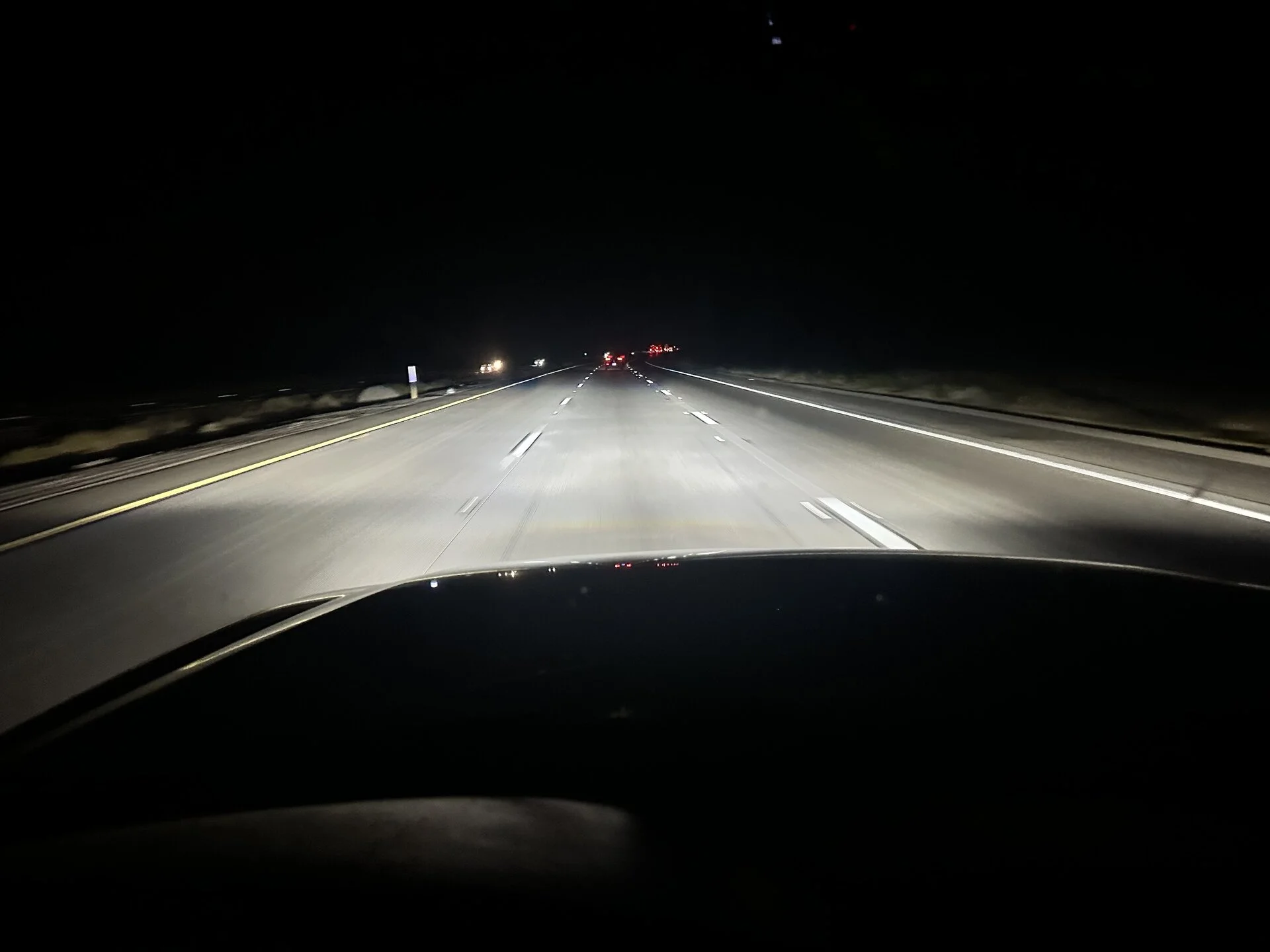

Went to San Diego CA last weekend and got the chance to take an output shot in the i15 @ 80+mph
