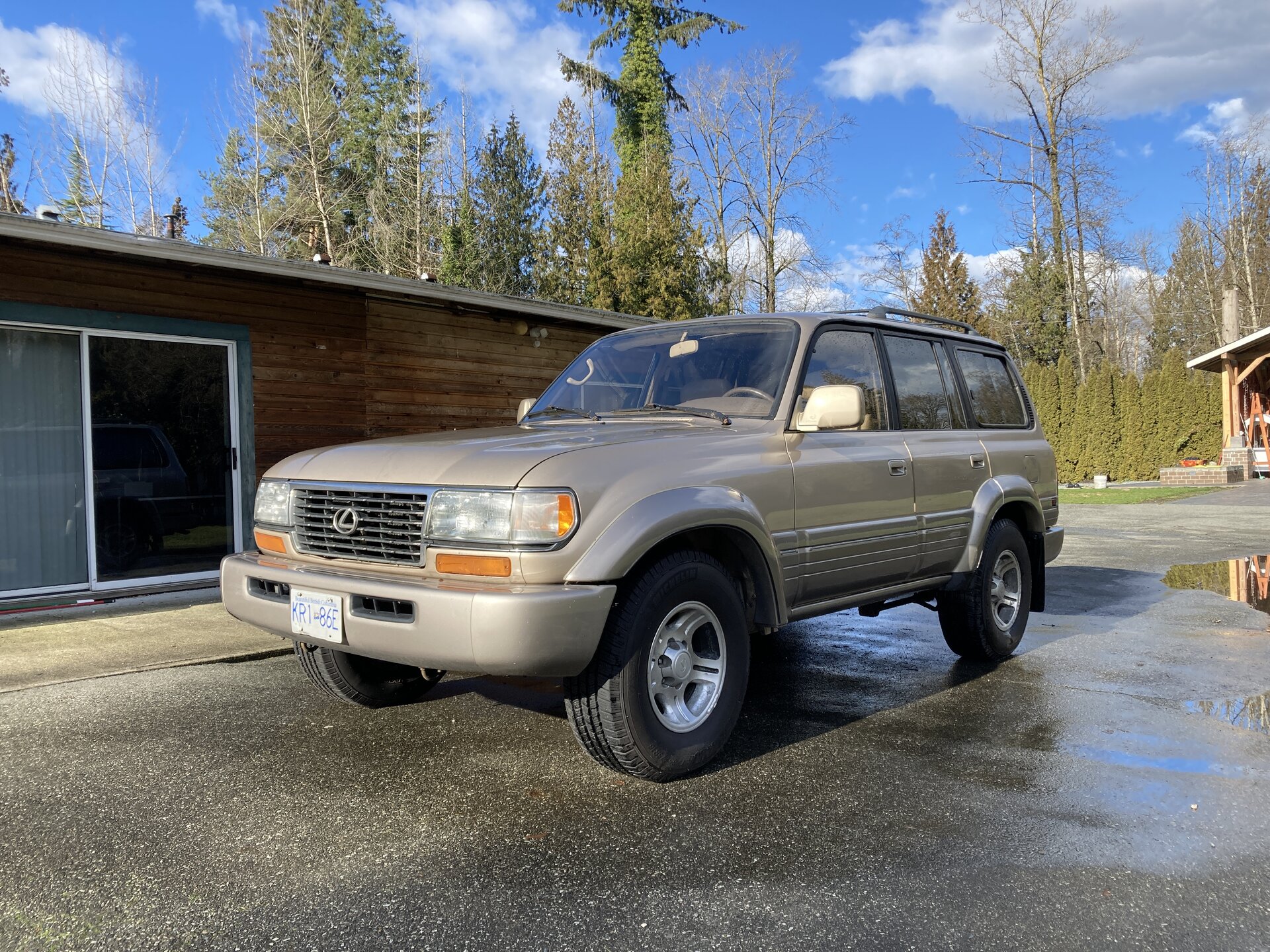

This is my "Grandpa Gold" 1997 LX with 345.000 miles:
I have a some basic tools, a driveway where I can do basic stuff.
I have to be honest, sometimes I am not so good with the details, I get distracted easily, so is important for me that I can complete this before I get bored and try to sell it haha. I will try to commit to this thread as my file cabinet and to keep me accountable to keep working on it. Let's see how it goes.

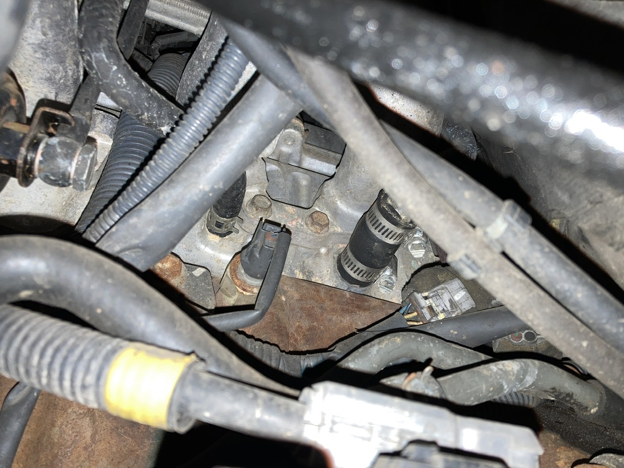

Doing an inspection under it to see what else I need to add on my list.
Seems like the PHH had been replaced?
With the worm gear clamps, yes I would assume its been changed. If it was me tho, I would still replace it and use better clamps(constant tension clamps) and gates hose or Toyota hose. Good looking rig!

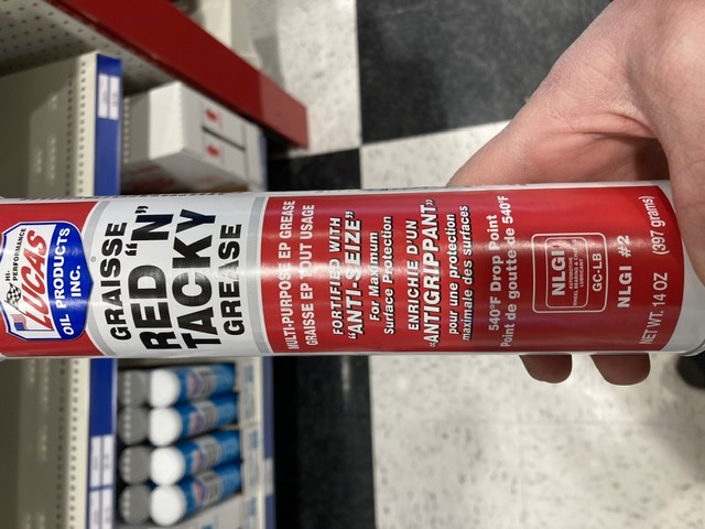

Added some grease to the knuckles.

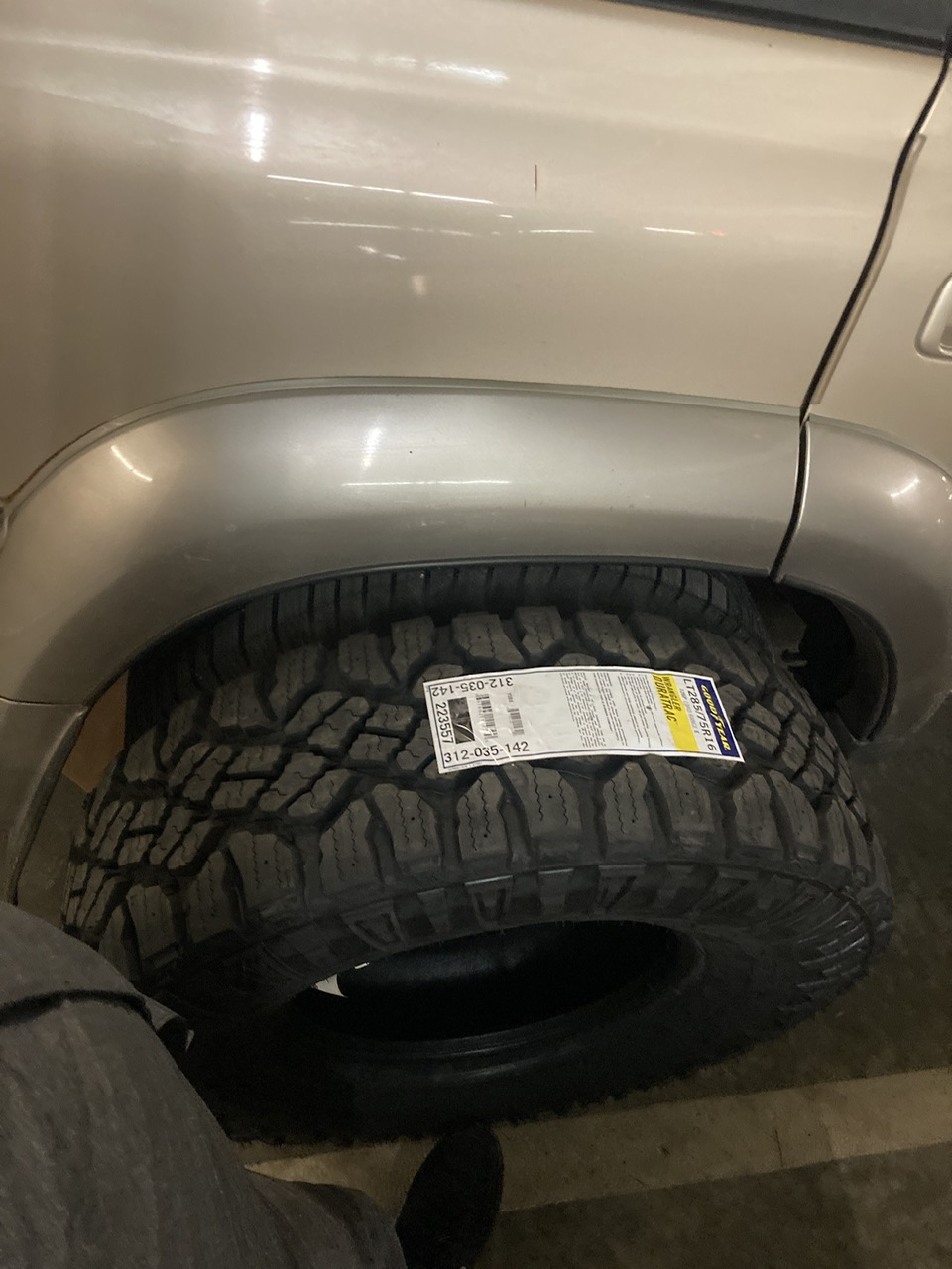

In the meantime, something that can give me more clearance to wire wheel under the truck:

Looks like you're making some headway. A couple of things to think about:
  • Lucas red and tacky should NOT be added to the knuckles. If you have concerns about the status of grease in your knuckles you could dip a zip tie in there and see what it looks like. It should be a gray grease with moly. You will have zero idea what is in there, and you may want to consider a knuckle service as part of your baseline PM. You can buy a nice kit from Cruiser outfitters and it will have all the seals you need. There are lots of different greases that you could use, but the widely held consensus is to avoid mixing grease types. This can be hard to do in places like U-joints.

Those tires will be pretty fun!
