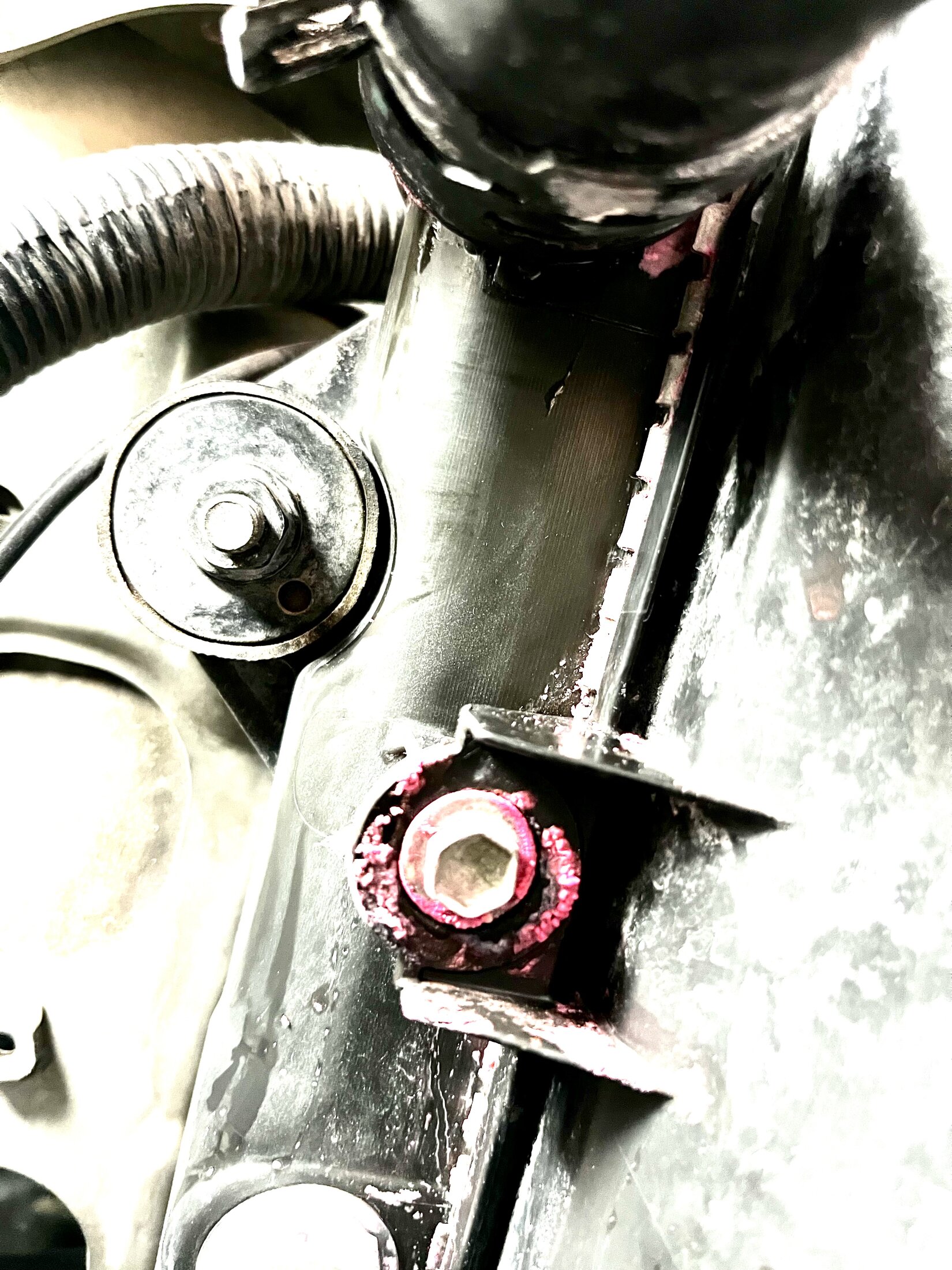

Test drive went well, no overheating or running hot, good oil on the dipstick, a/c worked.. I began to drive the 1.5 hours home and noticed the heat didn’t work. Shortly after, I noticed the temp gauge creep up. Pulled over and snapped off the plastic cover over the radiator and sure enough it was bone dry. Limped to a store for some jugs of water and filled all the way up. I’ll post pics later but it looks like she’s had a small coolant leak from the top rad hose. Luckily, it’s red in color. Needless to say, this weekend I’ll be conducting a flush and refill on the rad and clean it up to see exactly where it’s leaking. I’ve read about the leak under the intake manifold and will have to look into that, also.

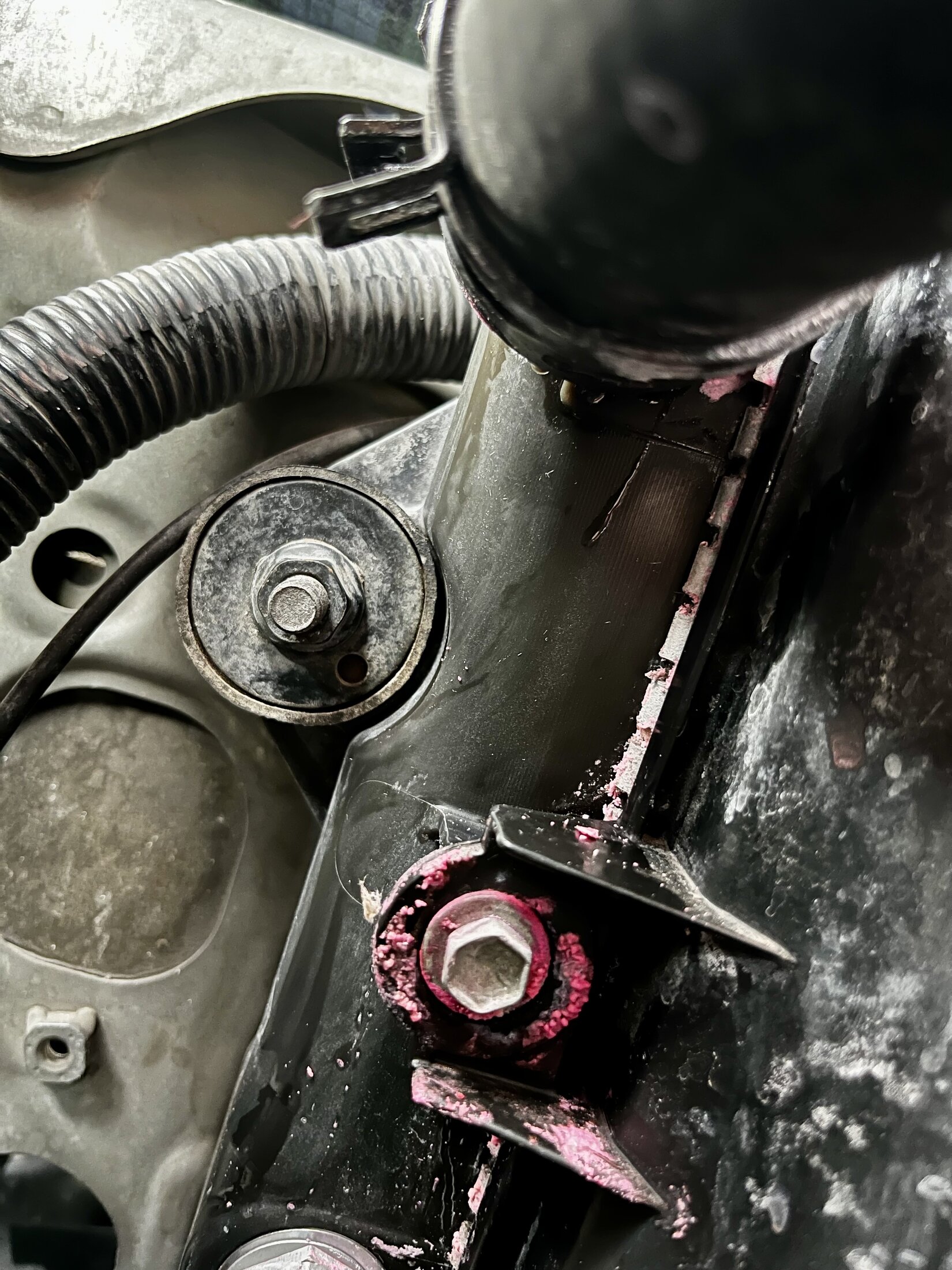

Life with a newborn and a busy job makes for little time to mess around with Flo. Found the crack. Definitely need replacement. Finally found the culprit to why I’m leaking coolant all the time. Ever seen a crack this nice?
Glad you found it. Expecting mine to start leaking in the next 25k. Thankfully they're not terribly expensive.

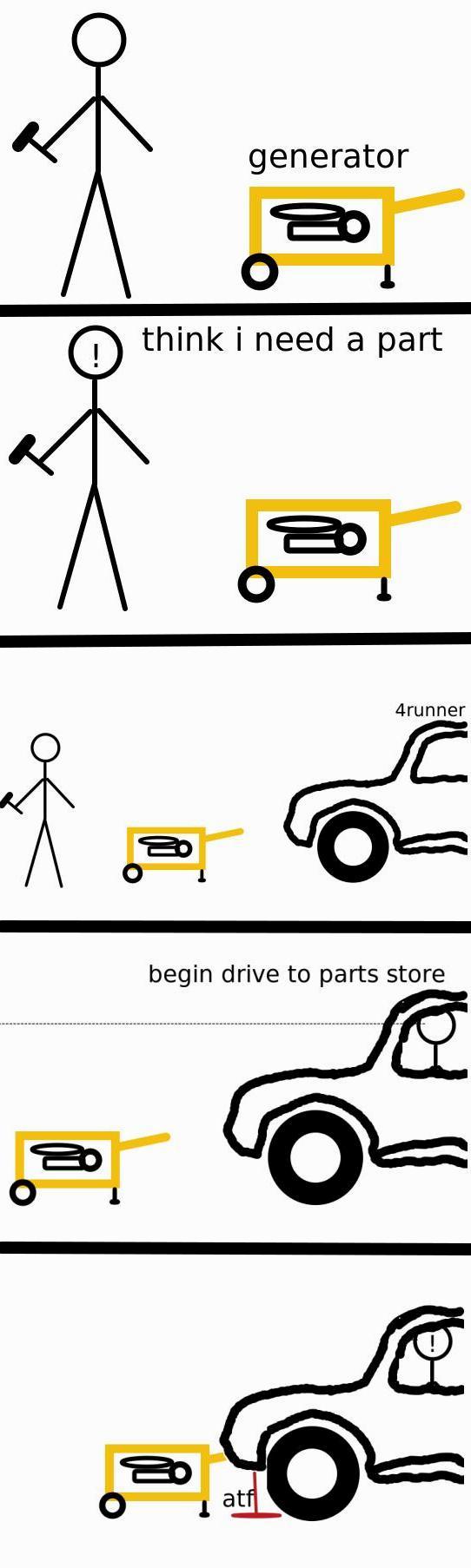

One time, when changing oil in my generator, I realized I needed another part for something else. I hopped in the 4Runner and pulled forward...only to drive into the pullbar of the generator, which rode just between my bumper and skidplate, punching through the radiator, condenser and bending the fan. Not my best day. 🤣

@rav8 you have a generator sitting on the front of your cruiser? I know I'm not the brightest bulb in the tanning bed so maybe I misunderstood.

No generator on the front. I get the misunderstanding. I was a huge dummy. Story goes like this:
I learn hard.
I really appreciate the drawing. It helps me comprehend your situation. The head thickness runs deep!

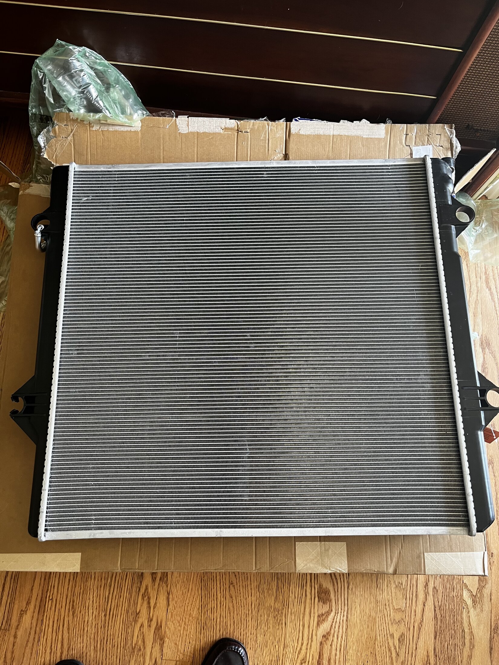

Alright... radiator ordered.. it was difficult to find any reviews of some of the lesser expensive radiators offered on Rock Auto so here's what I bought and we'll see how installation goes and how long they each last.
Radiator - OSC 13210 - $130.79 (drop-in config., includes hardware & fittings, leak and pressure tested, etc.)
Thermostat - MOTORAD 637180 - $19.28 (includes t-stat, housing, and seal)
Total after shipping was $173.07 with a potential delivery date of July 3rd.

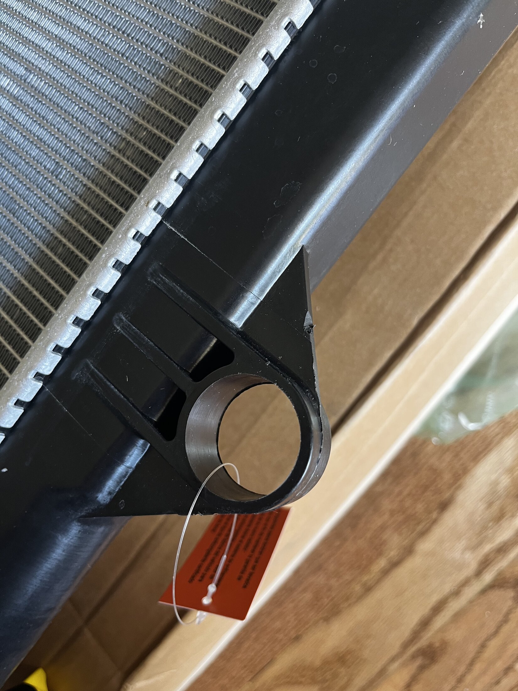

The current radiator has now developed more cracks and is leaking a whole lot more tehe
I'm not even gonna say it......................................
.............alright I'm gonna say it..
I SHOULD HAVE BOUGHT A MISHIMOTO AND CALLED IT A DAY!!! :bang::mad::censor:
  • Sad
Reactions: r2m
Straight outta the box it came like that?? o_O
Unfortunately. But, I began the exchange/return/refund/replace process with Rock Auto (which I've never had to do) and am hoping to have a resolution by tomorrow morning/afternoon. If they cannot replace with unbroken part then I'll opt for refund and find a different option.. maybe a mishi
