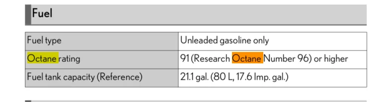

I am going to apologize in advance if this has been posted or discussed already on here, but I have not been able to find any related talk. Does one have to use premium fuel for the new LX 600? Not sure why Toyota is recommending it as it does add significantly to the travel expense with as many miles as we put on a vehicle in a year's time. We are considering a F Sport trim coming from a Sequoia-my 200 gets regular. Perhaps there is a better mpg on the LX to help negate some of the increased fuel cost of regular vs premium?
Min 91 - the manual is your friend.
Some vehicles are premium recommended, some are premium required.
On the 600 it is required.
Some will say “it’s the same engine as the Tundra and it doesn’t require premium”.
It is the same engine but it is not tuned the same. Using non premium will cause damage OVER TIME (i.e. you pull up to a gas station and the premium pump is broken….go ahead and put in whatever the highest avail octtane gas). It will also run with less power, lower than a Tundra using regular gas. Next fill up go back to Premium.
