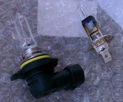

Guys, I purchased a couple of Philips HIR2 9012 to upgrade my Low Beams based on the discussion in the forums.
I went to install them using the discussion in this thread, but the new bulb doesn't match the one I pulled out? Have I yanked the wrong bulb from the truck, or am I missing something?
Edit: New bulb on left, old bulb on right.
HIR bulbs can only be modified to fit 9006 and 9005 sockets. The low beam bulb on a LX is a H1 bulb. The one you have could be used for a high beam but thats it.
Well crap, I must of misunderstood the thread I was reading and got a Toyota style bulb.
Soo...these 9012 bulbs can replace my 2000 LX470 High beams? If so, would they be considered an upgrade?

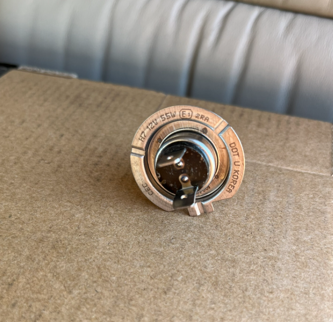

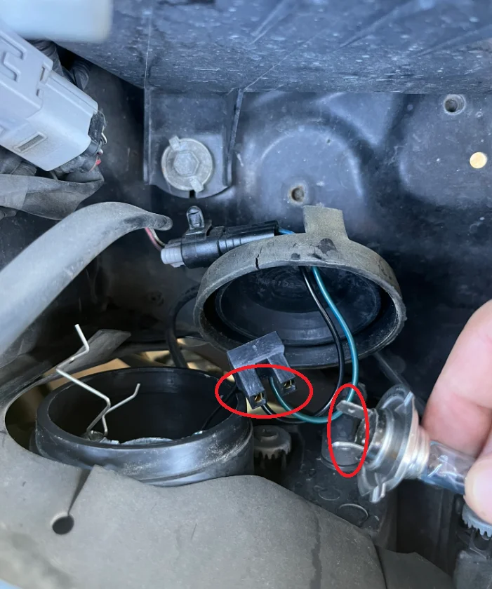

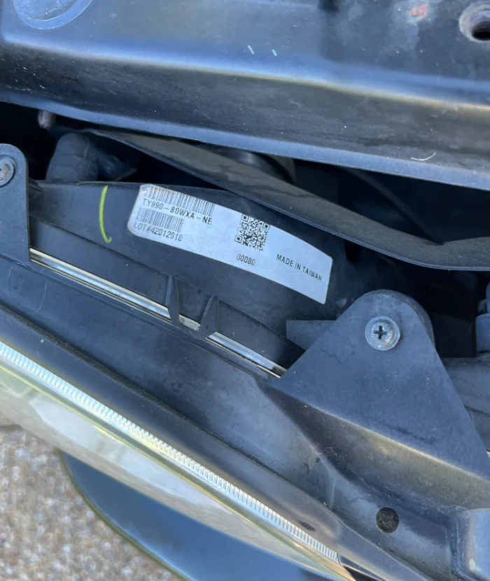

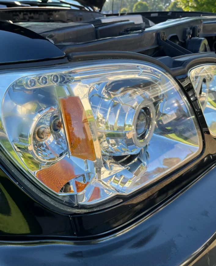

Hello, I have a 2005 LX470 recently purchased and ordered the Sylvania H1 bulbs pictured below that have one prong. However, when I removed the existing bulb it has two prongs (pic below). I am also attaching a pic of the headlight itself. Not sure if it is factory or if the previous owner replaced it with aftermarket headlight due to which the light bulb has two prongs ???? I also noticed that existing bulb says H7 instead of H1. Why would this have H7 when everyone else has H1? Thanks for your help.
I think previous owner may have replaced the headlights. I tried the H7 bulbs and they fit just fine. However, I am not impressed at all with the silverstar nor the Silverstar Ultra. Perhaps it is the after market headlight assembly negatively impacting the performs of the bulbs but I am not impressed.
