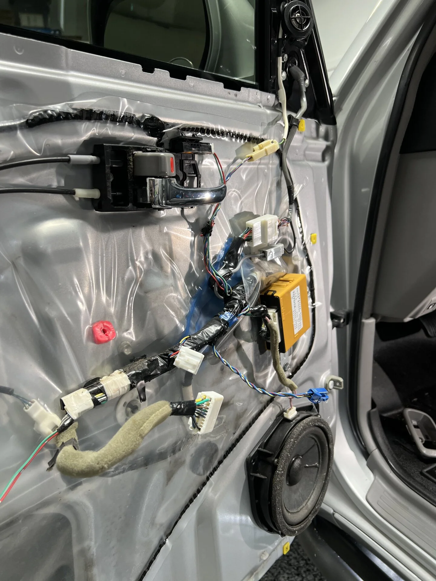

Hi all!
Apologies in advance as I know this topic has been discussed in detail but I wasn't able to locate anything specific to my issue.

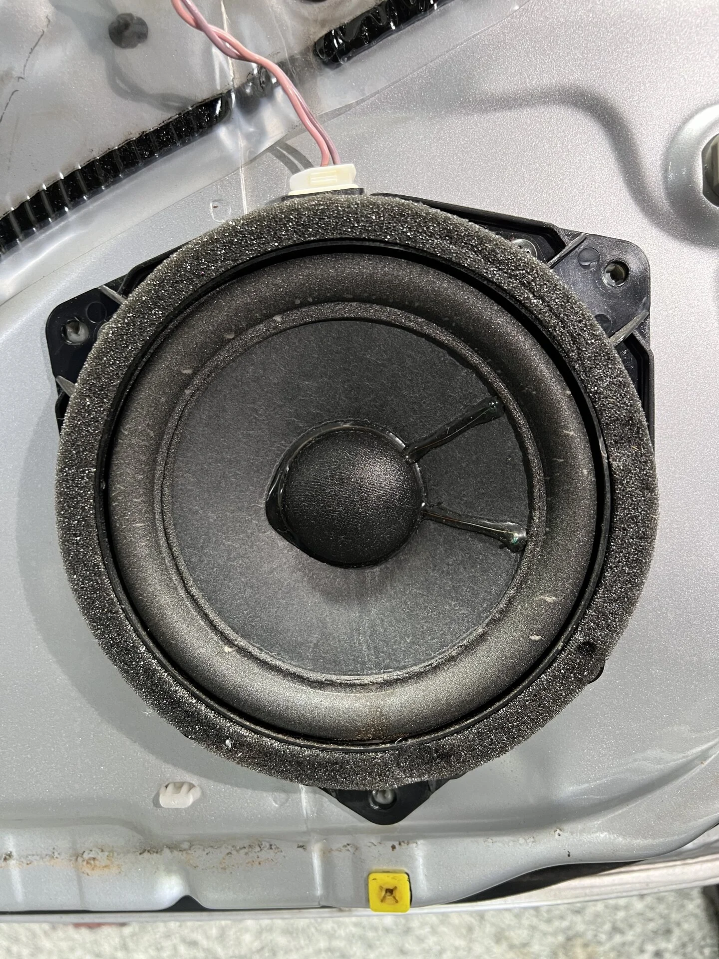

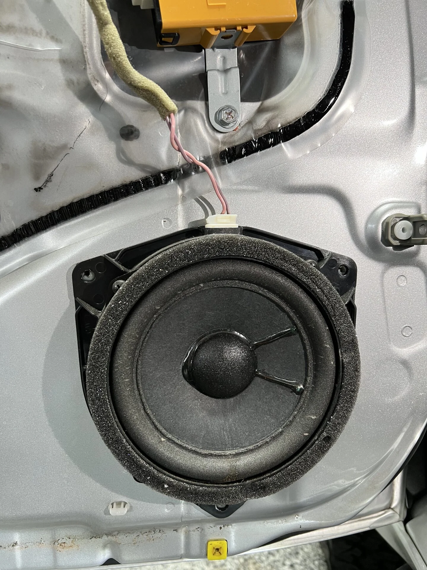

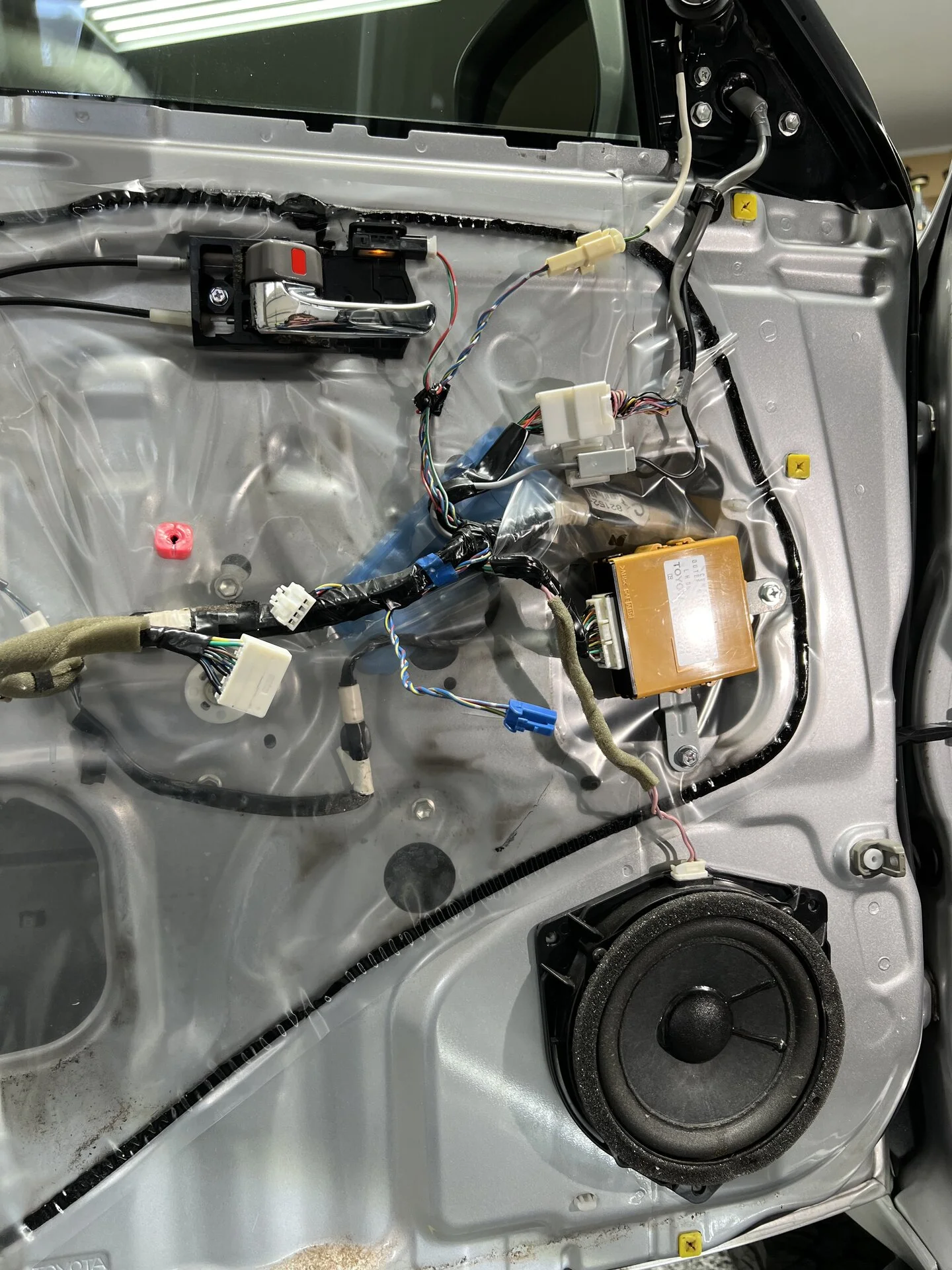

I have 0 audio coming through the front driver side door, all other speakers and etc. seem to be working. Previous owner did install a Tesla style headunit and a 10" sub in the back, which I've since removed. (the sub) Speakers look to be the oem Mark Levisons with no observable damage. Do you all see anything that may explain the issue? Many thanks in advance...
Check the wire loom where it passes from the jamb to the door. Wires have been known to wear & break inside the rubber tube. Here’s an example: Help diagnosing Master Window circuit? 1999 LX
My speaker cut out all the time on the driver door and it was the wires in the door loom. If you can't figure anything else out, that's a pretty easy thing to check and not to hard to repair either.
