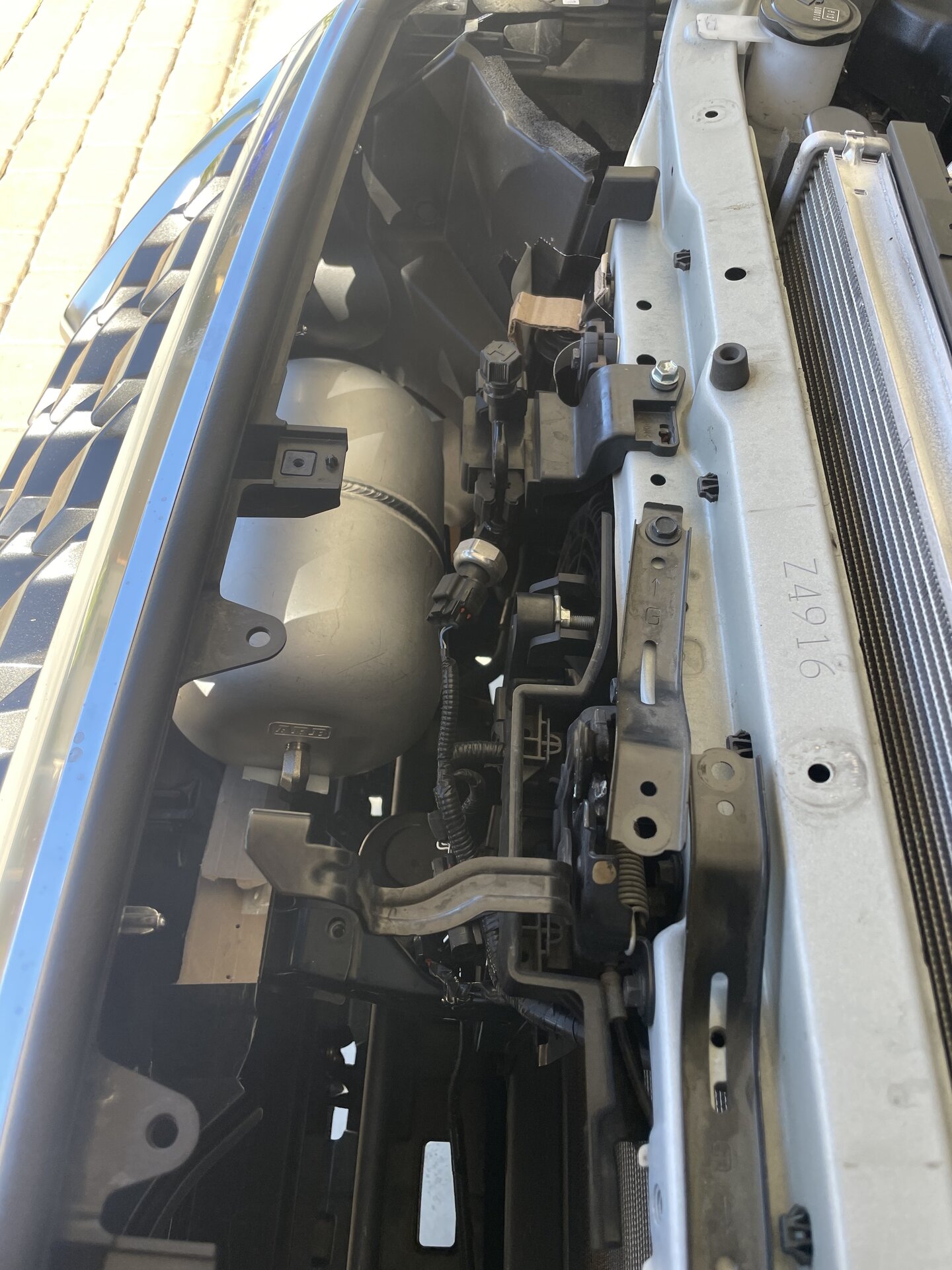

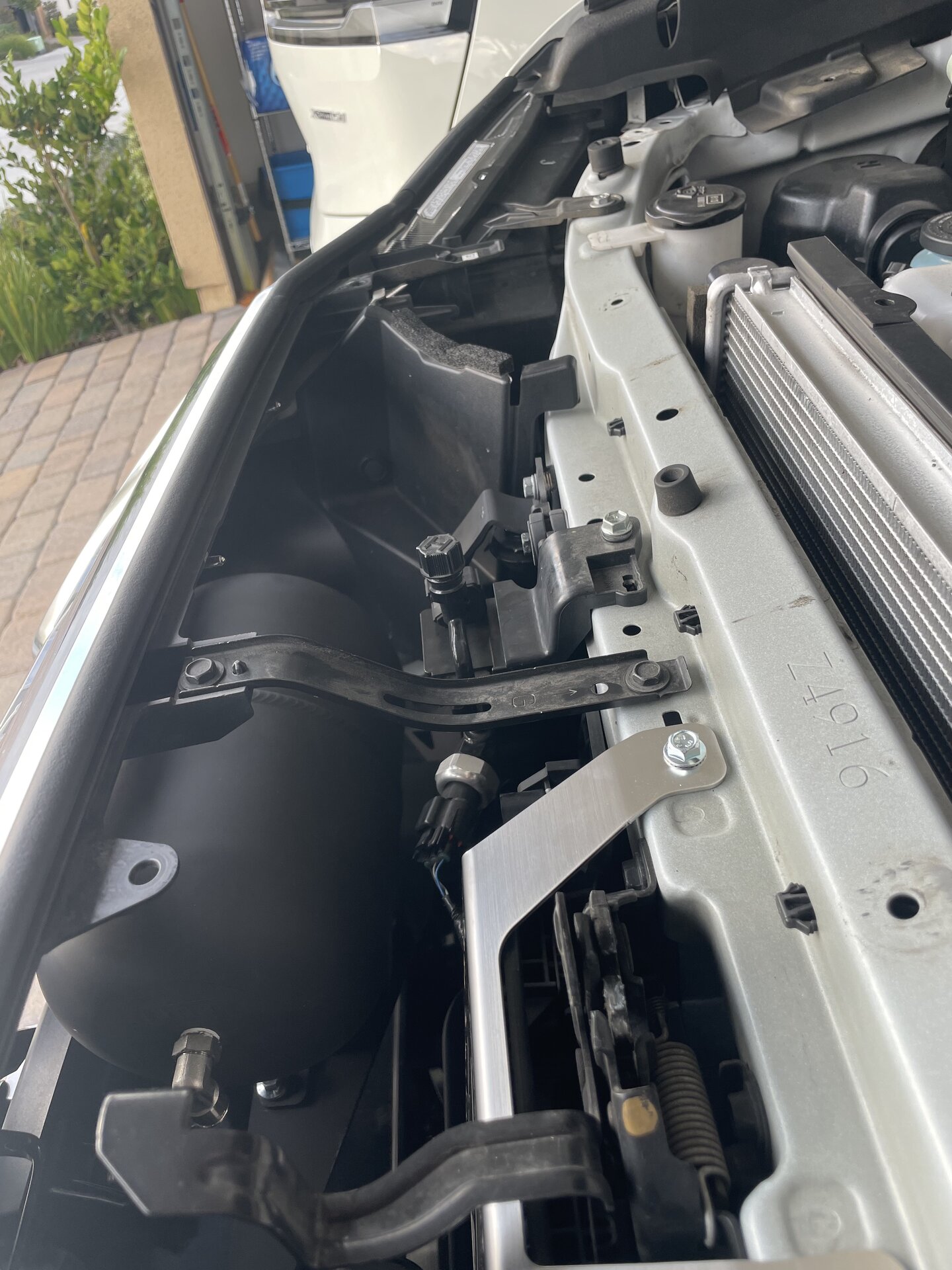

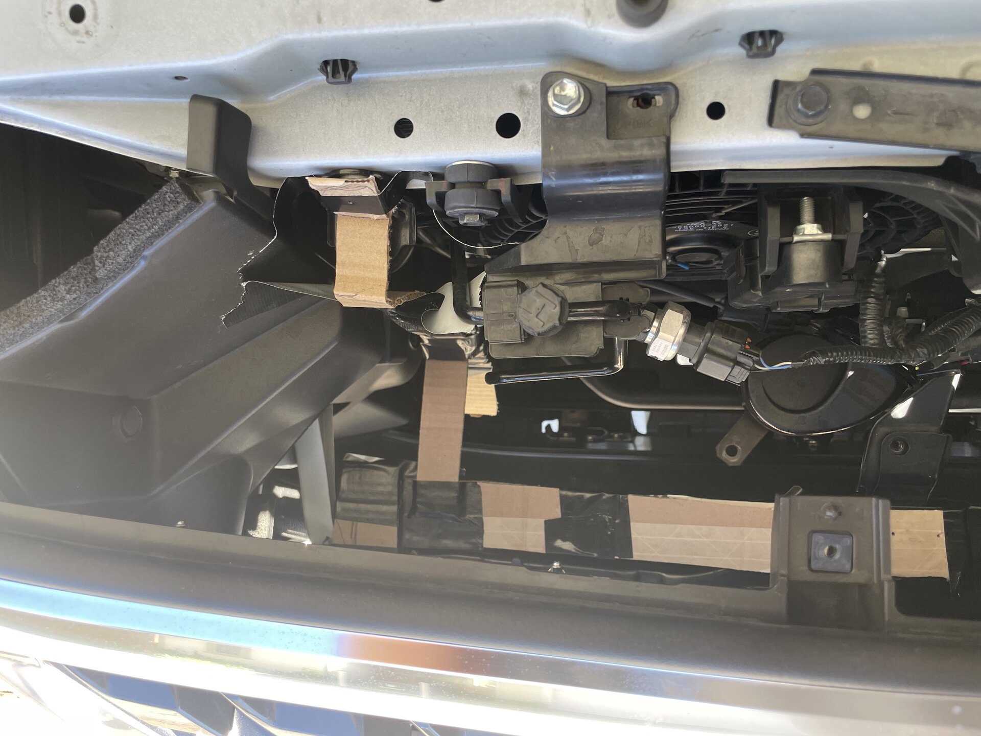

Custom mount for an ARB air tank:
I wanted an air tank for my compressor... so I designed a bracket to locate it in the vacant space at the front of the GX 460. Designed the bracket using cardboard and CAD. Bent out of a sheet of aluminum and spray painted to make it more discrete. A few of my measurements were off (cut up amazon boxes are not totally square). If any vendor wants the CAD file, PM me and it's yours if you send me a nice looking bracket :). If there is interest, I can draft up a flat pattern for folks to bend up themselves. I used 1/4" sheet aluminum because it's what I happened to have, however, you could use 1/8 sheet steel or aluminum.

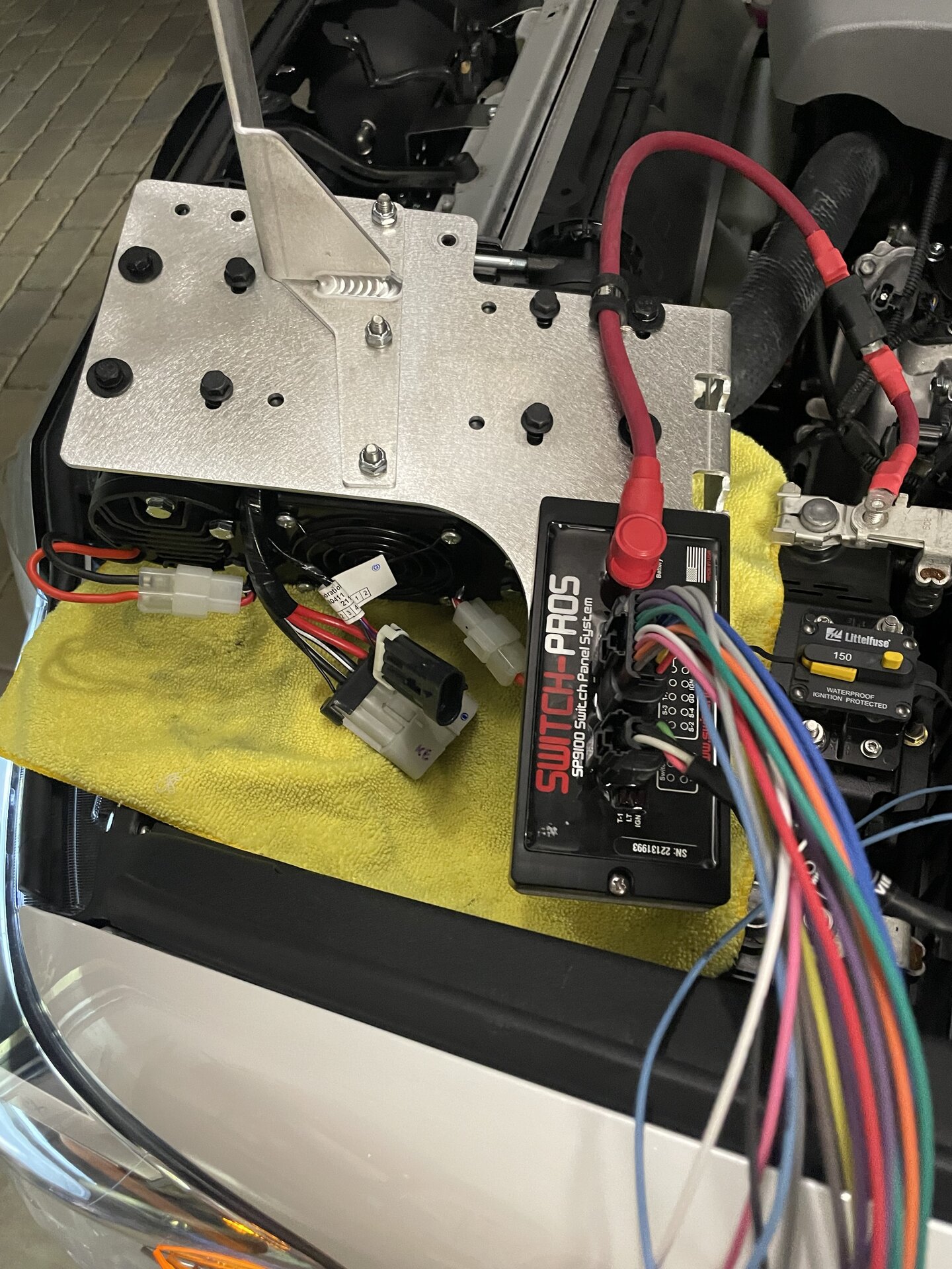

Used the rago fab ARB mounts with a minor change. After initial installation I felt more vibration through the floor than I wanted. I decided to add vibration mounts. I mounted the compressor to the bracket using QTY 6, 3/4" cylindrical vibration isolators (Grainger P/N 2NNZ8). The important specs for the vibration isolators are as follows: 3/4" diameter, 3/4" tall, M6x1 stud, 40 lb compression load, 6 lb shear load). Generally, you get better isolation with softer isolators. The downside of that is that they tend to be weaker.
My thought was that if I pull 2 Gs for a sustained period in my GX I don't really care if the compressor dislodges because I have bigger problems.
Additionally, I took a vibration isolation pad (Grainger P/N 36VZ59) and split it so that it was about 3/16" thick. I used this between where the Rago mount touches the wheel well and also the the side of the car.
Rago Fab -- Here is some free engineering for ya ;) -- My dream version of your mount has 4x .5" clearance holes to mount the compressor using the following mount: McMaster-Carr - https://www.mcmaster.com/6309K61/. In addition, I would recommend adding bushings between the support leg and the wheel well (e.g. McMaster-Carr - https://www.mcmaster.com/9311K53), and enlarging the holes on the side mount to accomodate a bushing as well.

Wiring the compressor and switch pros. I attached the switch pros to the bottom for a few reasons: 1) i don't need to access the box, 2) it prevents water ingress on the connectors, 3) provides some room up top behind the compressor if I decide to go with air lockers.

I'll post an updated photo once I clean up and disappear all the pneumatic tubing as well as extended the braided loom up closer to the terminal blocks. I used the Kaon over battery mount to install terminal mounts as well as a circuit breaker. Right now, I don't see myself pulling more than 125 amps at a time, so I have both the compressor and switch pros wired to the terminal block to make it easier to safely disconnect them from power. A few things I did here that are a little different -- I replaced the ARB fittings with ones for 3/8" tubing. I wanted to ensure maximum flow rate between the compressor, the 1 gallon tank in the front, and the Viair manifold. The above board reason for this is to maximize the flexibility of the system to use air tools. In reality, it's so I can humor my inner toddler and run a lowder air horn.
I also have a second orange 1/4" tube running back to the rear bumper. I nominally followed the KDSS lines. and zip tied it up out of the way. If I go air lockers, I'll follow a similar route. Although I have not finished connecting it yet, the plan is to put a 50 PSI regulator in at the end of the line, right before the bumper QD. This will ensure the line is supplied with 150PSI air and will mitigate any pressure drop in the line. Most importantly it will make my air system idiot proof and keep me from accidentally blowing up my Yakima Road shower when I pressurize it.
I was going to use the "wifey", but realized that I wanted access to the fuse box without pulling the compressor. I used the flat-ish part of the wifey mount, drilled a hole in it and fastened my Vaiar manifold to the bracket. With this setup, I can use a hex driver and a wrench to quickly remove the manifold for access to the fuse box. You could accomplish something very similar with a bent piece of sheet metal.
I ended up using terminal blocks for all switch pros connections. I know that, at a theoretical level, I've introduced 4 additional failure points per connection, however, I also made everything stupidly easy to troubleshoot and have secured the wires from moving around while I drive.
I want to figure out something cleaner for the grounds, so I'm very open to suggestions. Switch pros and the ARB both specified direct connections to the battery, but it is a bit ugly.
I did wire my KDSS switch directly to the battery as well. I believe this is safe based on the following rationale: Nothing connected to the wire running into the cab of the truck is grounded, nor is it attached with any kind of metal to metal connection to the chassis. As a result, if the alternator loses ground, it won't use the KDSS switch/harness as a return to the battery. If this is bollocks, let me know :).
