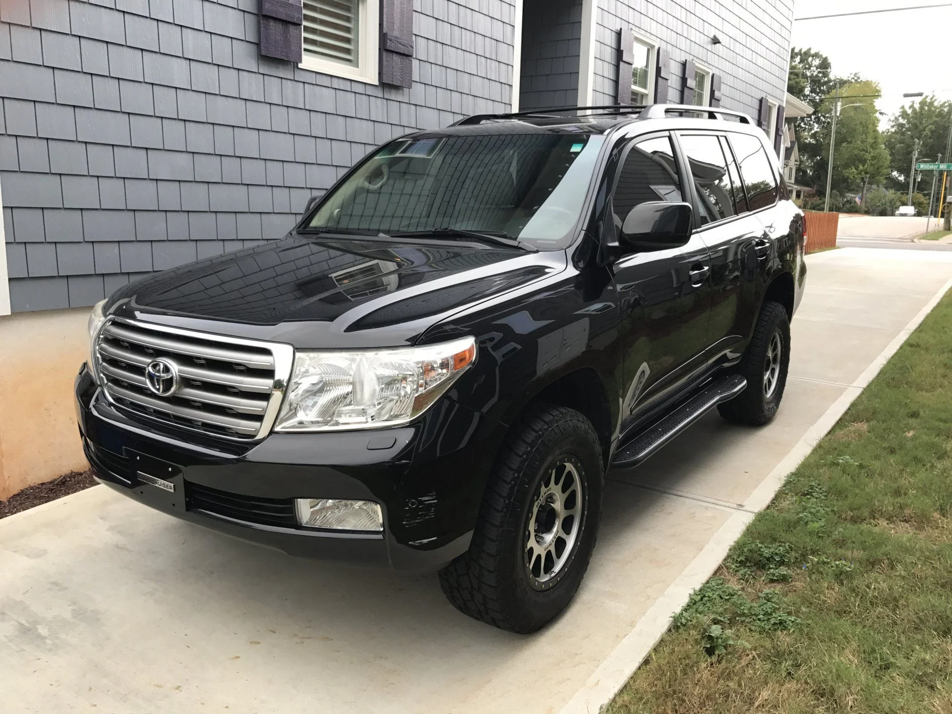

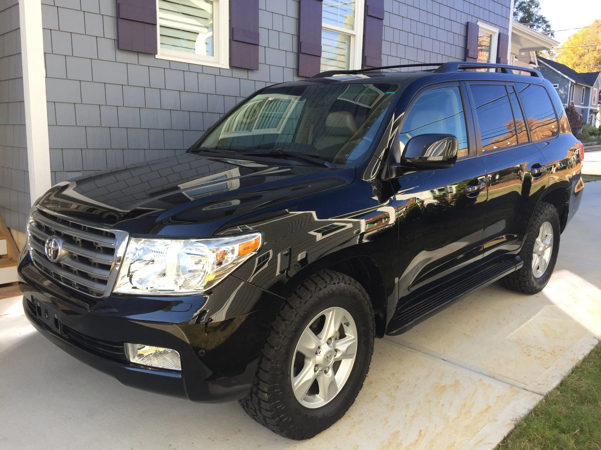

Not sure if I'm doing pics right but I've tried to attach stock and finished product.
