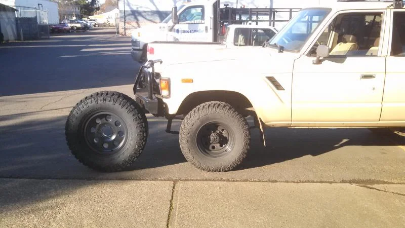

In the next few thousand miles Ill be needing to replace my Cooper STT with something.... And I will be going to 33' or 35' but I am concerned that 35s are too much for the old rig to push down the road. So what should I do???
35s and don't look back!
With 3" Beltons, no sway bars, my BFG 33x12.5x15 on 10" rims rub on the wheel wells under full articulation. I'd like to try some 8" rims and see if that helps. I will be doing a small body lift and hope to be able to clear 35's, but my 33's seem to take me everywhere I want to go. The 35" tire combination will require some mods I'm guessing, I also re-geared to 4.56, but I use (did use) this rig as an off road truck, so I preferred keeping my lower gearing. With an H55 I rarely used 1st on pavement
X2^^ gears and lift, O. The 35s will be some serious rubber OD and hard on the motor and trans IMO without gears. It's been done, but I'd expect some issues to arise, especially if you are planning on wheeling like you usually do.

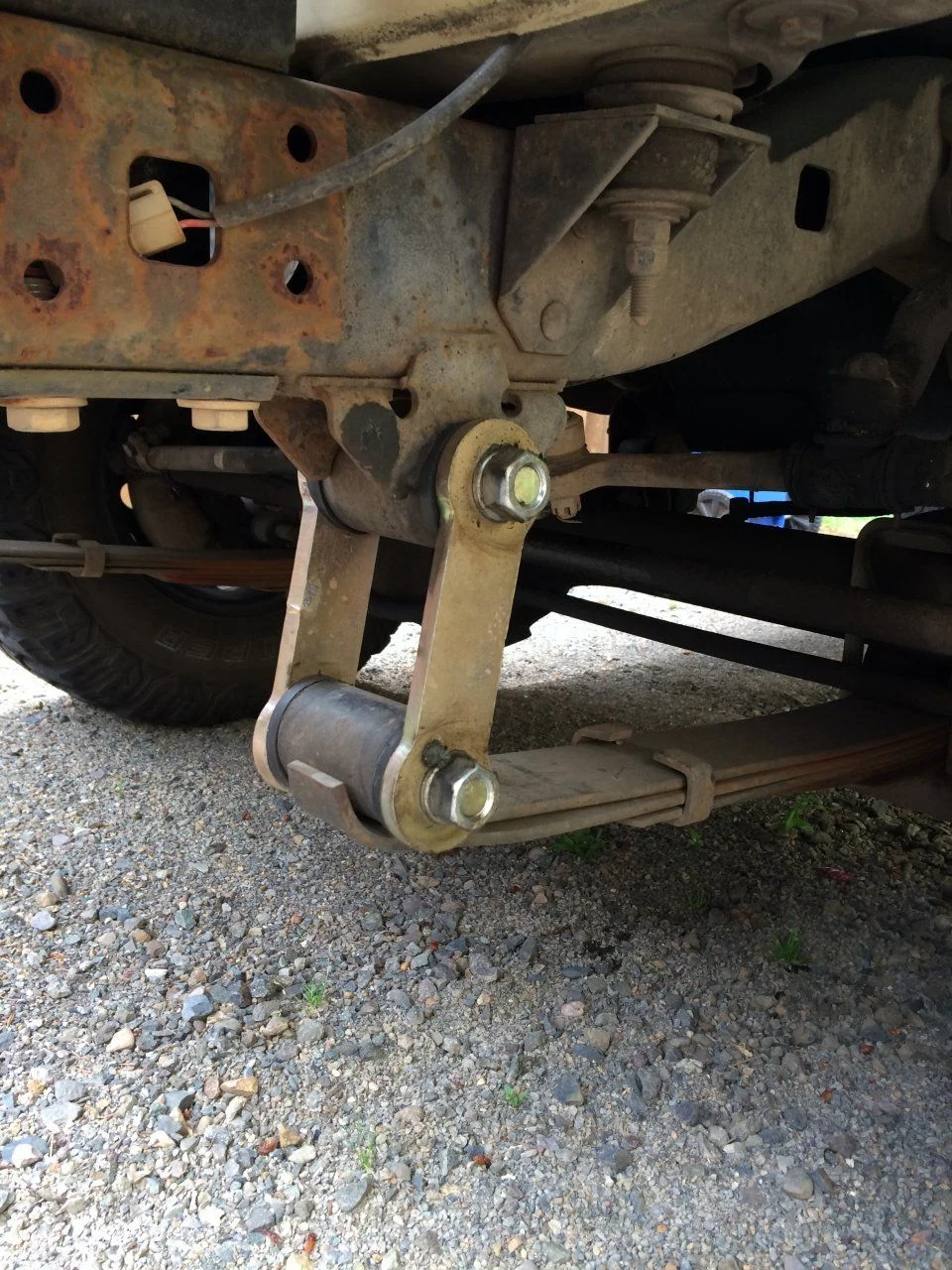

alright then, I will spare my rig the pain of 35's until have the chance to re-gear. Dont forget guys... I did do a lift... well, a poor mans lift but the AAL and extended shackles gave me 3" on a saggy OE suspension :p
Woah, crazy new digs here in mud...

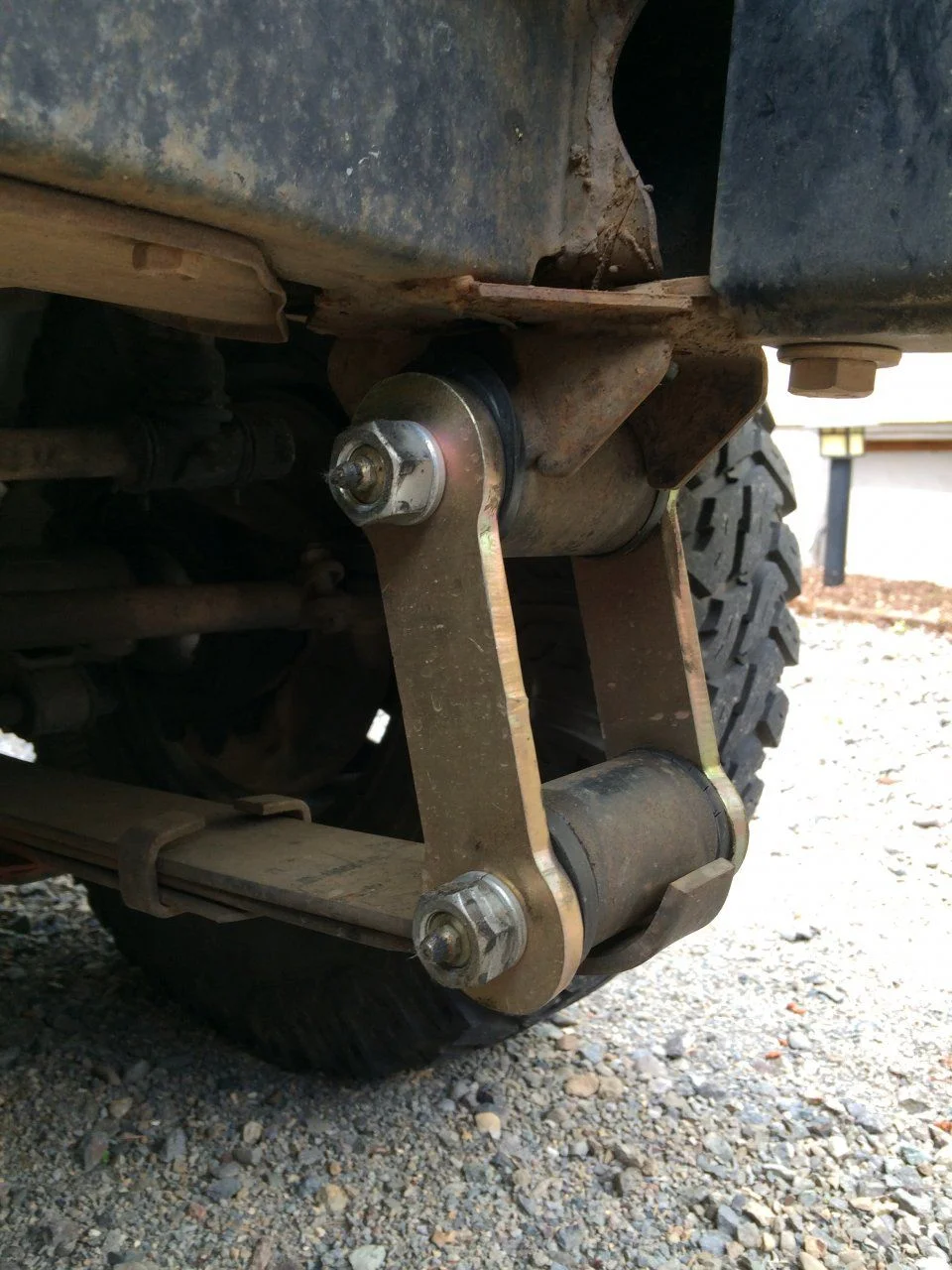

Anyway, decided to bite the bullet and order all new shackles and bushings too... Pics later :)

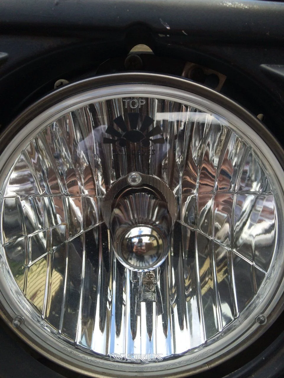

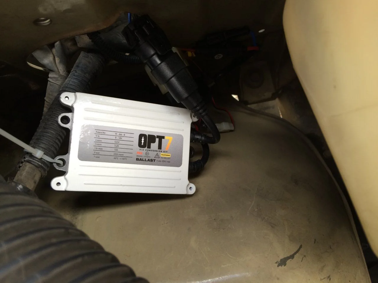

Also got the HID light kit the other day. They nicely with the "Round Eyes" conversion. I was a total noob and forgot to take a pic at night before and after... Lets just say the improvement is paramount.
