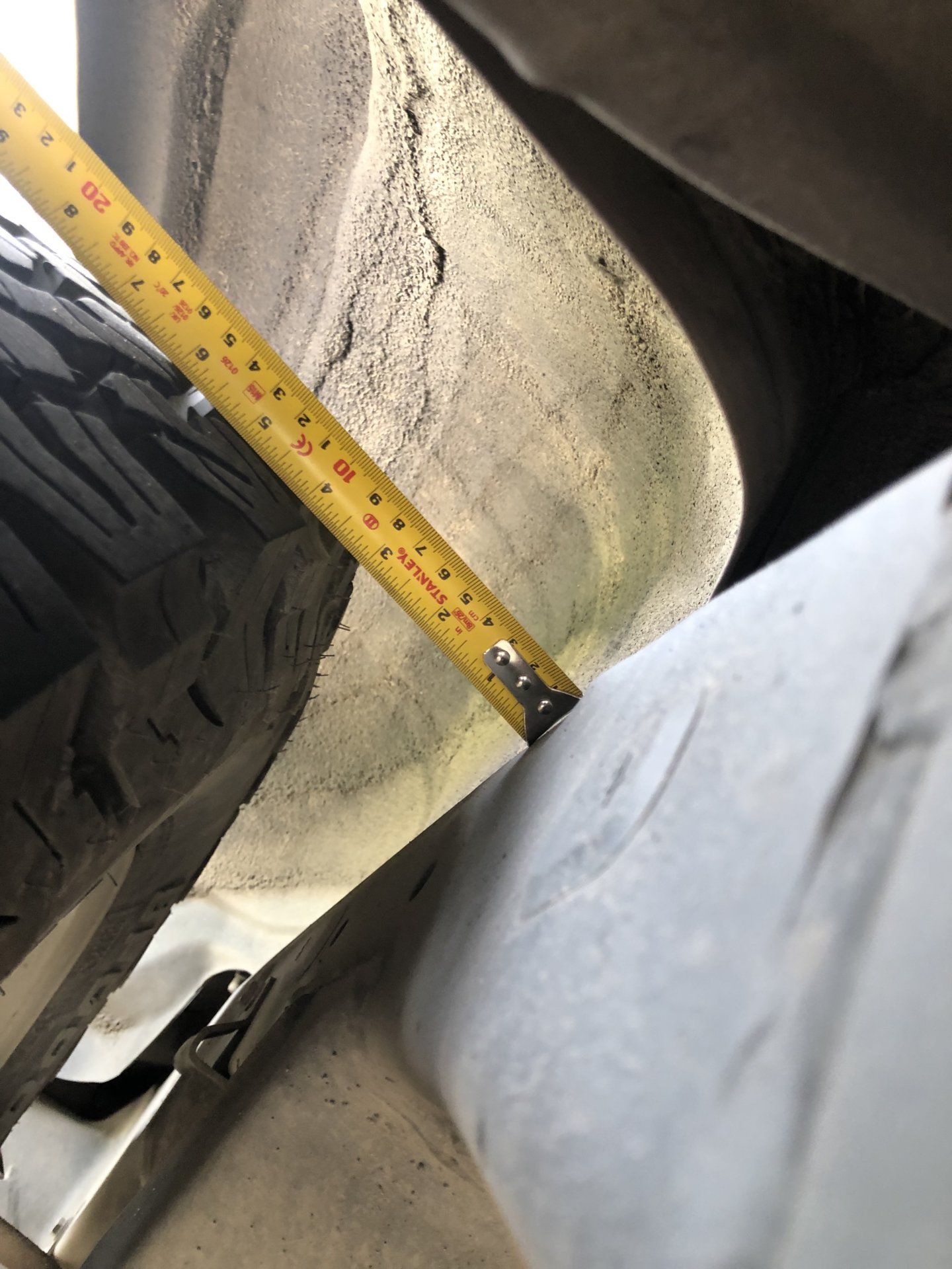

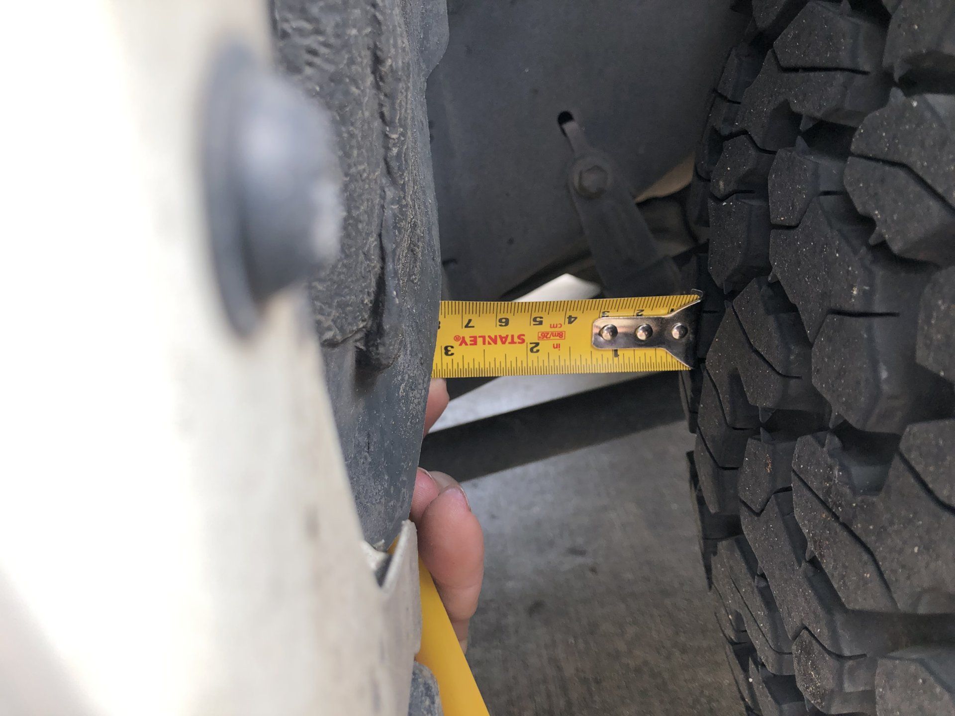

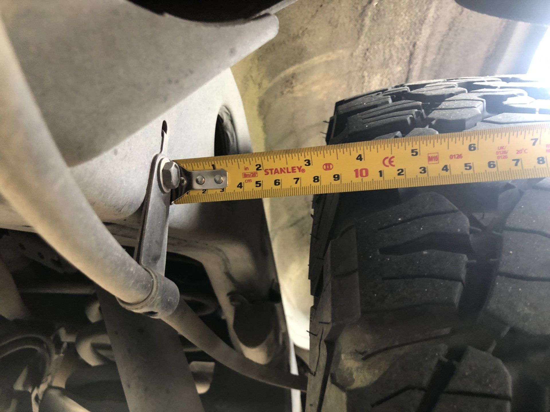

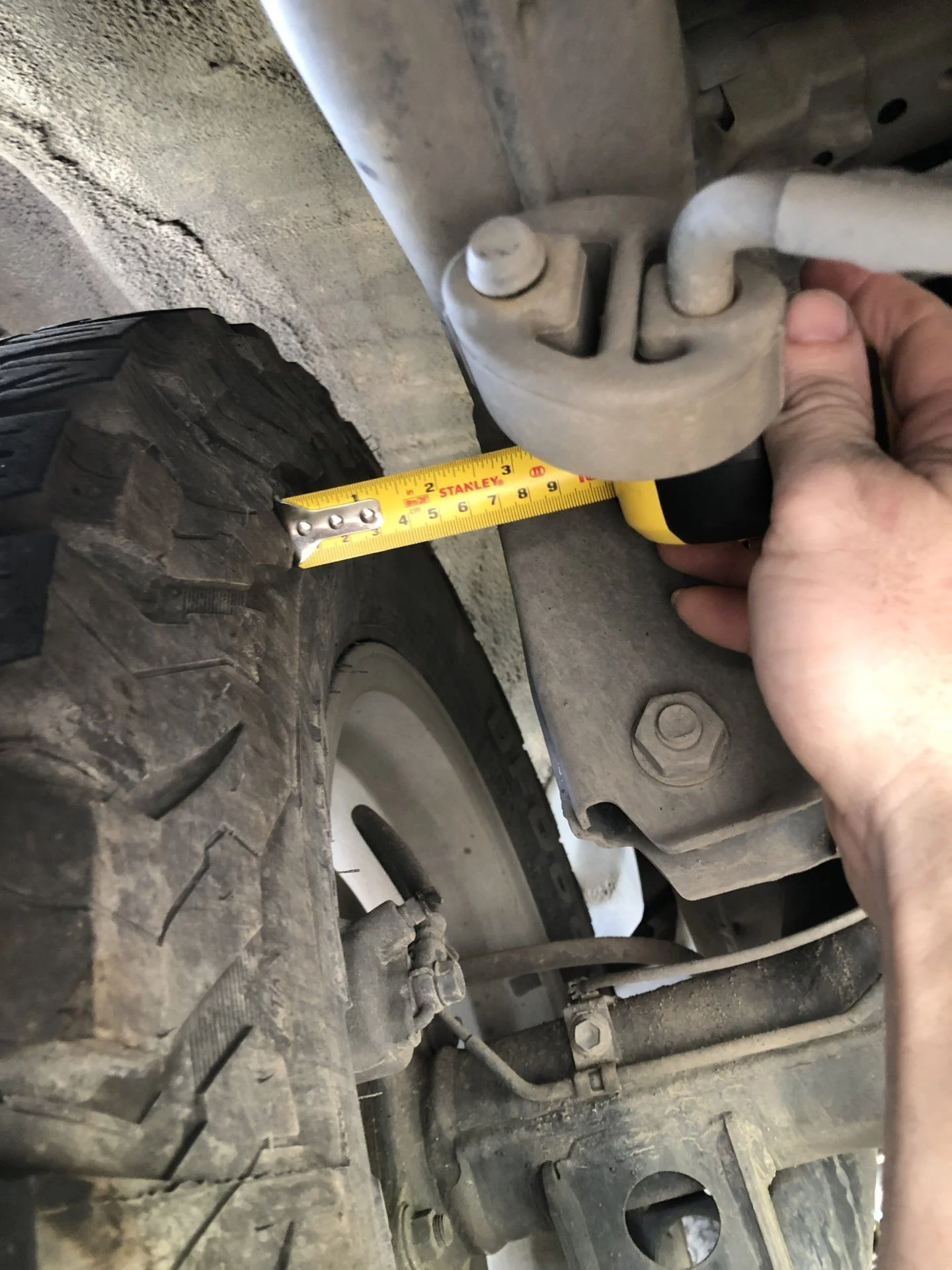

Got under the truck today to get some pics.. front will need to wait until tomorrow. The rear looks like it has plenty of room for even regular chains, s-class or low clearance or whatever they are called isn't required.
For the record my suspension is stock, though I had 2nd and 3rd row seats out so I’m probably sitting a bit taller than normal.
These pics are of the rear drivers side.. I chose it because the frame-side panhard mount was more obtrusive than anything on the pass side. Still not a problem. Other than the panhard mount the pass side appears identical.. no extra protrusions or anything to worry about.
And to be clear these are approx 17k mile LT285/65r18 E-rated KO2s running 42psi cold. They have worn some but are far from worn out.

I don’t think chains will work well on the front from eyeballing it.. but will get some measurements tomorrow.
Perfect! Just what I am looking for - thank you very much for your efforts. Very much appreciated.
I'm still very interested to see the same measurements on the front, especially around the UCA and wheel well with wheel turned.
You, sir, are a real help. Patiently waiting for your pics of the front.
Thank you.
