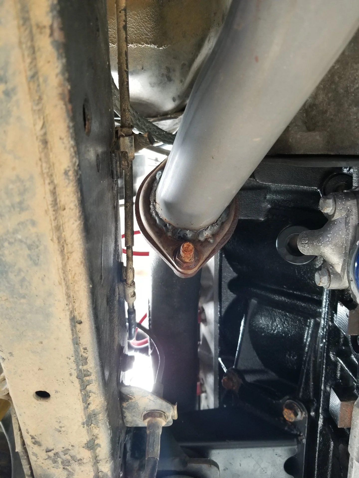

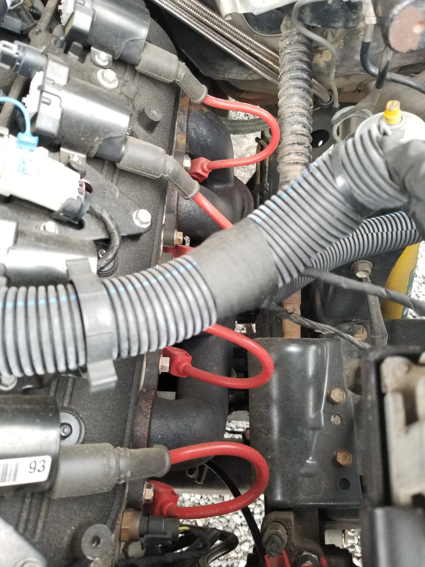

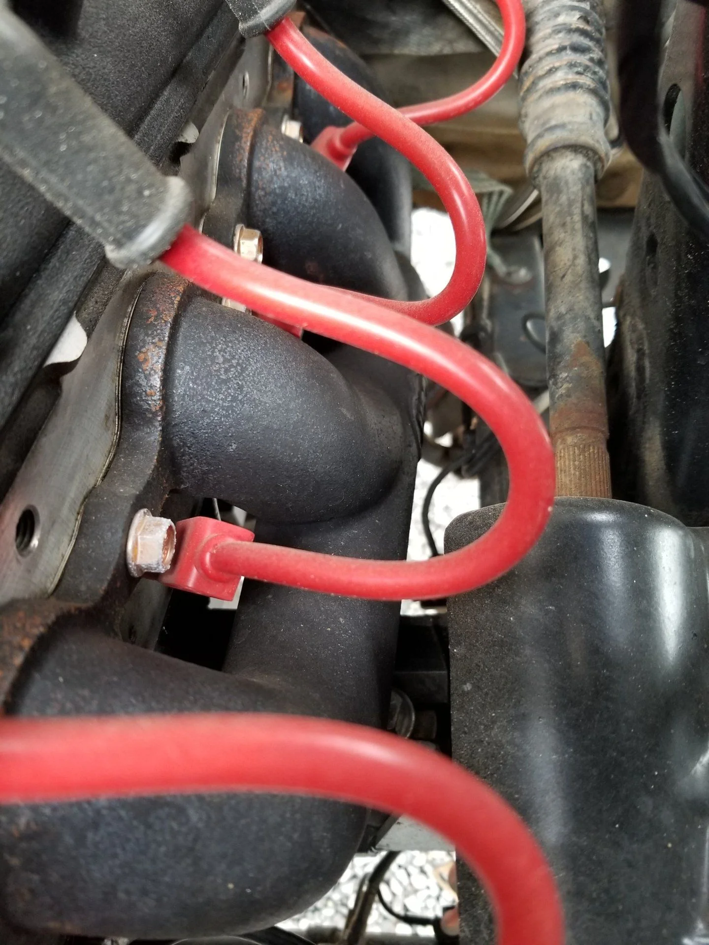

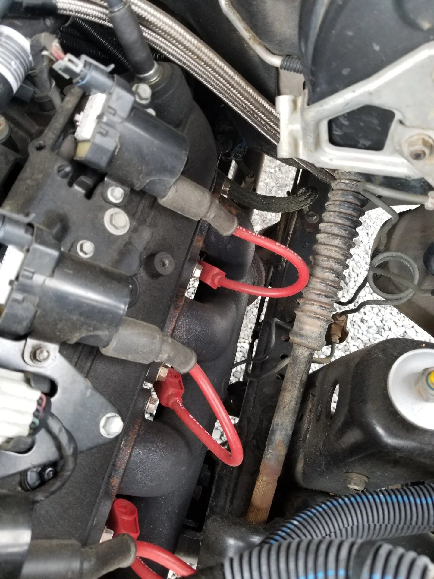

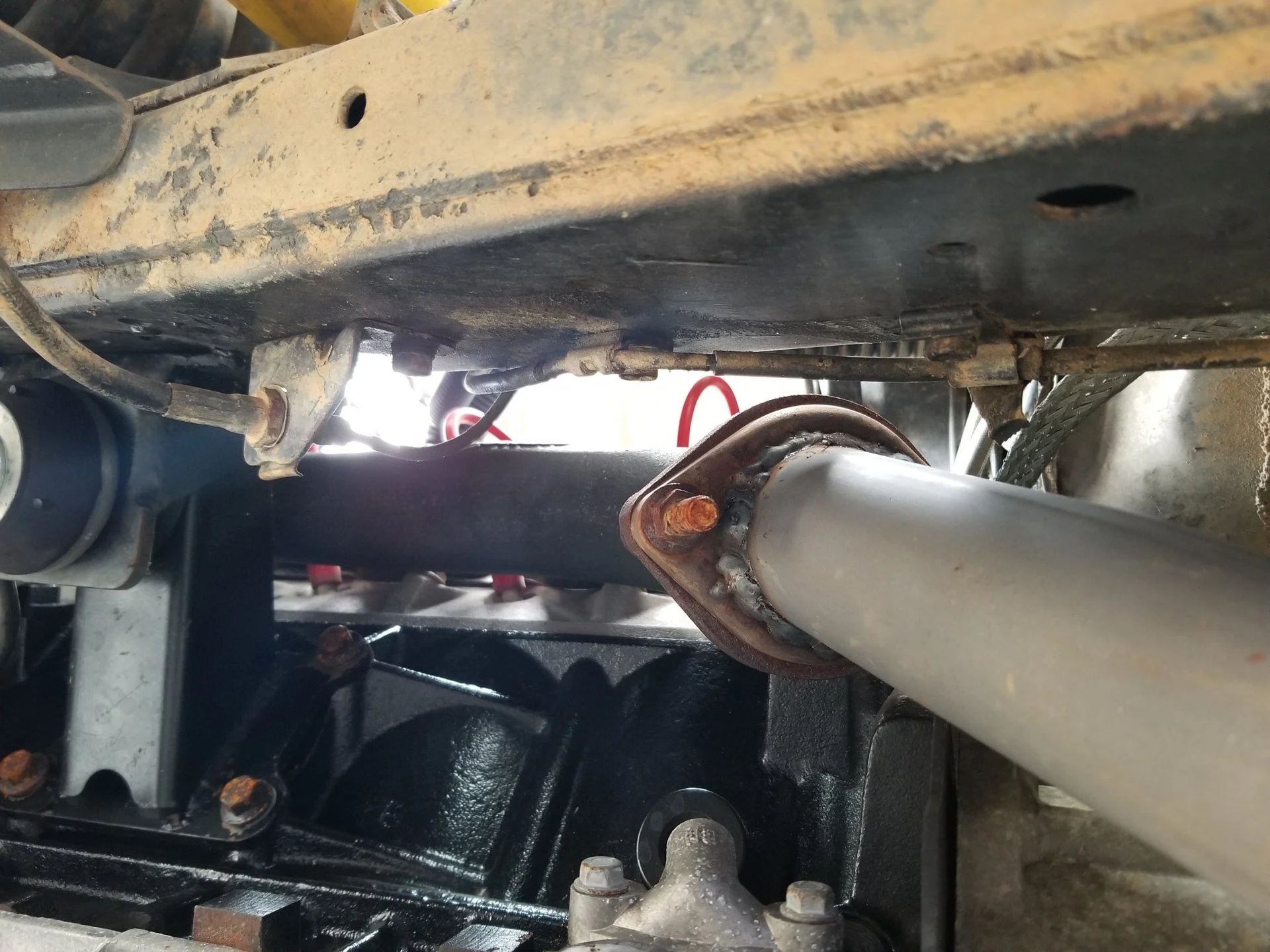

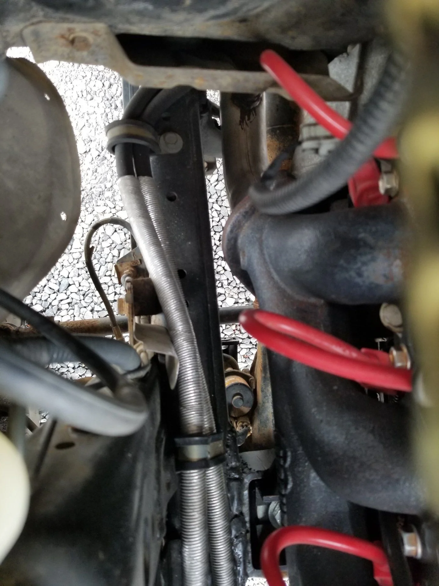

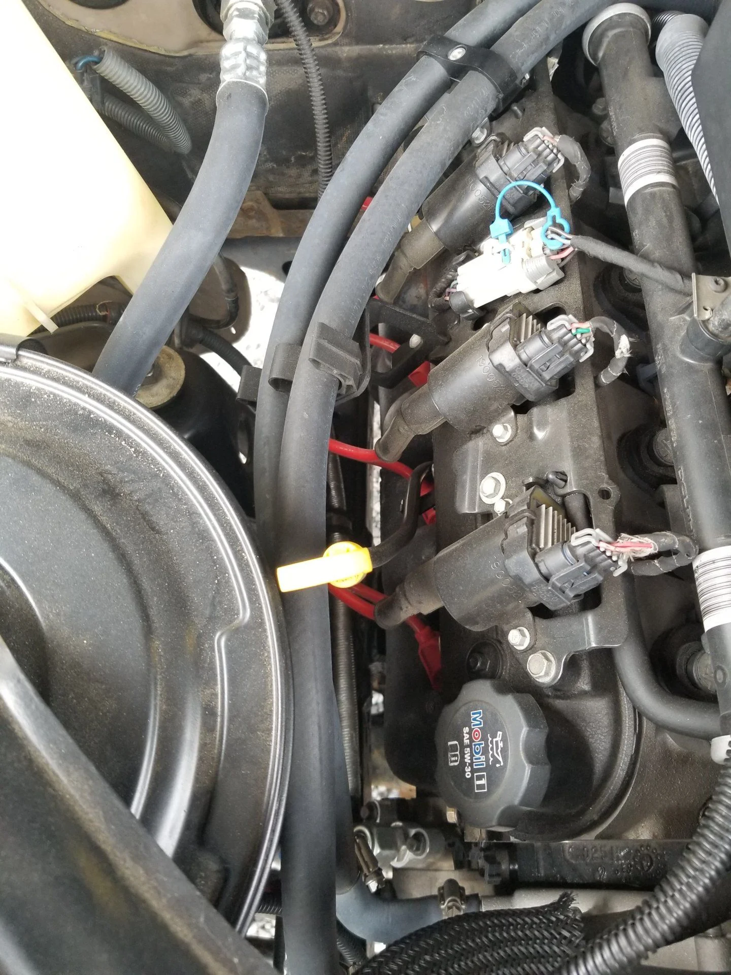

Here ya go:Can't go wrong with the hooker manifolds. I can take pics this evening if you need.
They sit high and tight, have good flow, thick flanges, and best of all, use a OEM gasket.
That is EXACTLY what I wanted to know! I can't thank you enough for these pictures.
