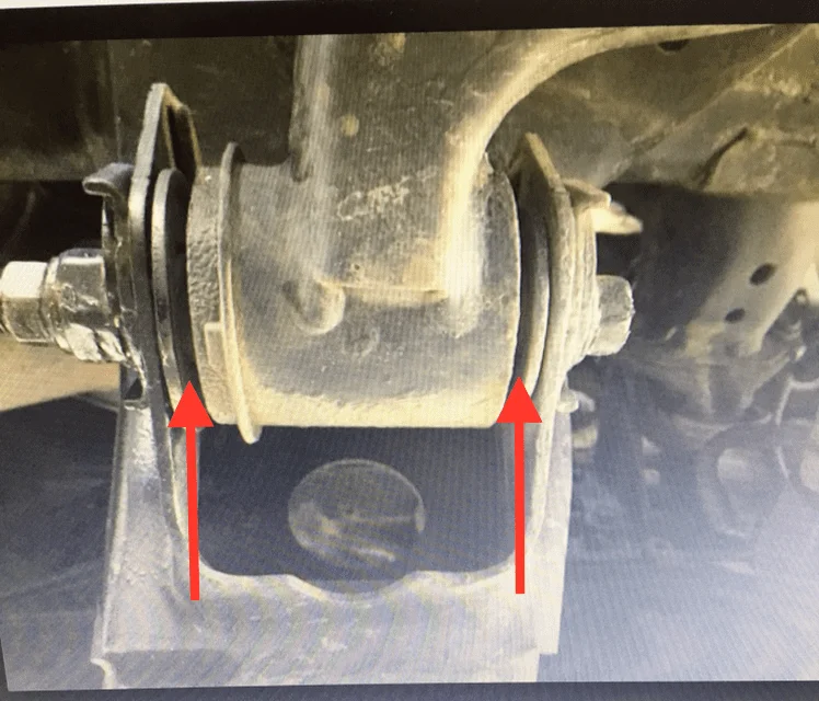

the green arrows point to the adjusting cam bolts. as the bolt/cam is turned it pushes the lower control arm further from the center of the hole. the SPC part, replaces the bolts with new hardware and a plastic sleeve to keep the bolt from rusting to the frame.
the tool is just a modified clamp used to push the old bolts out. i would start applying PB blaster, or your favorite rust breaker/lube every couple days to start soaking the hardware a hopefully breaking up the rust. SPC has a disclaimer on the product description that says the tool may not work if bolts are too rusted in place....take that for what you will. even they know its not a guaranteed solution.
