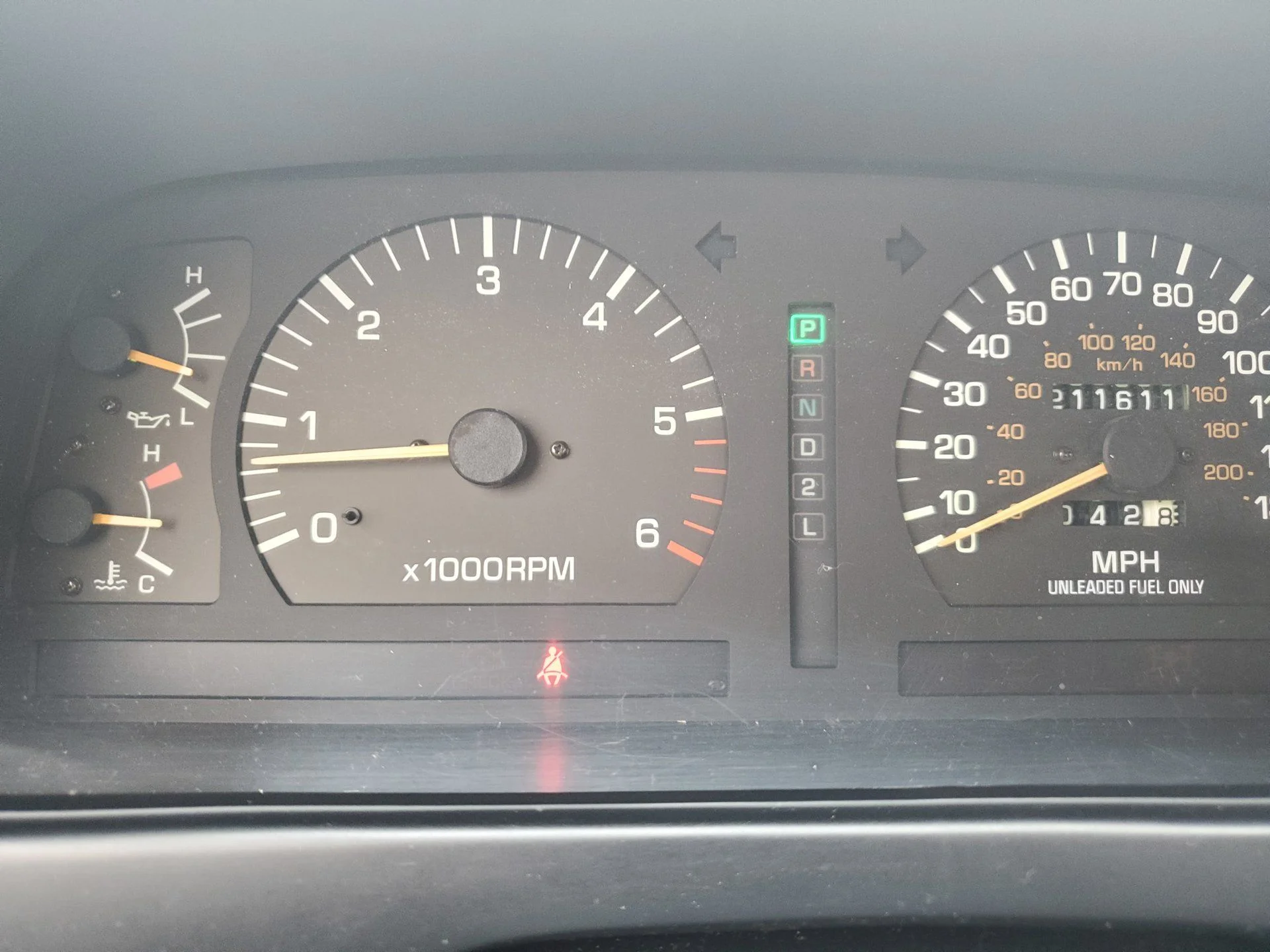

This is where my 93 idles after warmed up. It does climb to the halfway point as I add throttle. Believe I used 10w30 castrol on last oil change.
Hi and thanks for posting. Unless you have calibrated that gauge (method in my long running thread) then it will not represent what is really happening in the engine. It is fiddly but worth doing.

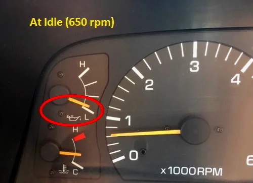

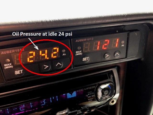

This is such a common post on 'MUD' (perceived low oil pressure at idle). I was sitting on the highway this morning (traffic was stopped) and while waiting...thought I'd take a couple of pics...just so folks won't worry.
My Land Cruiser has 315K miles on it. I have both the factory sending unit and gauge hooked up as well as a digital gauge and separate sending unit to monitor (and compare) my oil pressure readings.
IMO, as long as your engine isn't 'knocking' you've got plenty of oil pressure.....so don't fret about the position of the needle on the gauge. Oil VOLUME is quite another matter. Don't let your engine get too low on oil. But pressure. Put it out of your mind.
Toyota/Lexus 1uz is 4psi at idle. Not sure what info that trivia reveals, except that sometimes Toyota designs it that way.
4 psi 'minimum' actually, but yes.....alarmingly low I thought...first time I read that. But I've never actually seen mine below 15 psi.

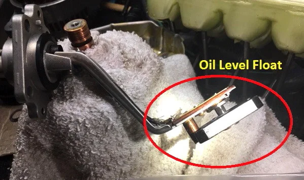

Oil 'warning' light is the oil LEVEL and separate from low oil pressure (for which there is no light).
Use the engine oil Dip Stick to determine the true level of the engine oil. IF you require empirical evidence for sufficient engine oil 'pressure' then install a mechanical gauge to satisfy that worry.
The engine oil level sensor in the oil pan is known to become 'sticky' in some instances and can cause an intermittent dash light. On the other hand.....it may be working perfectly and you might be low on oil, so check the dipstick.
OIl LEVEL Sensor:
OIl LEVEL Sensor:
