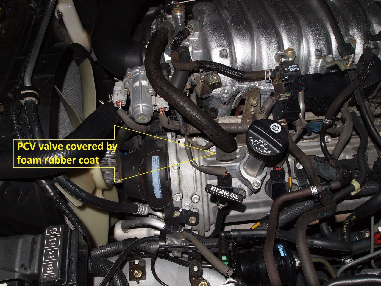

Where is it located on the engine? 1998 LC.

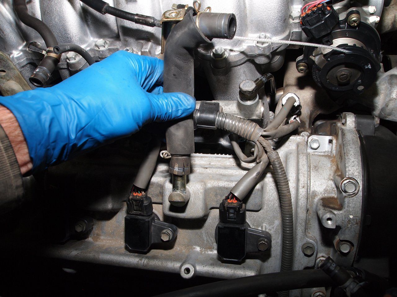

DS PCV valve: HOSE & VALVE & Foam rubber cover & Grommet:
PS side PCV hose cracked:
