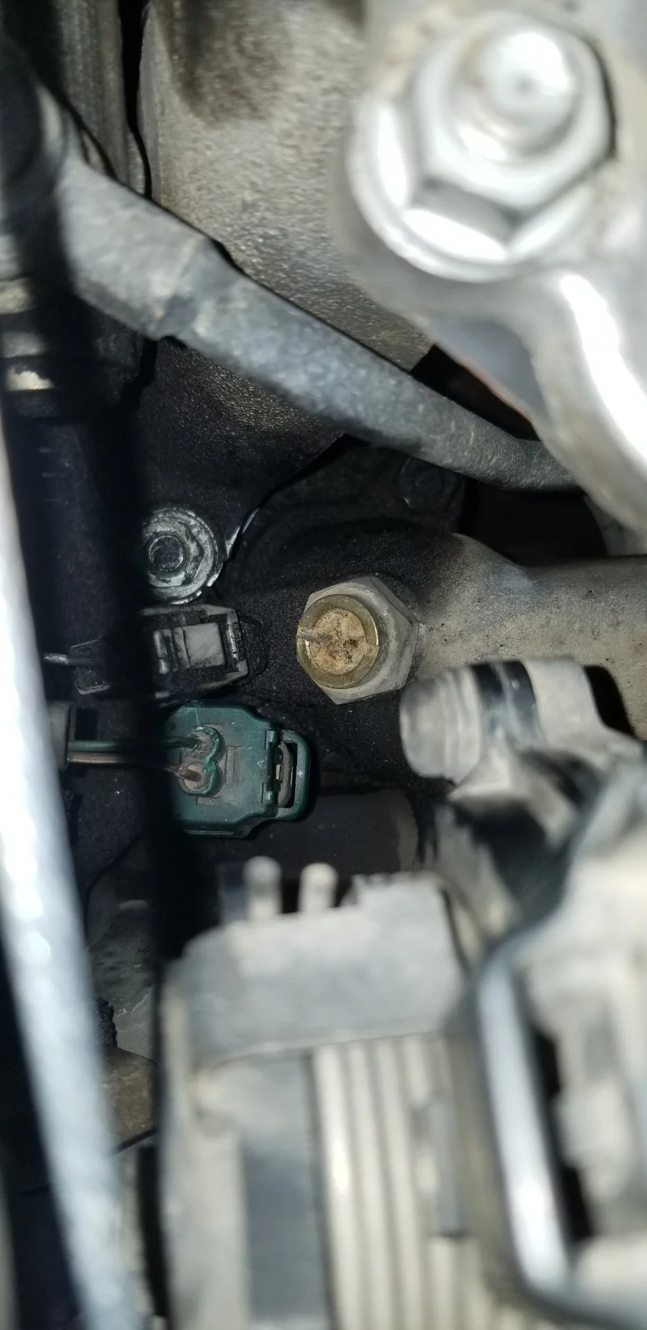

The black sensor closest to the starter had a broken clip when I got to it. I pressed it together an put a spot of JB Waterweld putty to keep it together just in case.

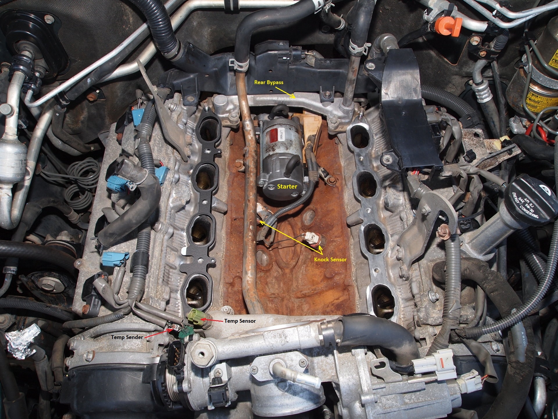

That would be your right bank Knock Sensor. There is another one on the drivers side in the 'V' of the engine block. There is also a Temperature Sensor *green* at the front of the engine valley that is easy to damage. It is right next to the gray temperature sending unit to your dash.
The knock sensors were undamaged as far as I know. The sensor I was referring to is right next to the starter itself. However, the temp sensor you identified is damaged. I don't think I did it, it looks old but...anything is possible. Could that cause the idle issue?

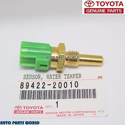

Analog gauge is based off of black plug. Green goes to ECU/OBD2. I'm surprised you don't have a CEL. If ECU thinks engine is hot due to bad sensor, it may cause idle/stalling. I broke mine while doing starter and replaced it with an aftermarket sensor from the auto parts store.

Good news! Replaced the temp sensor, and it started strong! Idled smoothly at 900 cold and warm at 700. I bought a stethoscope and the ticking seems to be coming from the injectors. Cleared the codes and took it for a drive, drove great and no codes were given afterwards. Thank you guys for your help.
