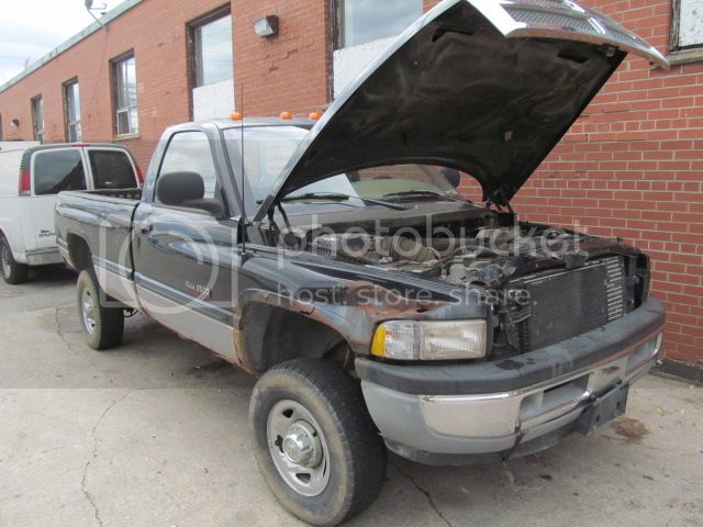

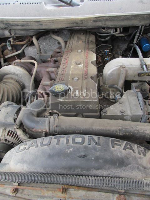

so my rig has been sitting over over a year, i was out in alberta working. now im back in the gta and i went and bought this the other nite from ottawa. its a 24valve w/intercooler, nv4500, dana 60 front, dana 80 rear. the body is completely rusted. i took it out around the block last nite, the motor runs great and the transmission shift very smooth :D
Nice Cummins!!
Thinking about throwing that into your 62?
im cleaning my buddys shop right now so i have space
Badass!!! So many cummins motors going into cruisers these days :grinpimp:
