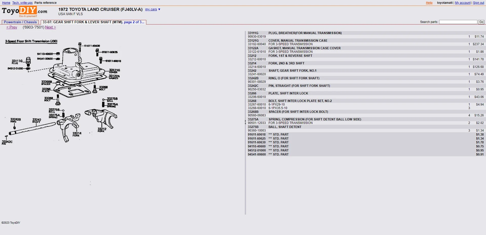

this is a FJ40 H42 with a Broken DETENT BALL Spring
- POST REPAIR

my WAG is there is something in the top shifter plate, or atleast that is where I would start.
How would I figure that out? Just take the top cover off?
yes, remove the trans hump, then the tans top cover where the shifter goes thru
it will make sence when removed
take pics and post if you have questions
