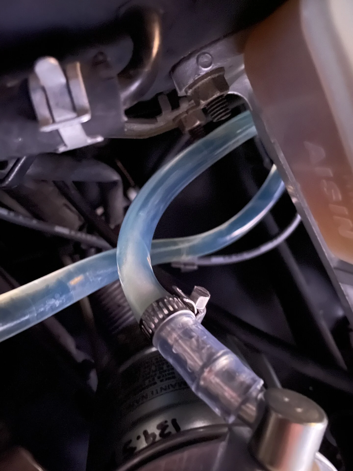

Run a piece of clear hose from filter to IP and poke it out the side of the hood so you can watch for bubbles.

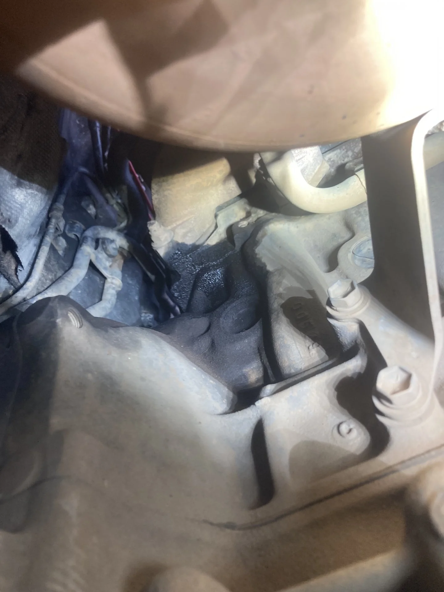

I don’t know if this is contributing to my problems, but I noticed this wetness at the back of the head…..head gasket weep? How worried should I be? It’s definitely coming from between the head and the block and not leaking down from the valve coverView attachment 2726022
I would not be losing any sleep over this

Narrowed it down by using clear PVC tubing in place of the fuel line. First from the filter cap back to the last section of hard piping (@ the firewall) then from the filter cap to the main tank. Bingo, no air bubbles.
Drove it back home and while underneath looking at the sub tank, realised it was empty and that's where the 'air leak' could be. Put 20 litres in and connected the fuel lines back as normal except for the last section to the filter cap, so I could watch for bubbles.
Selected the Sub tank and fired her up. Watched the bubbles gradually disappear and went for a drive, gave it a good workout. Symptoms gone.

My video. I think you need an 8mm ID hose. My leak was around the fuel filter. It would run if I pumped it now and again.
That's a lot of bubbles?
Sure was. The engine would peter out and I had to pump it. I dont know what I did wrong that day. I had the filter on and off 3-4 times.

I had a new Toyota hand pump/ filter sitting on the shelf, along with all new 10mm line. I installed all of them and all the soft lines all the way back to the tank. I installed clear vinyl line between the hand pump and the hard line on the firewall and confirmed I am still getting air in the system.
The 1HZ isn't running bad aside from the noise I heard from the injection pump (around 1300rpms) as I riffle through the gears until the truck has warmed up, I presume after Ive got enough air out of the pump it doesn't make anymore noise.
My question is there another area that I could be leaking air in besides the hand pump and the soft lines? The truck is not rusty and none of the hard lines appear to have any damage.
Hard to tell but it was dark and the live action picture turned all the bubbles into cloudiness in the photo.
