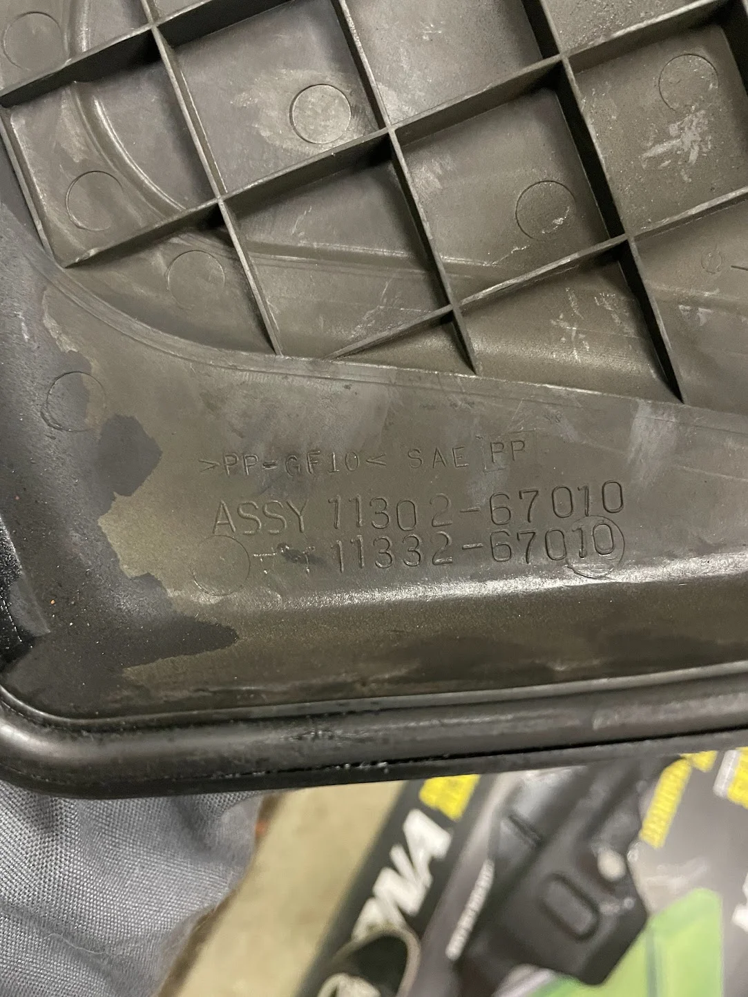

Hi everyone,
As I was inspecting my timing belt I found that I the screw holes for my belt covers snapped off w/ PO. Looking to replace the cover but I can't find any on amayama, toyota, or partsouq - my usual parts dealers.
Part number: 11302-67010
Original Pics:

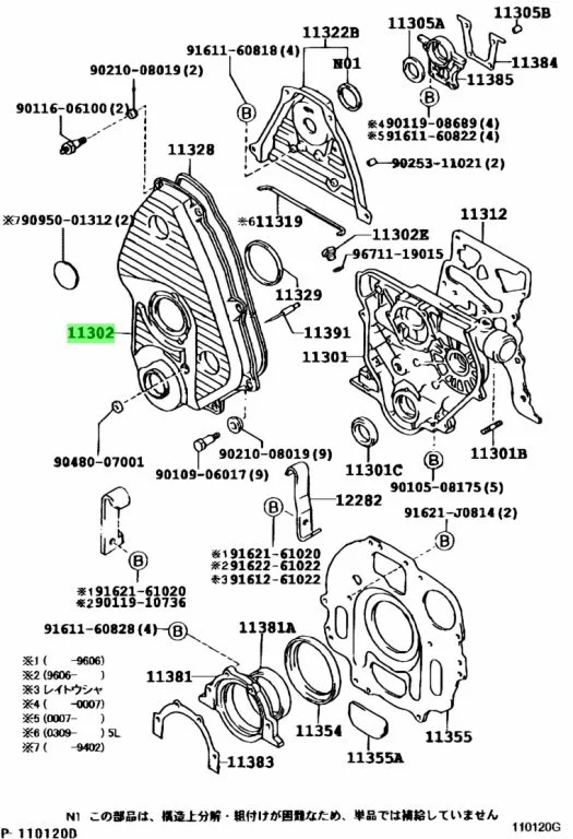

The one amayama rec's as a replacement wont fit, i'm pretty sure
Thanks to anyone with some suggestions!
It seems like the cover part number is actually 11332-67010 by itself. Assy part number that you are using may include other parts such as the gasket or clips (not sure).
If you use the 11332-67010, there are some listings for used examples online.
Not sure what happened at Amayama, but the parts diagram above is for a 2L-TE rather than a 1KZ-TE, which is why it looks so different. I'm finding 11302-67020 as the recommended assembly part number at Partsouq, though they don't have it in stock currently. Megazip might, but they don't say.
