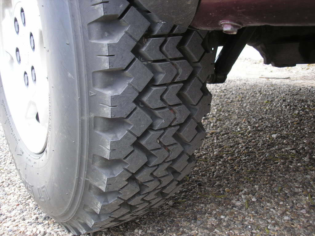

I'm getting my stock split rims back and I'm looking for the same type of tires from the factory that came with them. Size , tread, trying to keep it real.

Original tire for your truck would have been a Dunlop Powersnow 7.5x6, I still have 4 of them - weatherchecked though!

LT285-85/R16 is close to the original 7.5x16. I bought a used set off of kijiji, they look good.
