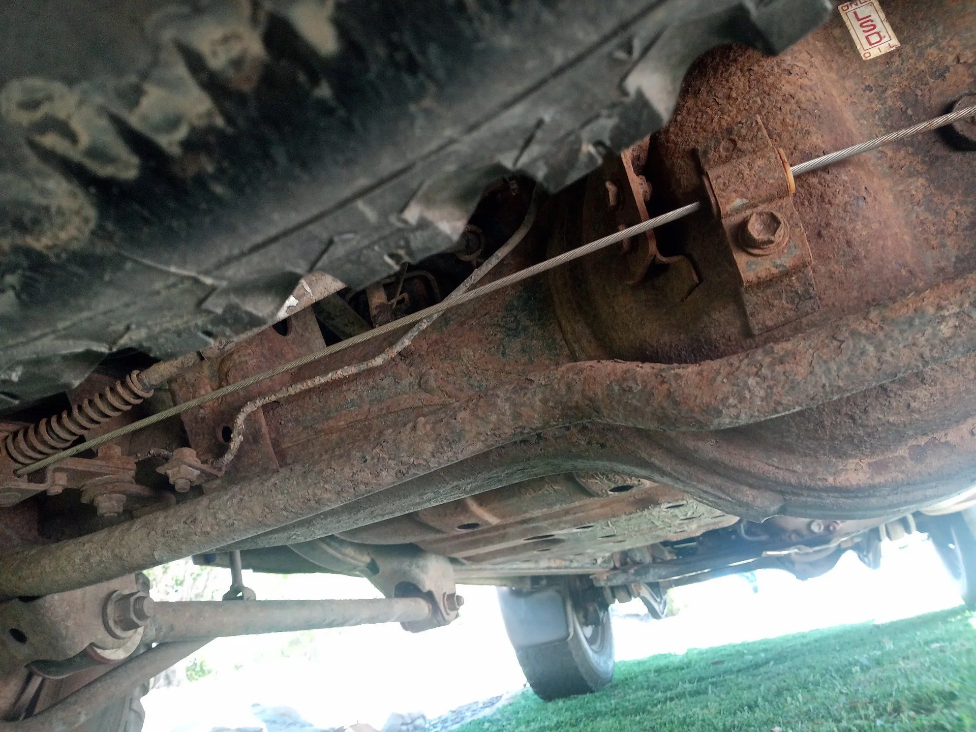

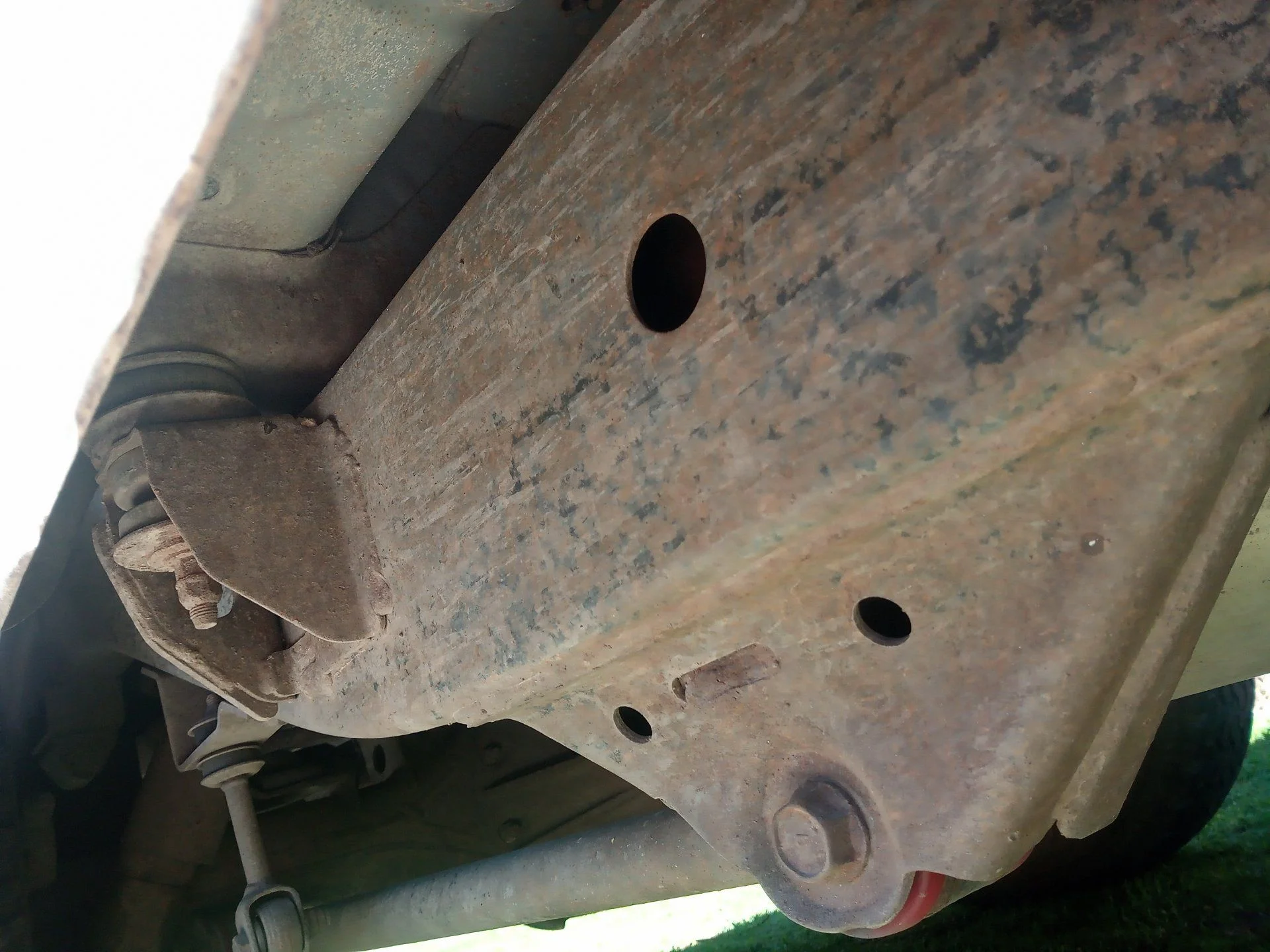

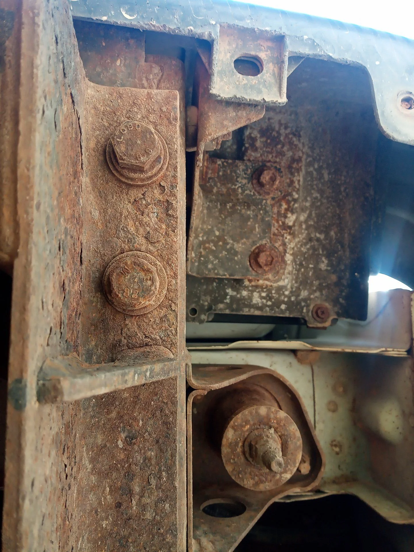

Also have a lot of rust on my rear diff, some chassis surface rust, brake line corrosion etc. Do these pictures look bad? I'm hoping to keep the car for a while and want to slow down the rust as much as I can. Don't wanna cover up with paint. Think a wire wheel, some lanolin and Penetrol will be good enough to slow down the rust without covering it up? Or should I paint the undercarriage? Never had a car this old before
For the paint, sand down to remove all rust then prime and paint. (you really need to remove all of the rust or it will come back like you see. Take your time and clean thoroughly between each step.
The rust is not great but not salt roads bad. It can be fixed and if you do it now, you will prevent it from getting worse.
Wire brush/wheel (this part is key) Rust flakes will trap moisture. Then use a rust converter. Finally either paint or spray with woolwax or fluid film. For the future, paint can look like your hiding the issue. Also if you did not prepare it well enough, the paint can trap moisture(like you have experienced). On the flip side, you have to apply fluid film or wool wax every 6months to a year.
