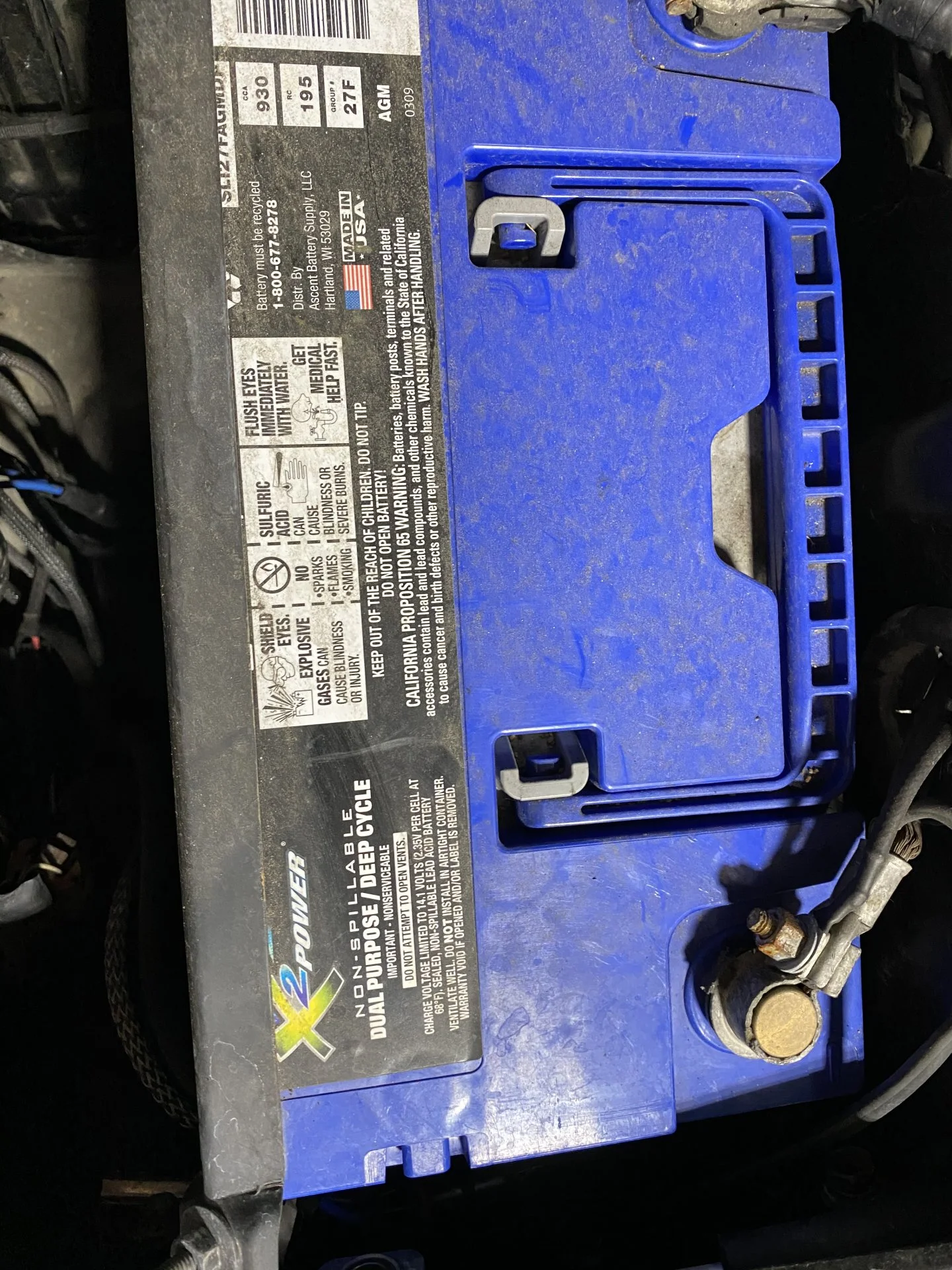

I’ve been using a group 27 X2 Power battery with good results for the starter battery. The last one lasted about 5 years.

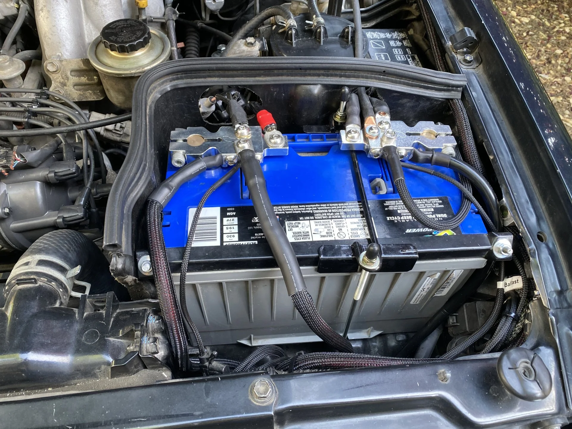

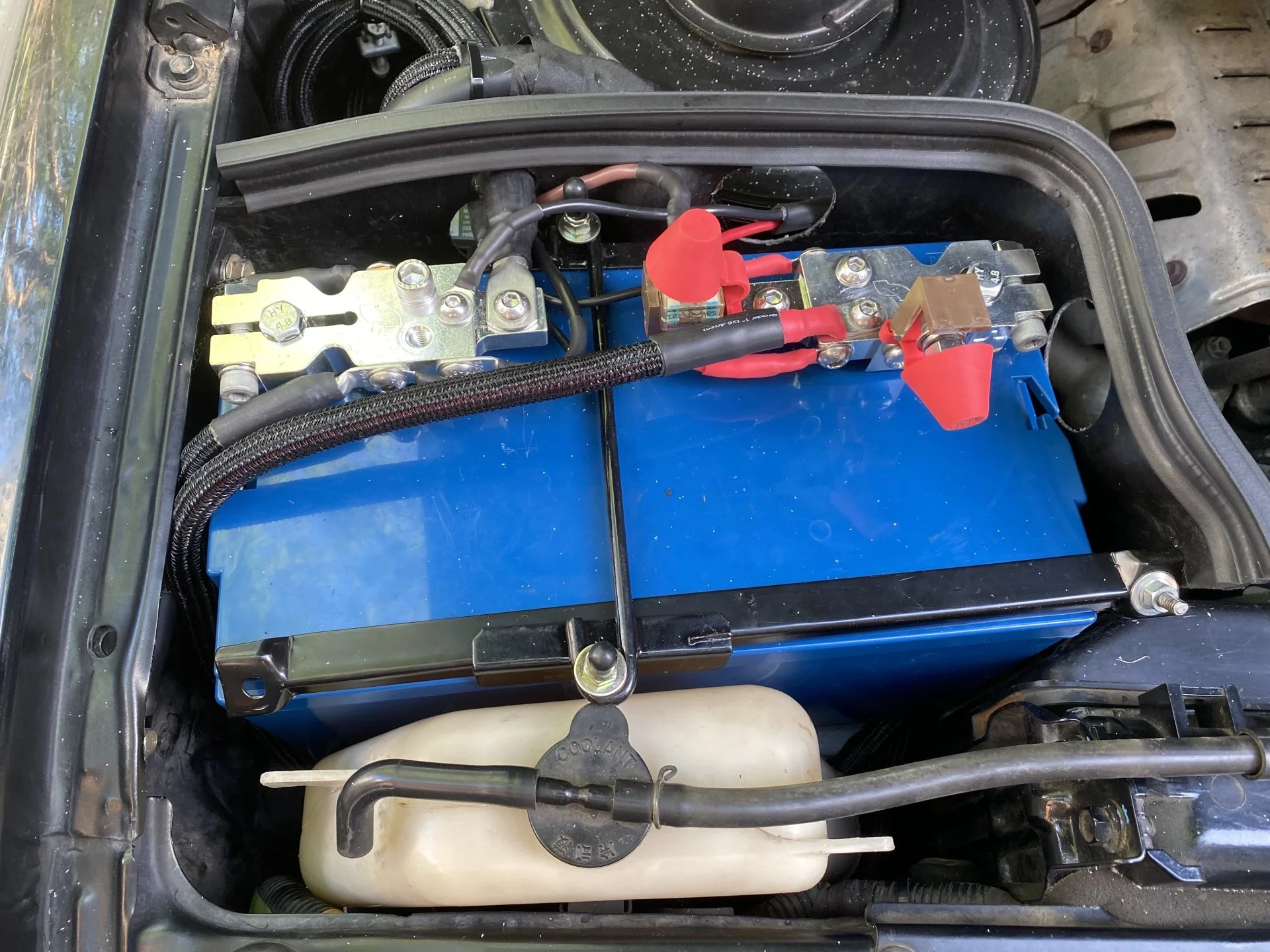

While you’re in there, consider adding a
Land Cruiser Products additional hold down to add strength and solid hold for your battery. I use the LCP battery bracket with the stock bracket.
