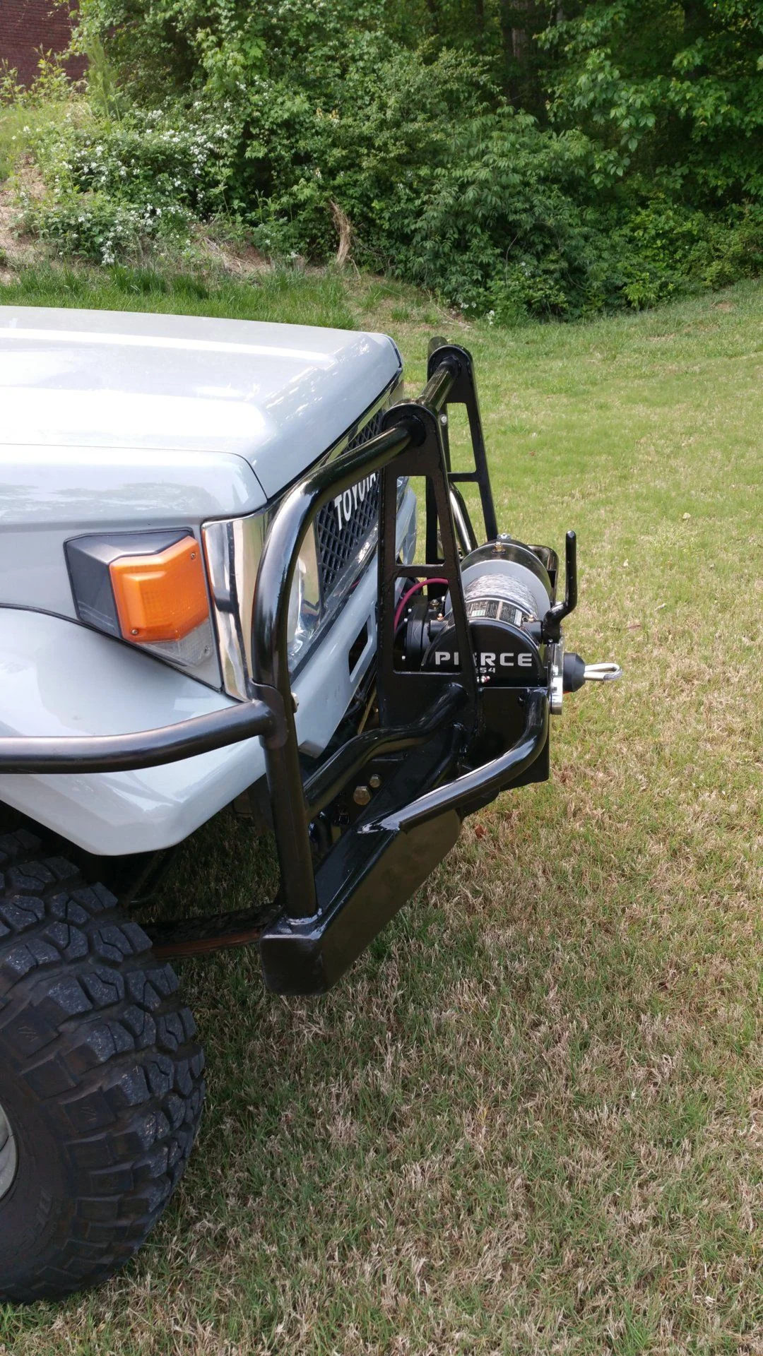

Joe,
Finished the bumper modifications last weekend, but painting and re-installation delayed roll out until this evening. Here are the pictures that I promised.
