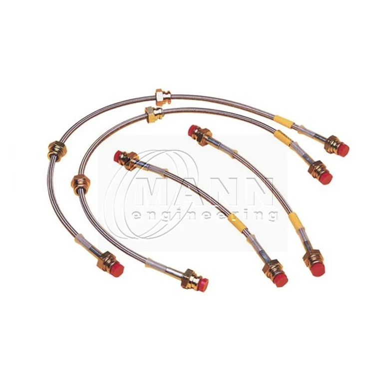

Why would you need the lines from the axle to the calipers to be longer?
Unless your running portal axels wouldn’t that distance remain unchanged?

Not for the rear, but for the front possibly.

Messaged Slee through their website. Their response was that the fronts are slightly longer than OEM brake lines, but that it wouldn't matter, as the front brake lines are not a limiting factor before other geometry issues arise when doing a longer travel front end.
It's necessary for the fronts and rears. I'll be honest I should replace my rears, but I just bent a bracket to have more slack. On my todo list. Thanks for the link above.
Well, in light of not finding an easy solution for extended brake lines, I just ordered the Stoptech brake line kits for LX. Stoptech say it's the same part for both Tundra and LC/LX for the rears (so maybe it's longer?) and then there are some posts in the OEM BBK thread that suggests that possibly the Stoptech brake lines for the front are longer as well. We will see, I'm not overly optimistic on either front.

Sorry, missed this. I used a front extended set that is meant for a 100 series, but also fits the 200 series.
Well, I'll just wait and see what happens with my Stoptech lines. Maybe I'll get lucky and they will be extended by default. Otherwise, I'll look into these or the other lines for a Tundra that were referenced earlier. Ordered from Jegs, so maybe i can even return them if they aren't what i want. Or pass them along here, surely SS lines is a fairly common upgrade.
