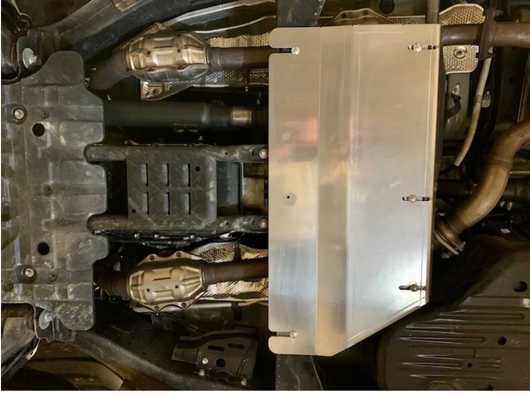

If the frame and fasteners look good now, I wouldn’t worry too much about the history. You could bring a bottle jack and take off one of the wheels and see how corroded the fasteners are, the back of the wheel, the dust shield to make sure there’s not been a cosmetic cover up of rust on the frame.
Cheers
Also, this black “H” shaped skid seems to be a canary in the coal mine. Give it a check if you’re concerned.

Also, this black “H” shaped skid seems to be a canary in the coal mine. Give it a check if you’re concerned. View attachment 3442806
Thanks for this tip. Do you mean that the backside of the H skid plate shows rust itself or that it conceals rust behind it. I'm looking for a 200 Series, so I appreciate the tip. Cheers.

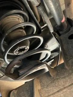

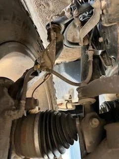

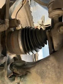

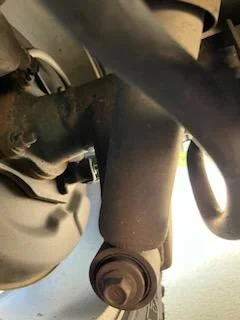

I have not been able to test drive the 06 Land Cruiser yet. Just pictures, dealership history and talking with the owner. Trying to do as much investigation as possible before I make the longish trip to look at it. Unfortunately, the owner gets back Sunday for us to FaceTime the vehicle, but for now I only have this low res pic to show. Is this the H plate you are talking about and should I be concerned with the plate itself rusting, or what's behind it (probably both). I guess I'm asking if I should take it off to have a look. And the 06 has had its timing belt, water pump, CV boots, brakes, AHC and all fluids done replaced and checked.

I just realized your picture is probably of a 200 series. The 2015 LX I'm looking at is really clean underneath. Here are a few more of the lower res pics I have of the 06, the underside seems clean. Is there anything that stands out from these?

Toyota calls the H-shaped part an "oil pan protector" 2008-2021 Toyota Land Cruiser Protector 51440-60080 | Toyota Parts Center - https://parts.olathetoyota.com/oem-parts/toyota-protector-5144060080?c=Zz1ib2R5JnM9c3BsYXNoLXNoaWVsZHMmbD02Jm49QXNzZW1ibGllcyBQYWdlJmE9dG95b3RhJm89bGFuZC1jcnVpc2VyJnk9MjAyMSZ0PWhlcml0YWdlLWVkaXRpb24mZT01LTdsLXY4LWdhcw%3D%3D
A few folks have posted pictures of these rotted completely through. If the 200 you're looking at has this piece and it doesn't look like it came off the Titanic, that's a good start.
The five photos posted above look good to me for that mileage. Those touches of rust on the CV and flange on the rear axle don't bother me. But, these are also the smallest undercarriage photos possible...
