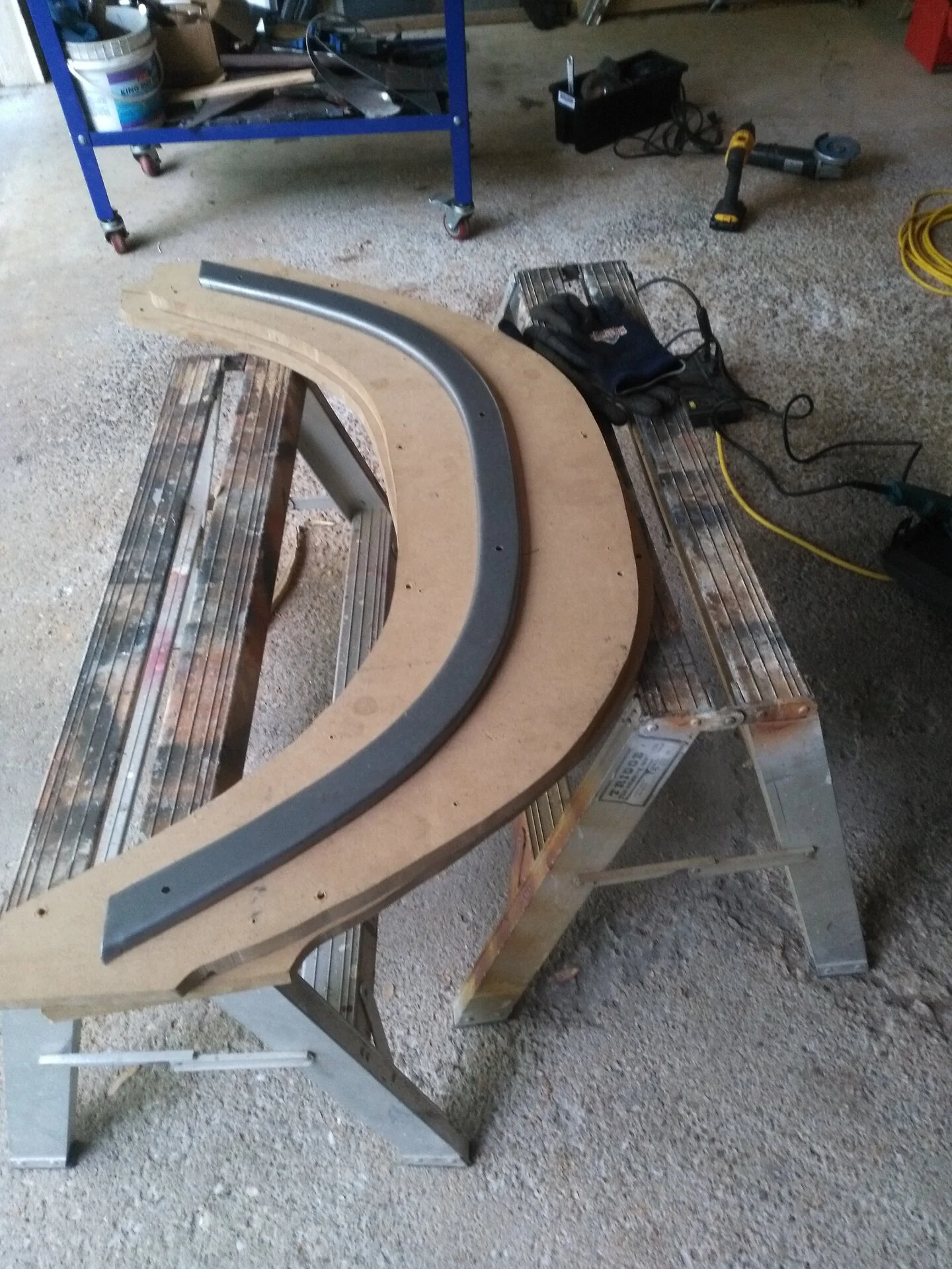

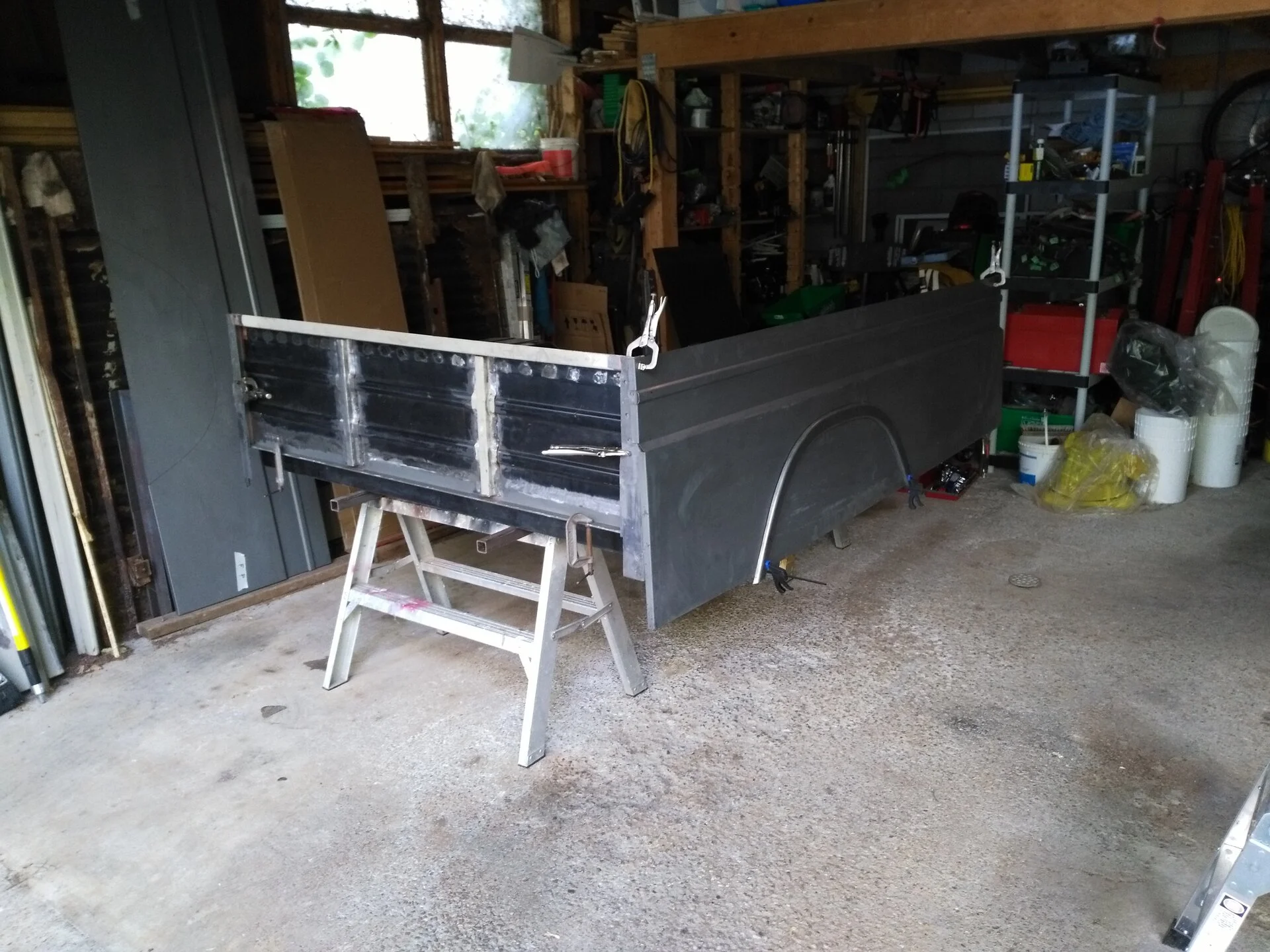

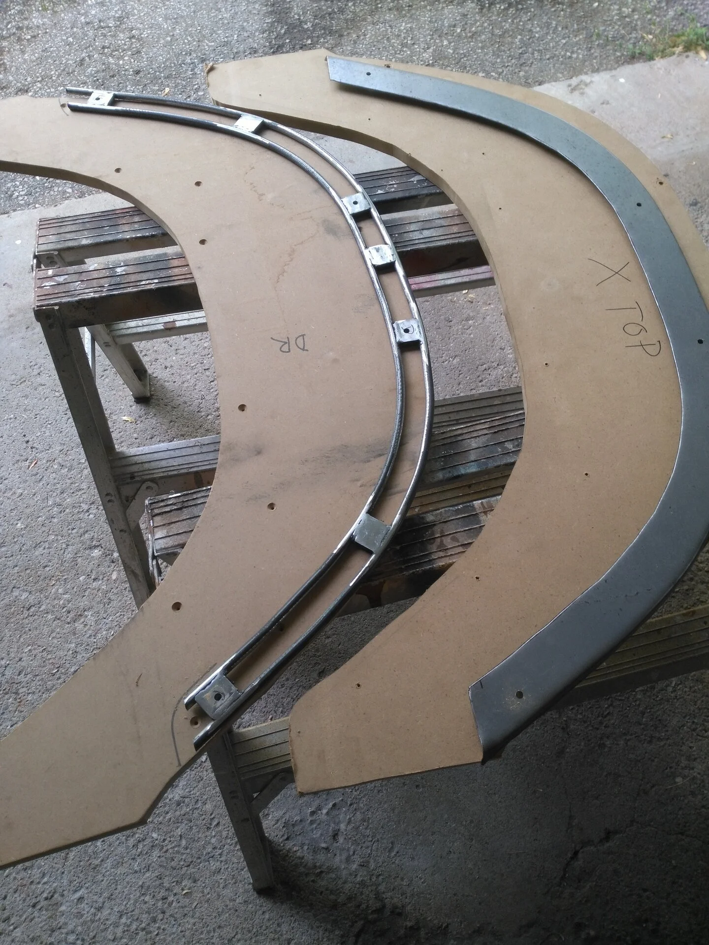

My sides were trashed by rust. I made a set of flares from a hammer form and plan on adding them to new steel I had bent up for the sides. I used 18ga for the flares and it went pretty well. They're not perfect, but close enough. Might be an option.
Wow....... very nice.....packing myself a lunch and headed up your way..... how long to complete.... have to be back for dinner...lol. Im afraid God didnt gift me with skills he gave you....... Nice work
Thanks. I am really surprised how well it went. I was in the same situation, trying to figure out how to replicate the flares, when I saw a couple of YouTube videos on hammer forming (Make it Kustom). Thought, why not give it a try. I made a simple form from 3/8" round bar and flat stock and used a ball peen hammer for the most part. Nothing fancy.
