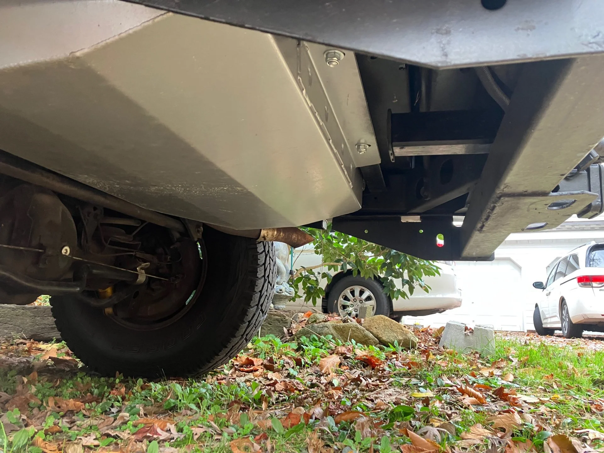

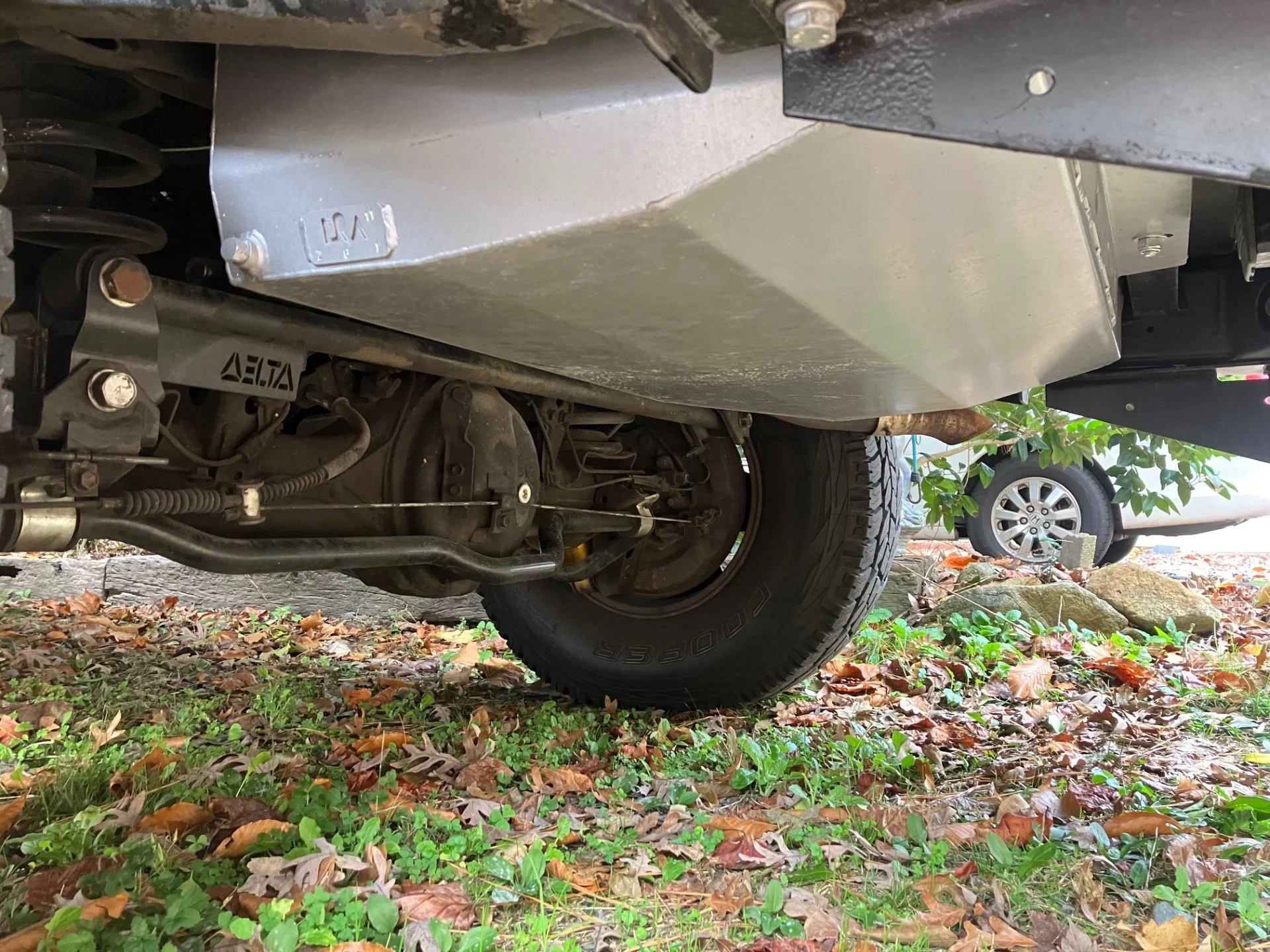

Given the interest in this subject I went out and took some pictures. And I stand corrected. The 37/40 gal main tank does hang down about three inches past the rails. The 24 aux sits about 6" above the diff (with a 3" lift). It is tapered towards the rear so that it is flush with the rails.
OTRAMM added additional armor to the rear tank for a customer who was intending to do serious rock crawling.
