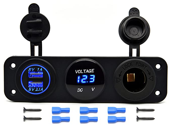

I know everyone has their own ideas but to keep it simple, I installed a constant hot cigarette lighter plug in the rear of the Cruiser. I ran either 12 or 14 gauge wire from a fuse block under the hood to the plug in the back. If you have a cigarette light plug in both trucks, swapping the fridge is really simple.
* I have an Edgestar and it came with a 12V cigarette lighter plug to 12V polarized plug.
Since I had enough power to handle the fridge and accessories, I installed a 3 position panel as well to charge phones and monitor the battery.
^I added something very similar to the back of mine but in one of the positions I put a switch.
That way while it was parked I could switch off the panel and not drain the battery.
While it's on the voltage readout and live charging ports are great.

Don't need the three position thing, although it is slick. A single Anderson connector or a cigarette lighter will do the trick fine.

I installed the same thing. Absolutely love it. The 3 ports are great when you have the truck out working on a project and can just plug the phones up. Easy install too. I love the switched power idea Sean.

Like this one? I did the same on my truck, like the ability to shut off all the power just in case, like when I was driving to VT last month and the alternators decided it liked NC better and wouldnt work. But found out the switch little light being way too bright! piece of black tape over it.....very ghetto.

How hard was that to wire up?
Pretty easy, just ran some 10Ga wire through the firewall to a fuse box that I had added on the passenger side wheel arch. If you look through my Amateur Hour thread, its all in there. Added the fuse box when I installed ham radio
