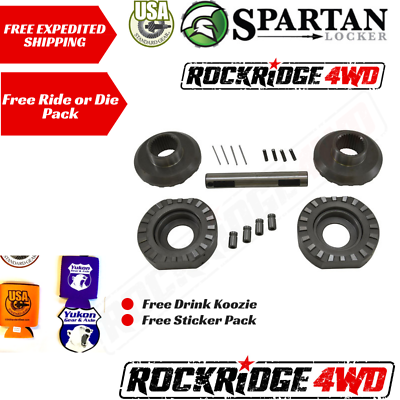

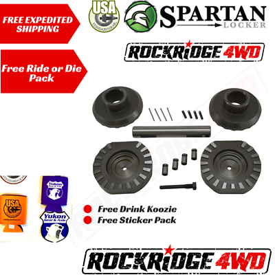

You reckon that these would be it and would work?
@FJBen I want unlocking hubs anyways just cant seem to find any that may fit the fzj70. I just don't want to order and bring it in and it wont work as that will just waste my money. But definitely if I'm going to run the locker in front I would use locking Hubs
