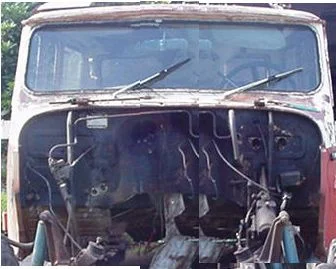

Got a few pictures... not much, but stipping it down around a few other projects.
Engine pulled.
Brake junk pulled.
other misc firewall stuff pulled.
SSS but selling a house and cleaning up another house right now.
The last picture... is a picture of it stretched.
