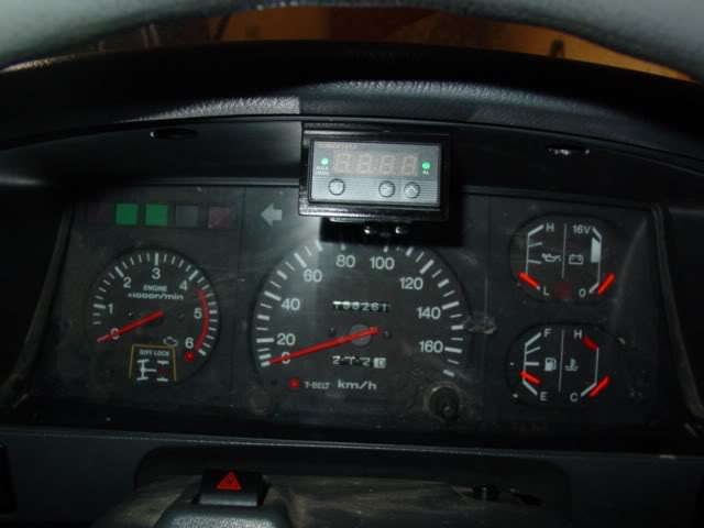

I have my EGT pyro above my speedo so I can see it in my line of sight. And when the alarm is triggered the light gets your attention.

the koso meter is nice because as you get closer to the "redline" temperature you program in, the lcd screen will slowly turn red, and then start flashing when you get to that temperature. it gets one's attention real quick without looking directly at it.
