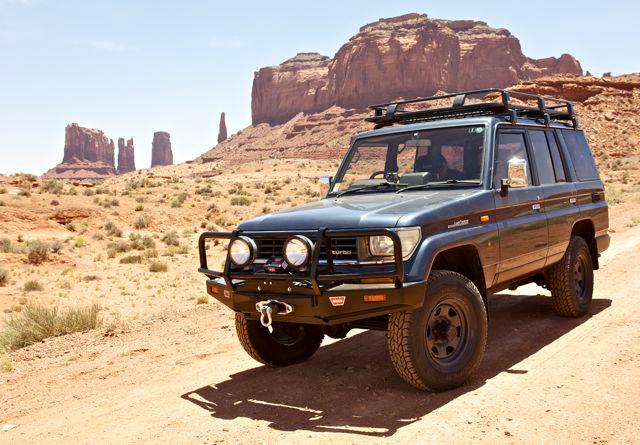

That brush bar / bumper looks very good on the LJ78.

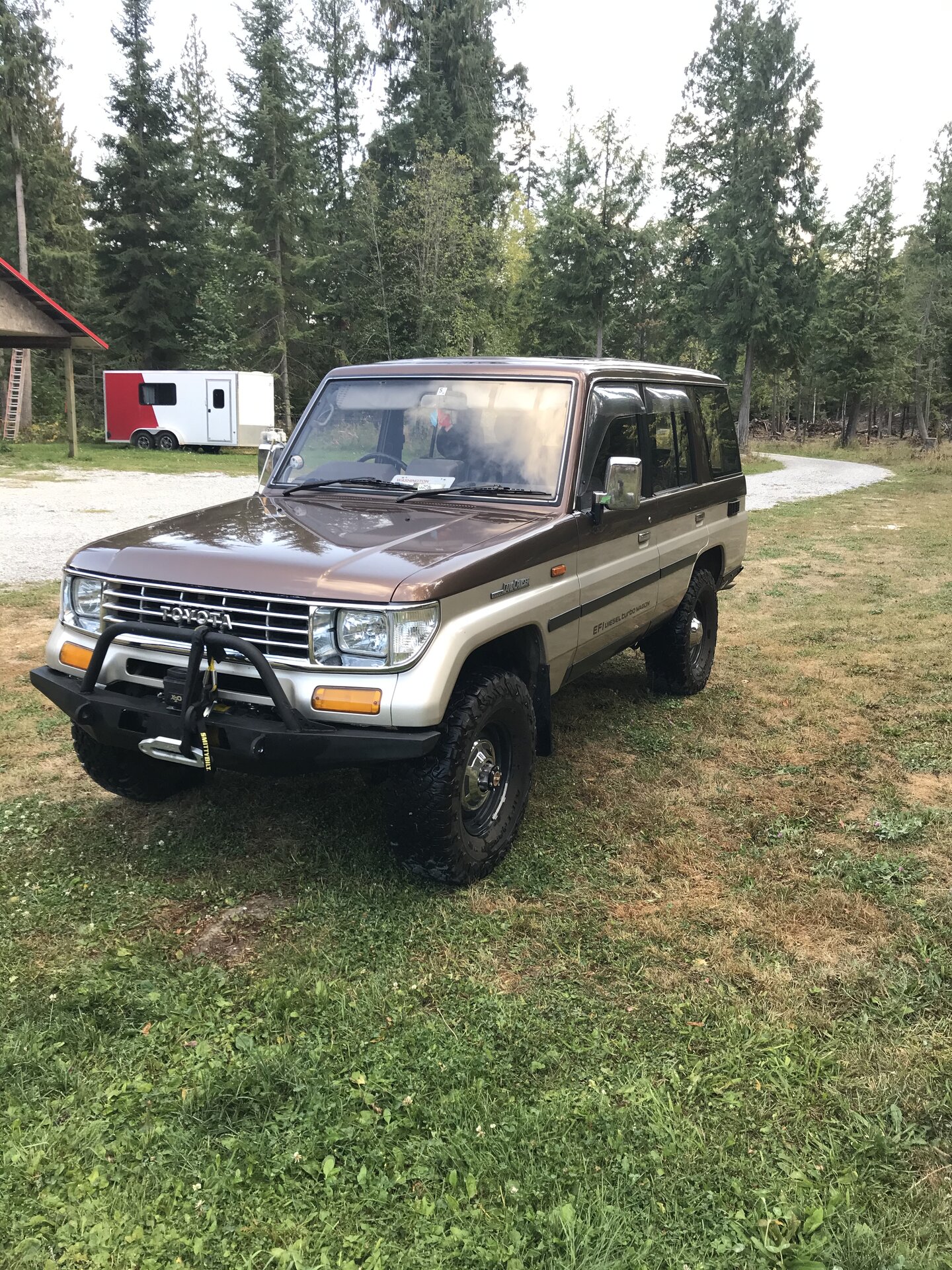

Someone in Vancouver was selling this bumper which I tried to get my hands on but was too late. It is a full aluminum bumper which would be pretty sweet for keeping the weight down.
http://images.craigslist.org/00Z0Z_kwoTFmztAVg_600x450.jpg
Great minds think alike, I tried to hop on that bar as well, but it ended up selling very quickly. It does look like a sturdy bar.

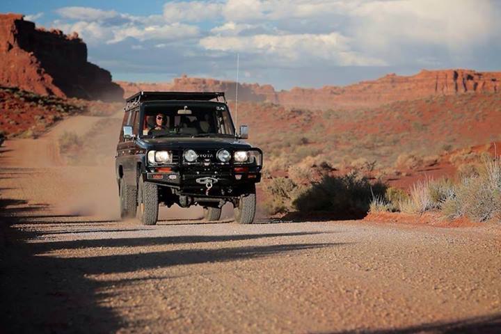

I did see the expedition portal's LJ78, I have already asked which bar they used on their facebook page, if they reply I will let you know which series it is. Worst comes to worst, I will take my chances with an 80 series bar, I'm sure with a little bit of "tweeking" it will fit right in.
Does anyone know what kind of bumper this is? I'm on the ARB site and can't find it. They all have fog light cut outs in the front bumper.
Don't know about that bumper, it's probably an ARB for a 70 series that has been modified (I think the wings/ends need to be cut). But, a Dobinsons bumper for 70 series fits an LJ78 with out mods and looks nice...
You could also look into Ironman bumpers for 70 series. I think I have seen those on LJs too
That would be the HD 70-series Deluxe ARB (narrow nose version) with trimmed side wings. That is what I have on my LJ78; it is a great bumper but needs a bit of modification to fit a Prado. Both the front and rear bumpers are not easy to find on the ARB site.
