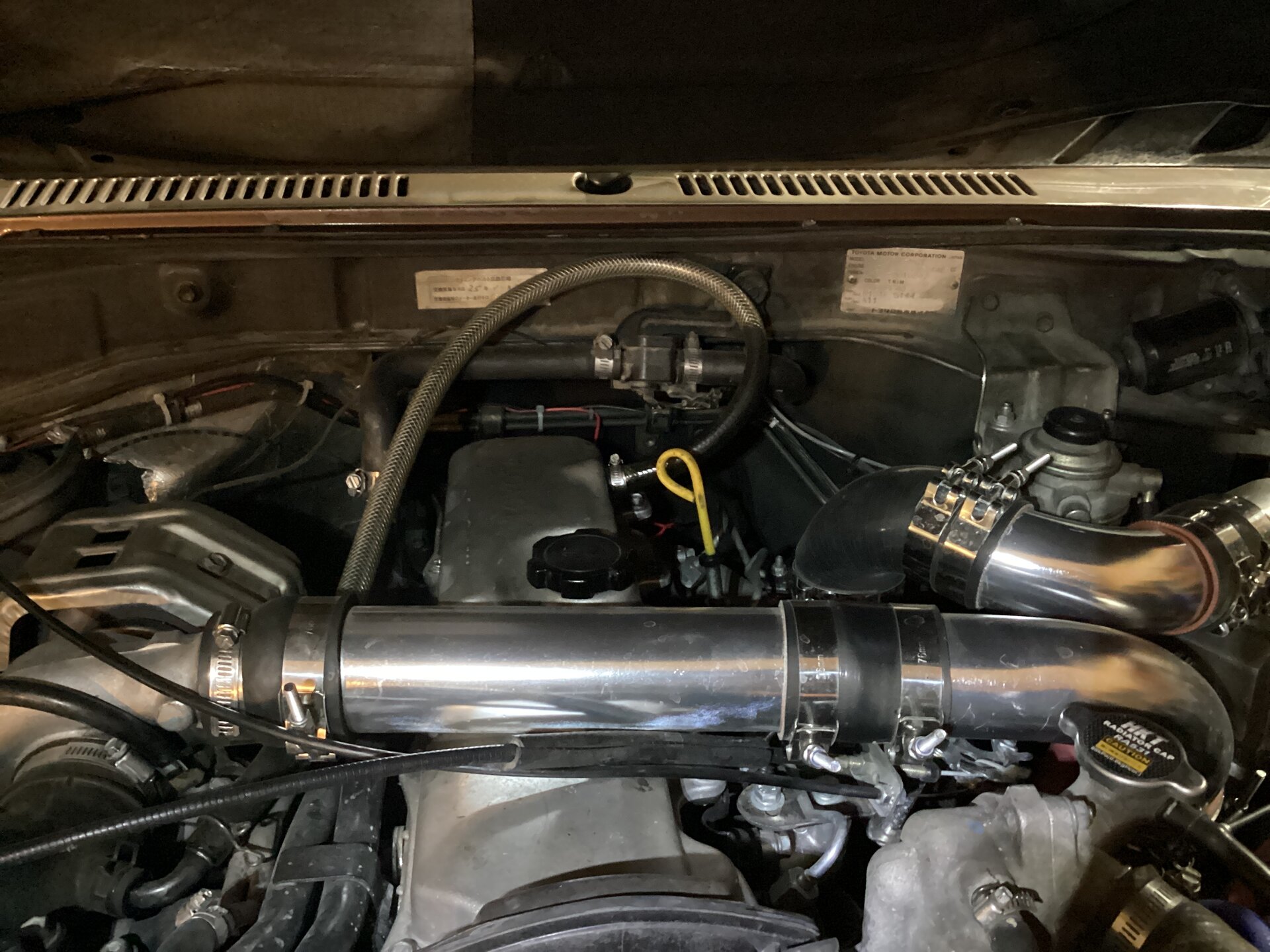

I've been venting for 10 years and no problems from what I can tell. Note the later 2L/3L valve covers are improved and blow less mist. I bought a brand new one and it seemed to improve things.
I was using a catch can but changed to this simpler method to reduce clutter. In this photo you can see the dark area in the vent hose. The oil only climbs a few inches up the hose then drains back into the valve cover. Also I installed a drain petcock on the bottom of the intercooler to drain off any oil that might collect. I checked after about 2000 Kms and so far no oil has collected.
That's really excellent. Thanks for the pictures. I really like the work you do and your contributions here. I run my breather hose up high for same reason, but maybe will also try back to intake and a intercooler drain.
This is great you guys, yes, thanks Houser for sharing the photos. I'm going to make some adjustments, as well. Putting in that high loop is brilliant. I initially just did a catch can and routed back to intake after installing intercooler, thinking I was protecting intercooler with catch can, but then noticed things were still quite oily around throttle body. Considering catch can doesn't catch all and I ran that way for a couple months, I likely have some oil in intercooler now. Drain idea is great - thanks. I'll post some photos of my air-air intercooler setup in a new thread sometime soon.
