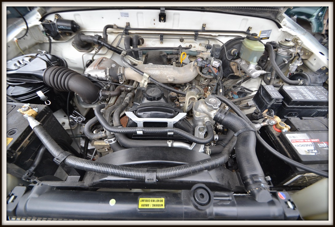

Does your engine look like this? If so, it's the last generation 2LT, and is the best:
no it's not him. I had this engine and I broke it. I put another of the same type which was not good at all. I did a turbo repair, changed the springs on the engine and now it works well but it is very slow
Ahh, OK, I see. Well, maybe it is time to move away from the old 2LT to 1KZT or 1KDFTV.
