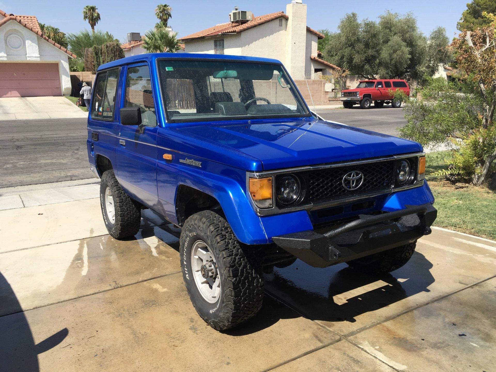

This will be a fairly original build because I have want to maintain some originality. Mostly a restoration in a way! Cleaned up front end a bit
Sprayed it myself, I think the angle makes it look better than it actually is. Yours is better because chrome is still there, my chrome was chipped so i had no choice
Did you spray that yourself or have it power coated? Looks nice.
Funny thing, I was touching mine up today. Your's turned out way better.

Cruising around today. Hoping to get a winch plate made up and mounted behind the oem bumper. Trying to maintain the stock look while having more usable items
