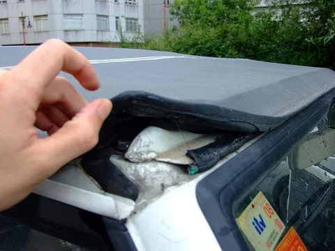

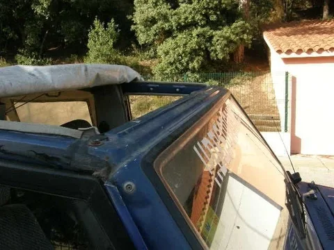

Hey mates!
I leave here two pics of the frames windshield, one of LJ-70 and one of BJ-73, the only major difference is that under windshield of LJ have an additional piece at the top which is the anchor of the rag-top :bounce: :clap:
BJ-73:
LJ-70: my toy :steer: (yes, my rag top is very old :bang:)
